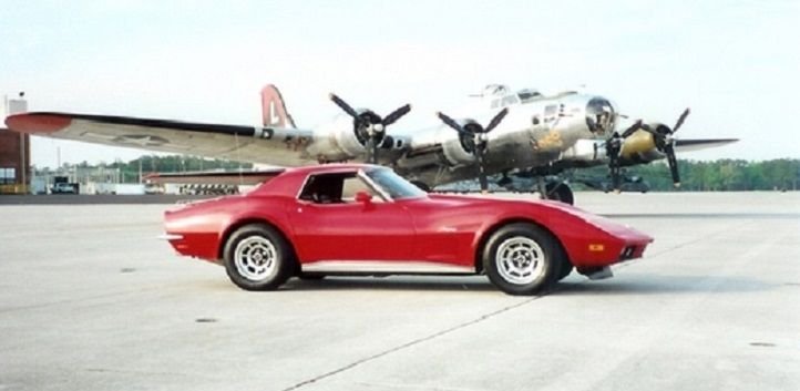

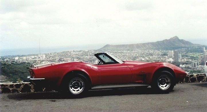

In '91 I was transferred to Hawaii from Northern Virginia. Before moving I installed a new set of Gymkhana springs in the front suspension. When the car arrived in Hawaii, I realized I had a terrible squealing sound coming from the front end when rolling over a bump, particularly so when going around a corner. I also noticed the front end seemed to be sitting a bit higher than before installing the new springs.
I put the car on a lift and realized I had installed the springs without properly seating them and they were both cocked in their spring pockets and rubbing the suspension as it moved up and down. I spent about 30 minutes on each side releasing the suspension and re-seating the springs correctly. Not only did the noise go away, but the car sat about an inch lower than stock as I had expected it should. The pictures below illustrate the front spring problem before and after correcting the situation.
before...
after...

awesome car..great before after
