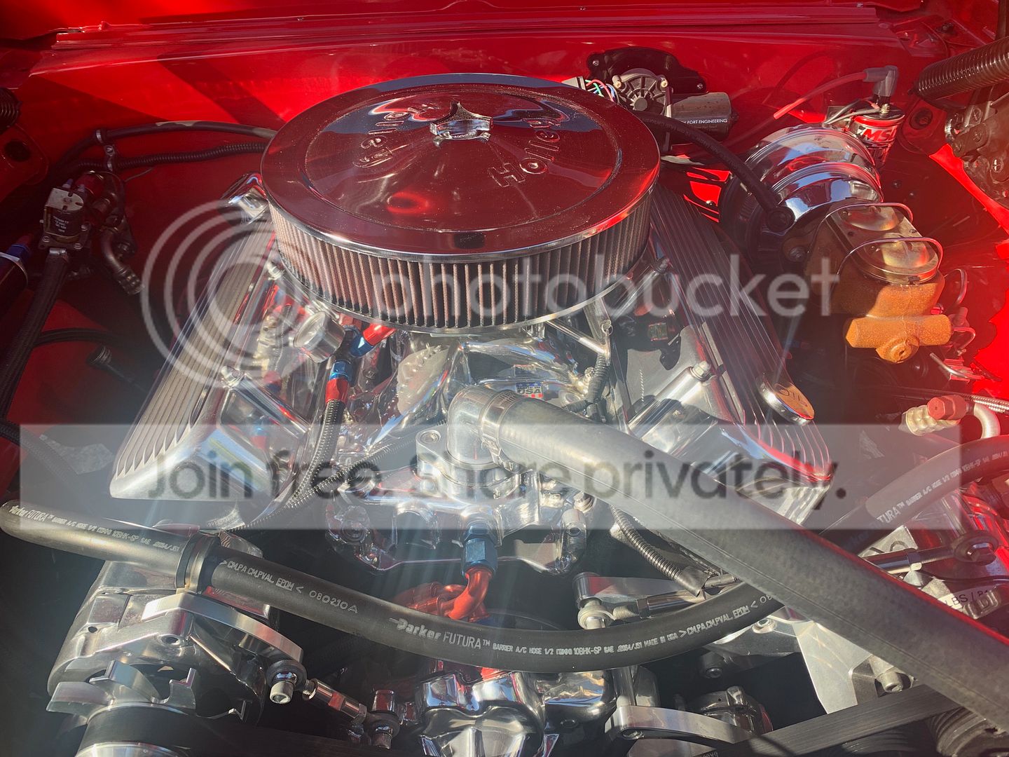

IMG]https://i3[0.photobucket.com/albums/c338/panicinpleasantville/IMG_2455_zpsbq5boykf.jpg

looks like an oval intake and stock GM iron heads. yes, you can get 500 out of GM iron ovals. but it takes a metric s#!t ton of porting. they could be truck peanuts. could be L29's. we need to see what you have for head casting numbers. and as i said earlier. valve lift will tell a lot about the cam. No Va. in spanish and italian means doesn't go...

You might want more heads and cam to get closer to 600HP. Those look like stock iron oval ports. Aluminum AFRs could net you 60-80HP in a head swap alone! BBs need to breathe.

Do you have any specs for the engine? Have you checked timing? Post some pics of the block and cylinder head casting......
