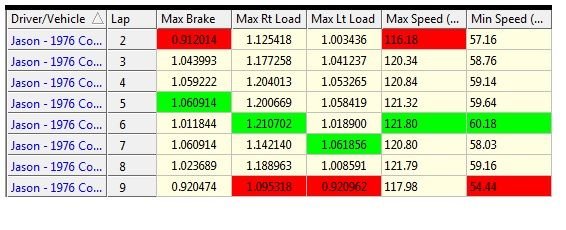

I have a heavily modified stock configuration brake system (stock size rotors & calipers) with cooling ducts, and can just about throw you thru the windshield repeatably on high performance tires without locking up the tires. I've lightened my system with alot of aluminum parts and cool it better than stock, but a factory system is very good for panic stocks on the street.
Here is an example of what I mean. Data taken from a track event showing I'm pulling over 1G while braking lap after lap (see first column). I was pulling so hard on my factory seat belts I fatigued the re-tracker and broke the seat belt mechanism so the belts wouldn't tighten up or retract anymore - had to send them in for a rebuild. After that I quit using the factory seat belts on the track and switched to a harness. The factory configuration when in good working order is pretty darn great - you don't have to totally swap out brakes, just get yours working like they should and you'll probably be amazed.

Jason: How are you collecting this data? Max brake g's could be illusory as stopping distance is what really matters. Hitting a high instantaneous longitudinal number is OK, but not enough for me. I have similar numbers from Harry's Lap timer for my Wilwoods but I'd like a little more insight.
I've been fooling around with some electronics to calculate stopping distance from say 70 to 0, just to compare with published numbers on other cars. Does your on board computer do anything like that?
Regretfully I haven't taken a 70-0 stopping distance measurement like during a panic stop because all my data is recorded from open track day events. I record it on a Traqmate data system. I plotted some data in a couple of the turns just to share some info.
Someday, I would love to do a 70-0 test comparing modern high performance 17"+ tires and say some BFG's just to see the difference, but I don't have any BFG's anymore. Do like 10 stops each and see how they compare initially and how fast they fade upon repeated stops.
Here is some data from ~120 to 80 mph. Over Segment 2, the average brake deceleration rate ranged from .83-.91 G's over a 2 second time period compared to pk G's of 1.01-1.06 in the same turn. Due to the elevated speed the distance traveled was about 318 feet.
Here is data from ~90-70 mph. Over Segment 4 the average brake deceleration rate ranged from .87-.95 G's over a 1 second time period compared to pk G's of 1.03-1.09 in the same turn. Distance traveled was about 136 feet.

Thanks for taking the time to post this Jason, appreciate it. Your deceleration numbers look really good for our brakes. I would guess you are right on the edge to hold those numbers at those speeds.
I calculate stopping from 70 MPH to zero is about 160 ft if you can maintain 1G. That is just kinematics. The benchmark for the average supercar, including C7's, seems to be about 135 ft.
I did a lot of work on my brakes but it is still essentially GM tech from the 60's with better pads and calipers. I have a plan and some cheap electronics to boot, nothing fancy but it's been a low priority. And the other issue is where to do this. Needs to be somewhere straight flat and safe and with some reasonably sticky tires. And where I won't get arrested.
Not expecting to get anywhere near these cars but I would hope to be considerably better than the road test reports on C3's from their introduction in the 60's and 70's.
