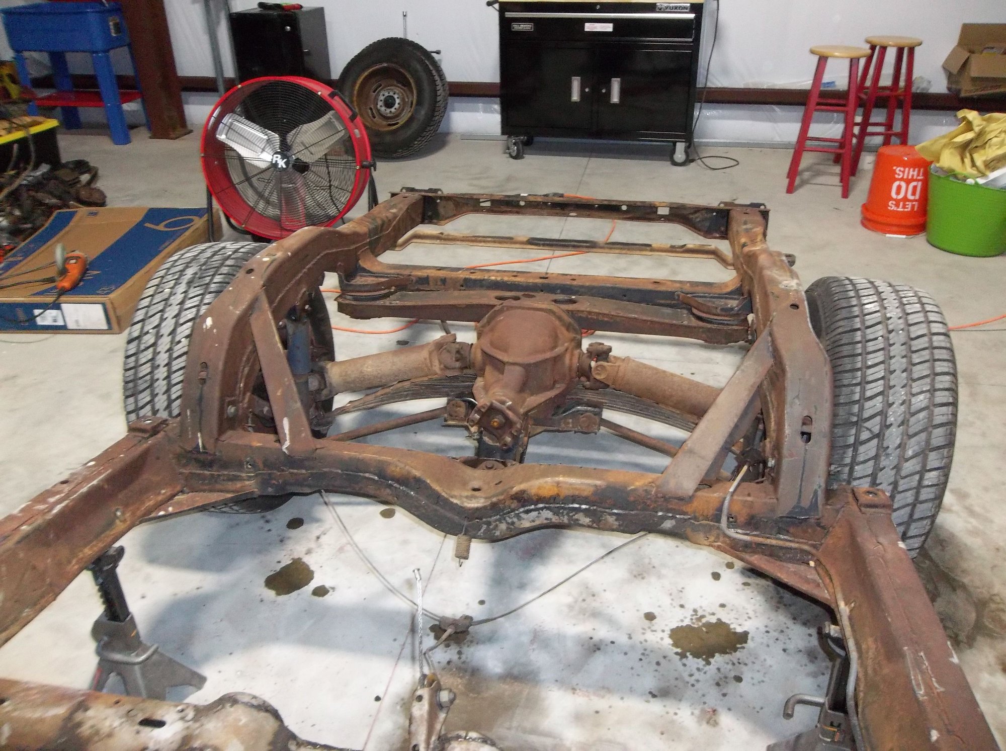

Now we have started on the 77. I want to get the frame soda blasted and ready for paint. The body is off (minimal rust) and on a body dolly (instructions from this forum-awesome). The engine is out and at the machine shop that did the work on my 77 Ford to get freshened up. We have removed the suspension from the front and the differential remains. I have been digging through all of the posts on this forum and I have to say that all of you who take the time to answer questions and pass on your experience are NUMBER ONE in my book.
So here is my first question for this forum. Can I remove all the connecting bolts and brake lines from the rear suspension and lift the frame off of it and then tackle the differential separately? Thanks to all of you who take the time to read and respond to this post.

All that is left to come off
So can I unbolt it as a complete unit?
The short answer is yes, this can be done.
In no particular order:
Remove the front pivot bolt on each trailing arm.
(I had to cut mine out with a Sawzall.)
Remove the upper shock bolts.
Disconnect the differential snubber bracket.
Disconnect the brake hard lines.
Disconnect parking brake cables.
Remove the outboard bolts on the differential crossmember, OR remove the inboard bolts that secure the differential to the crossmember.

Thank you Wendellp601 - Will tackle that this afternoon - I do know that the trailing arm bolts move so maybe sawzall wont be necessary

take the diff out and leave the crossmember in. then fight the crossmember out when it has no 100 lb weight hanging from it. that crossmember never comes out easy. https://www.corvetteforum.com/forums...er-advice.html

Just what we did this afternoon. Diff is rolled out and penetrating oil is working on the cross member. Thanks for the advice.
I did mine with the body still on the frame, so my crossmember had to come out. A few shots of PB Blaster and a pry bar worked for me.

Diff crossmember popped right off with the two jaw puller - Frame is ready to go to the blaster

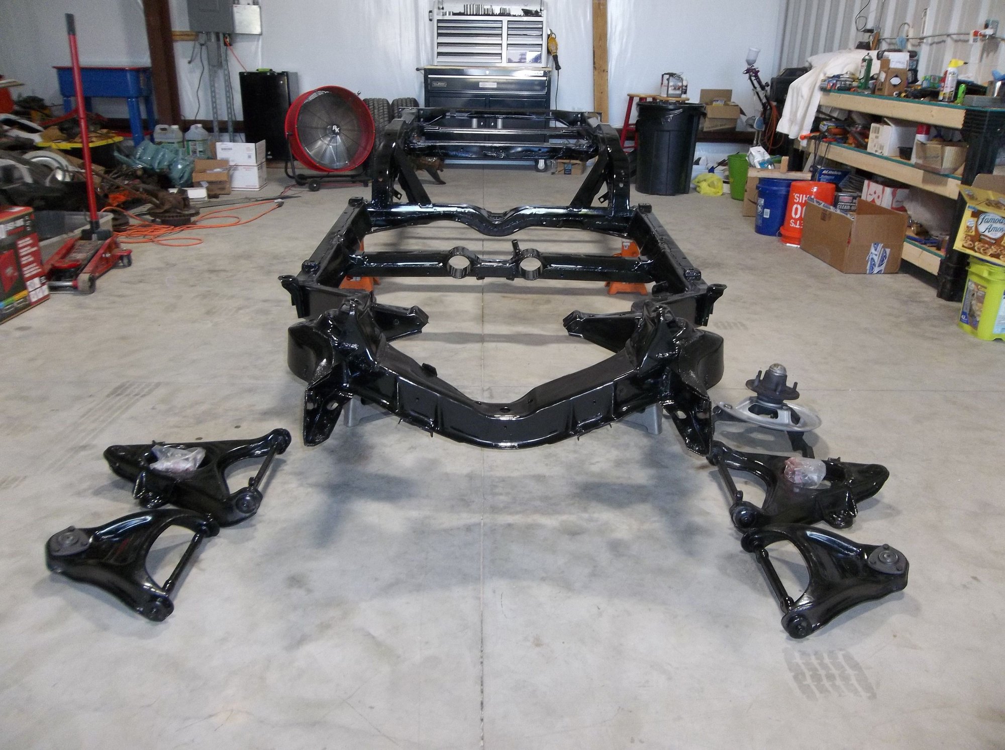

Default Finally back to the project
Frame is painted and we are ready to start hanging parts back on it.

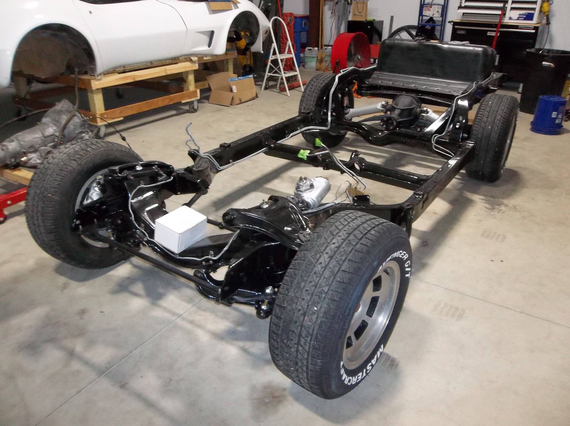

Default Progress at a snails pace
Back on 4 wheels - O-ring rebuilds on calipers - new bearings and bushings and brake lines - gas tank cleaned and painted - steering gear box, proportioning valve and power steering valve rebuilt - transmission rebuilt - waiting on the engine - slow progress but progress still!
