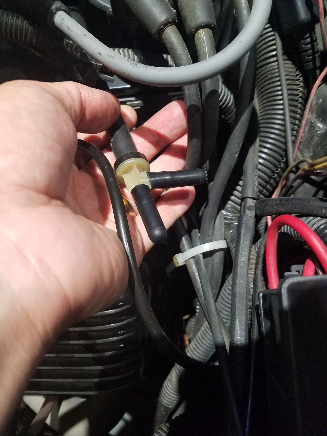

Engine has a slight stumble under a light load. I took it out today to run some tests on a road with a long, slight incline. I wanted to test the vacuum system as it just felt like it was running lean, and filling the tank up today lead to HORRIBLE gas mileage calculation - approx 7mpg. Most of my driving is short bursts and low speeds and I typically average 10-12 mpg. Headlights function normally.
On my test runs, I kept the engine at 30mph and right around 1800 rpm, in third gear. On my first test, I called both the vacuum lines that T off from the manifold. That test seemed to run the best with the least amount of stumbling. Still there, but not as pronounced. When I connected either one of the lines, stumble came back like before.
Capping both lines here gave best results, but did not eliminate the st7mble under light load. Check valve is fed by fitting on intake manifold and goes to reservoir (bottom) and headlight switch (right).
At home, hooked my Mityvac to all the vacuum lines I could think of. Results:
Brake Booster: Held vacuum
EGR: Held vacuum
HVAC: Held vacuum, although might have a very small leak. Possibly just where I connected, but not certain.
Light switch: Held vacuum and dump valve functions properly
Hose to Reservoir: Arm wore out before I could get a reading on the Mityvac, but heard sound of air rushing in when I disconnected the tool.
I built a smoke generator today, again thinking I had a vacuum leak. Hooking up to each of the hoses did not show any obvious leaks.
Car idles fine, and runs great under throttle, just this light load, partial throttle issue. ECM not throwing any codes.
I would greatly appreciate any feedback on where I should be looking next.
