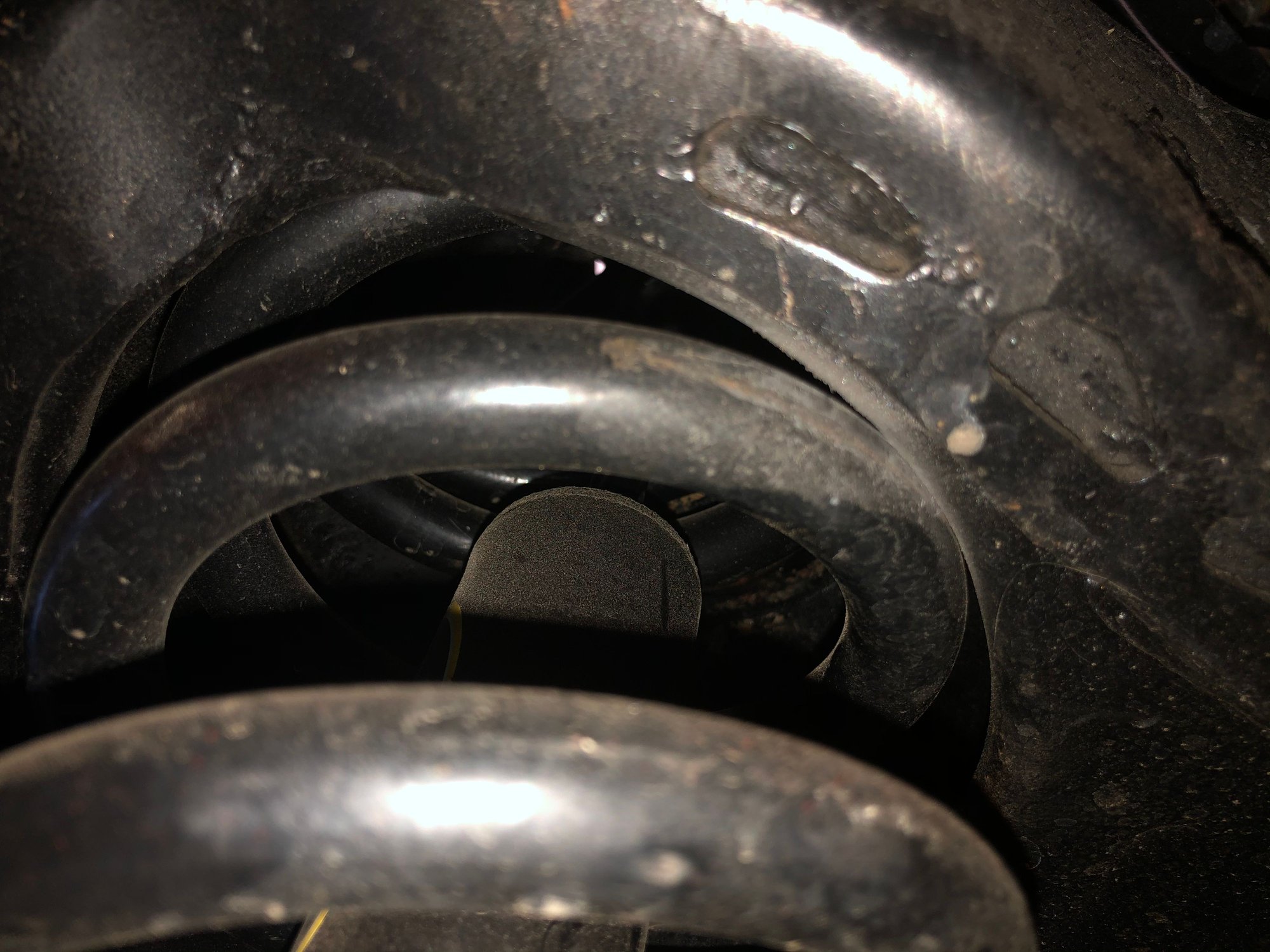

Hi All, I have a couple questions. I did a full suspension replacement all the way around using all the manufacturers specs. Now I notice the car leans to the drivers side. I did frame to ground measurements and FL - 7 inches, FR-8 inches, RR - 7 1/2 inches, RL - 6 3/4 inches. The front right gap between the fender and tire are very noticeable but the rear not so much. What can cause this? The only thing I suspect is the front right spring might not be seated correctly as it makes a squeak every time I go over a speed bump. But that’s all. Could that be it?

There was just a thread where the owner had a squeak coming from front after doing a number of front end changes including springs. The problem was the spring was not correctly clocked/seated.

I just did further inspection and the top of the spring isn’t seated at all! It looks like the spring curved.

Seat the spring in the frame pocket to within 3/8" of the inspection hole. I put blue painters tape on the spring so it can be seen from the top. You could also drop a bolt in the inspection hole and have the spring edge rest on it. When the spring is seated and secure, remove the bolt. Jerry

Ah ha!!! I fixed it! I was able to use a spring compressor, a 2x4, 5lb hammer, and a lot of swear words! Actually, I gave up and put it all back together to take it to a shop and as soon as I dropped the jack, POW!!!! It fell into place and seated itself. Now it’s about 1/2 an inch higher than the left side but it’s level on the rear part of the frame. Thanks for the ideas and help!
