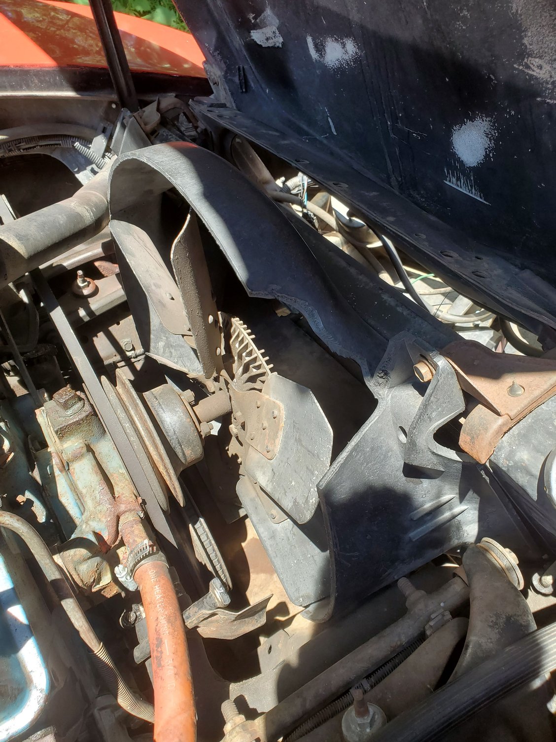

I put in a 160° thermostat. The shroud has a chunk missing out of it but I wouldn't imagine it would have such a big heating problem because of it.

It could. The fan is supposed to pull air through the radiator and if theres a hole like that it will pull from the easiest path which is to that side

Is it missing the seals around the top of the radiator? Sure is a big gap there.
If so, all that air is going over the radiator and not through it.
