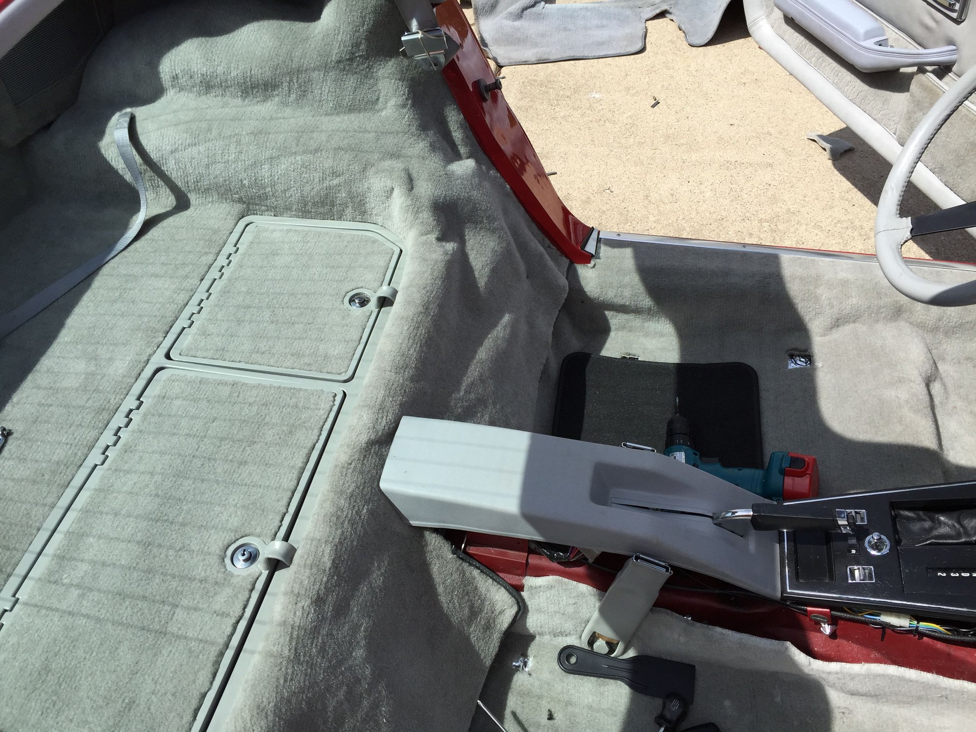

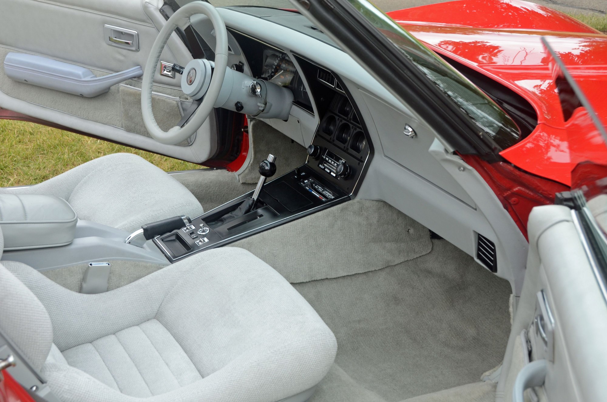

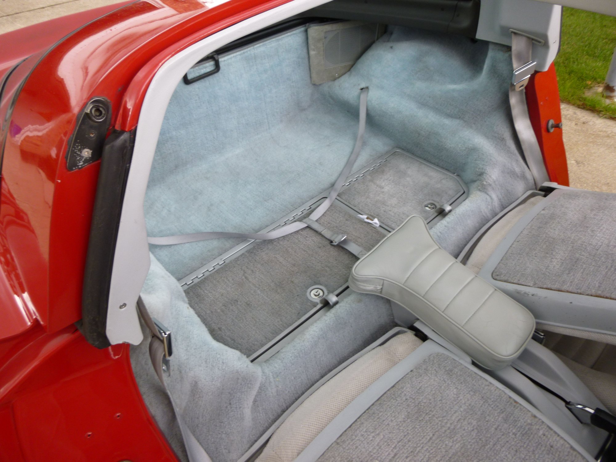

Originally Posted by dpoliti9
Unfortunately the carpet was gone when I got the car so I nothing to fall back on but I think I've got the idea.
Thanks, Dale
This will give you an idea of what yours would probably have looked like before, and how it should look right after you install it and before you nip & tuck everything in a bit.
Hope that maybe it helps, somehow. Good luck -
