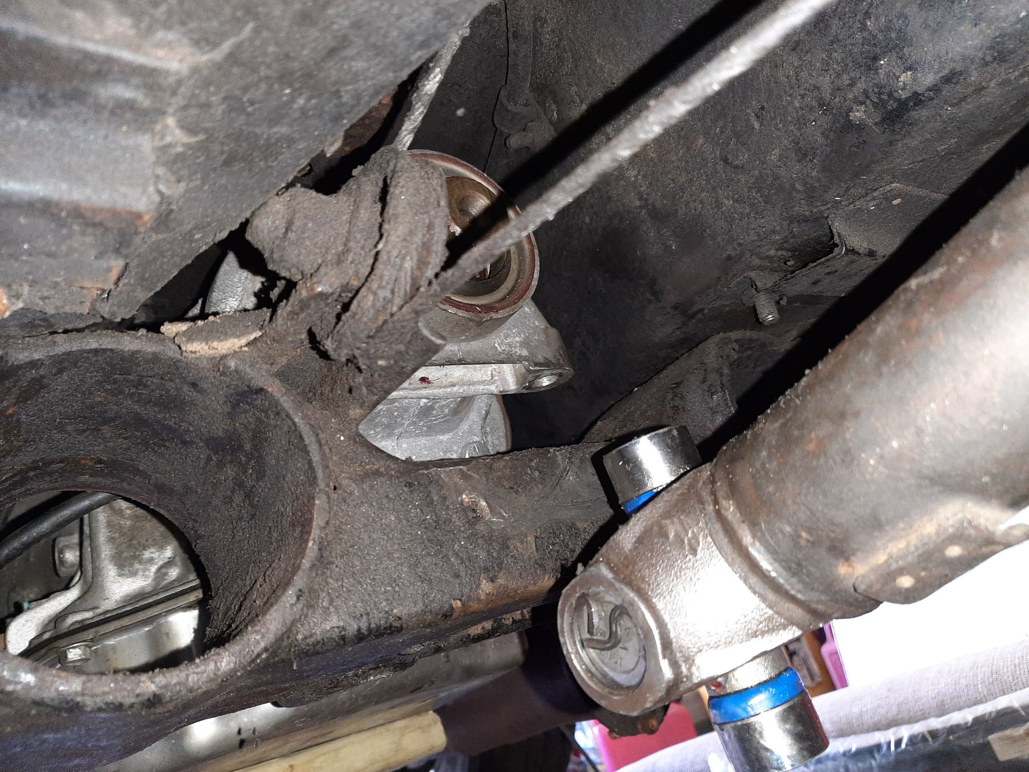

I appreciate the convo guys. I swapped SB to BB springs and have the rear sway bar as well. Any idea on the trans mount? I have heard I dont need to use the trans mount brackets, just the mount to the crossmember?

auto or manual? The manual uses the brackets. The auto has a removable frame crossmember the mount bolts to.

If doing engine swap only, leave trans mounts be. SB and BB sit on same mounts and put bell housing flange in the same place. So trans is in the same place.

I swapped engine/trans 350/350 combo over to 427/400 combo. All I want to know is if the trans mount just sits on top of the crossmember? I don't need those brackets anymore right?

looks like 400 trans mount is 6 inches back from 350-manual mount. driveshaft spline and length also different. this article is for chevelles, but discusses the trans lengths in detail. http://www.superchevy.com/how-to/609...-swapping-tech
