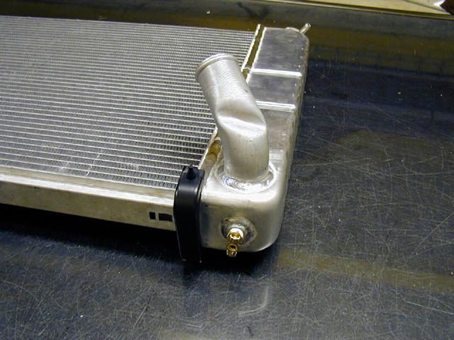

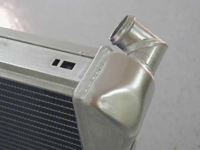

Old Jul 18, 2020 | 02:00 PM
Tom@Dewitt's Avatar
0Tom@Dewitt
Former Vendor
Joined: Jan 2000
Posts: 5,593
Likes: 631
From: Brighton
Sometimes mistaken for damage, this dent provides stabilizer bar clearance if necessary.
Depending on the amount of hood shims and body fit-up, this flat spot comes in real handy
