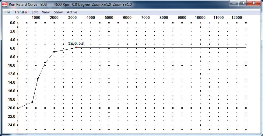

This is what I use on my 78 ZZ383 & holley avenger 770.
http://www.zeitronix.com/ .
I don't have a gauge mounted and only use the output to my laptop. Records real time data, also mapped with my RPM , Map sensor, so I can also set timing using a programable MSD 6530 controller.
