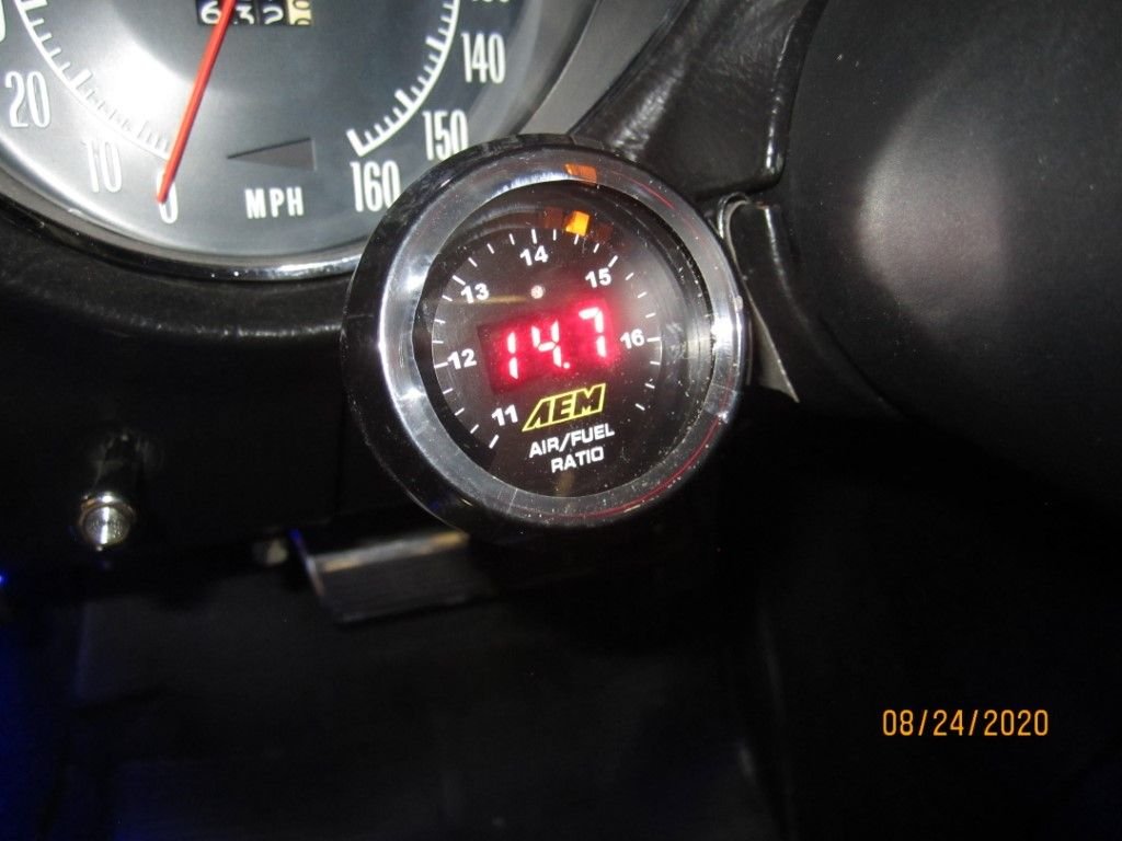

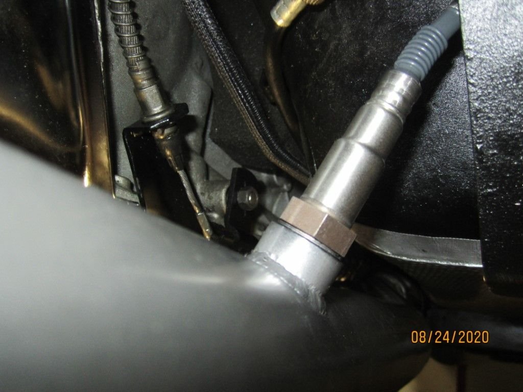

Old Aug 24, 2020 | 06:08 PM
Mooser's Avatar
Mooser
Joined: Apr 2011
Posts: 11,183
Likes: 3,335
Finally installed (gauge just temporary location for now) and at least turns on and reads...
Need to tuck up the extra 20 feet or so of cable somewhere and go for a little drive to see something what kind of readings it comes up with
M
