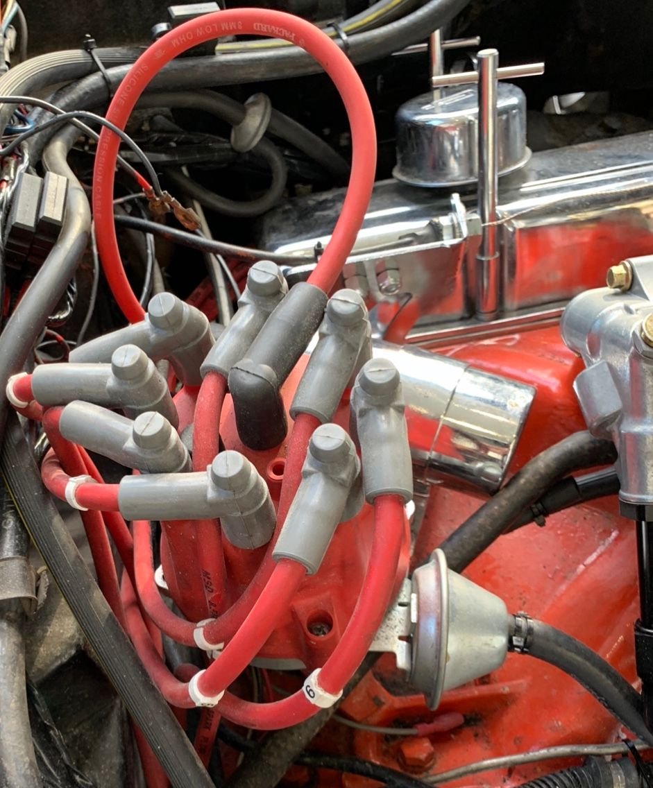

I was documenting the wiring at the distributor since I am going to install a new rotor and cap and I noticed that prior to the heads and intake install, plug #6 was at the 12 o’clock position towards the front. The later pics show plug #8 being in that position. Now if the order of the wires is correct ( 1,8,4,3,6,5,7,2). Does it matter that the position of the cap has changed? should I rotate it so plug #6 is back at the 12 o’clock spot?

Yes.....you are one wire off timing, or 45 degrees.......
Observations here: Get some real 3/32 vacuum line and mount the coil vertically........sideways mounted coils can get hot.

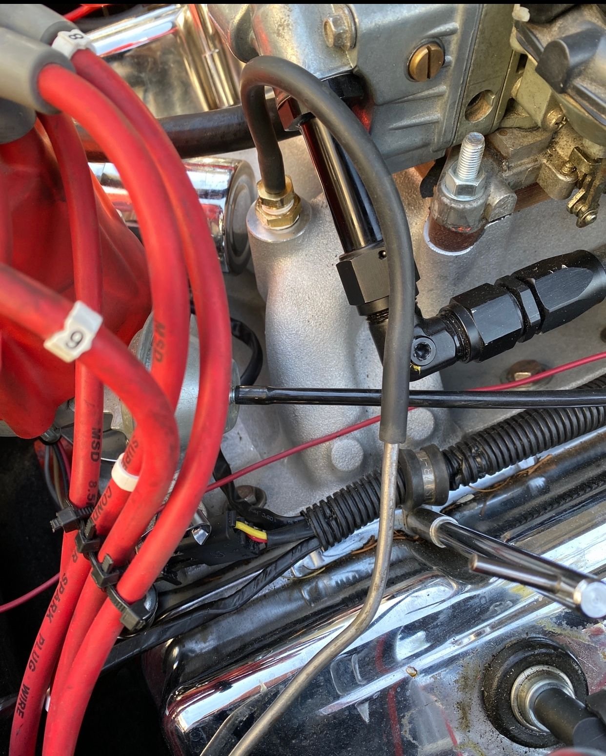

So I should rotate the cap so plug wire #6 is back at the 12 o’clock position? I will mount the coil vertically today as well. The vacuum line was replaced with this one.

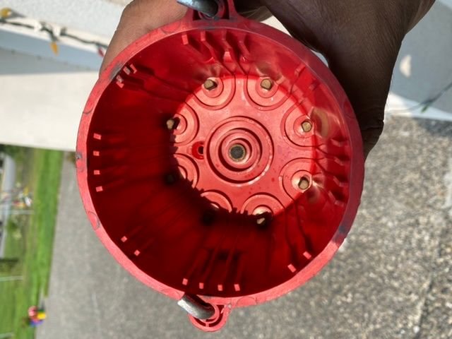

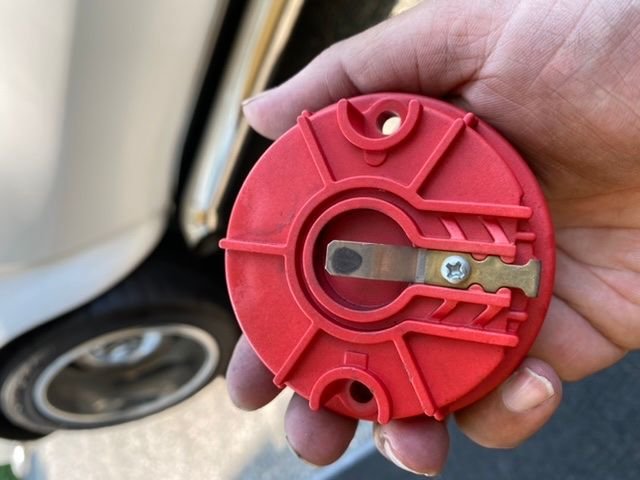

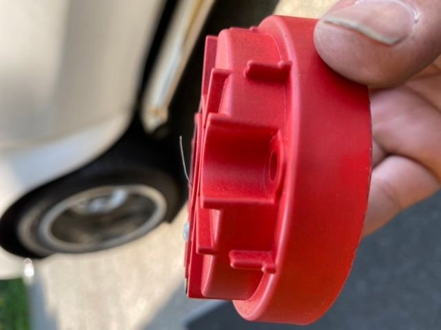

I was cleaning up the engine bay and decided to look under the distributor cap, there was a fair bit of carbon buildup. The tang on the rotor was almost non existent, I measured it using the guide that came with the new one just to compare and the old one wasn’t even in the range at all.
I’m guessing having the wrong plugs and the tang so far out is part of the reason it isn’t running properly.
