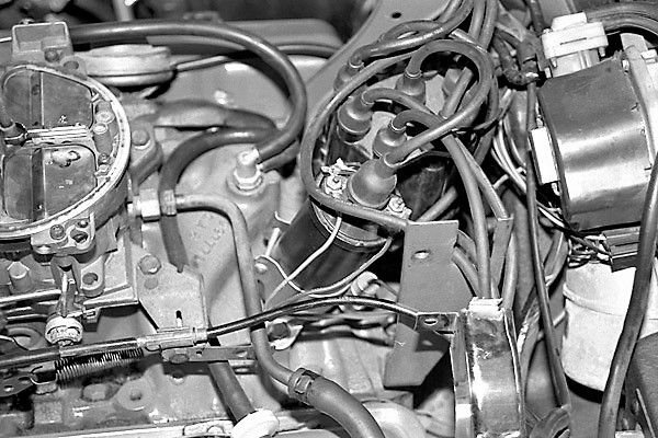

Hello All,
I've searched for hours trying to find out the correct way to mount the Radio Noise Capacitor to the coil bracket on my 1969 350/350. I can't find any pictures out on the web that shows such a simple thing. The AIM makes it appear that the small phillips-head screw comes from inside the bracket where the coil mounts which seems wrong since you can't even get a screwdriver in there to screw it in. I would appreciate seeing or hearing how it's supposed to be mounted, because what looks nice and easy isn't what the assembly manual shows. This is probably a bit much, but like my father-in-law says, "You never have time to do it right, but you always have time to do it again." I'm just trying to do it right from the get-go.
Thanks in advance.
- Tom

On the coil mounting bracket a tab is bent slightly out that is where the screw threads in to hold the capacitor.
