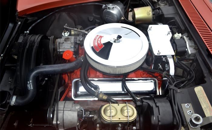

Originally Posted by wolfrider06
The overflow bottle isn't the same as an expansion tank then? I understand the advantage of using an enclosed system, my '04 Chevy Silverado uses one, as do most modern vehicles. The radiator in my C3 is original and has a "fill to this line" stamped into the body on the left side. I suppose adding an overflow bottle wouldn't hurt and since the car is not OEM anyway with the replacement engine, it wouldn't devalue the car. I'm wondering why there would be a side nozzle on the filler neck designed to vent any over-expansion of coolant.
Yes different...and technically what I installed is a non-pressurized overflow bottle. Here is a picture of a 1968 expansion tank at the top which I believe is pressurized (not my car). Our NCRS experts can verify that is the way the early C3's might have originally come from the factory.
