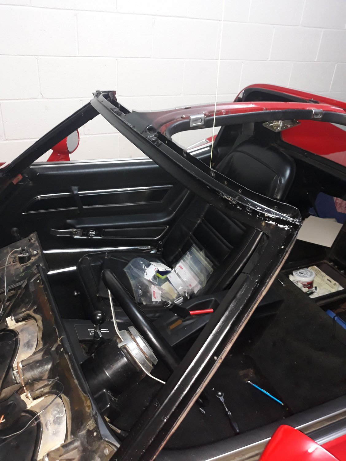

Had my windshield out recently, on my 77. First time it was ever out in the life of the car.

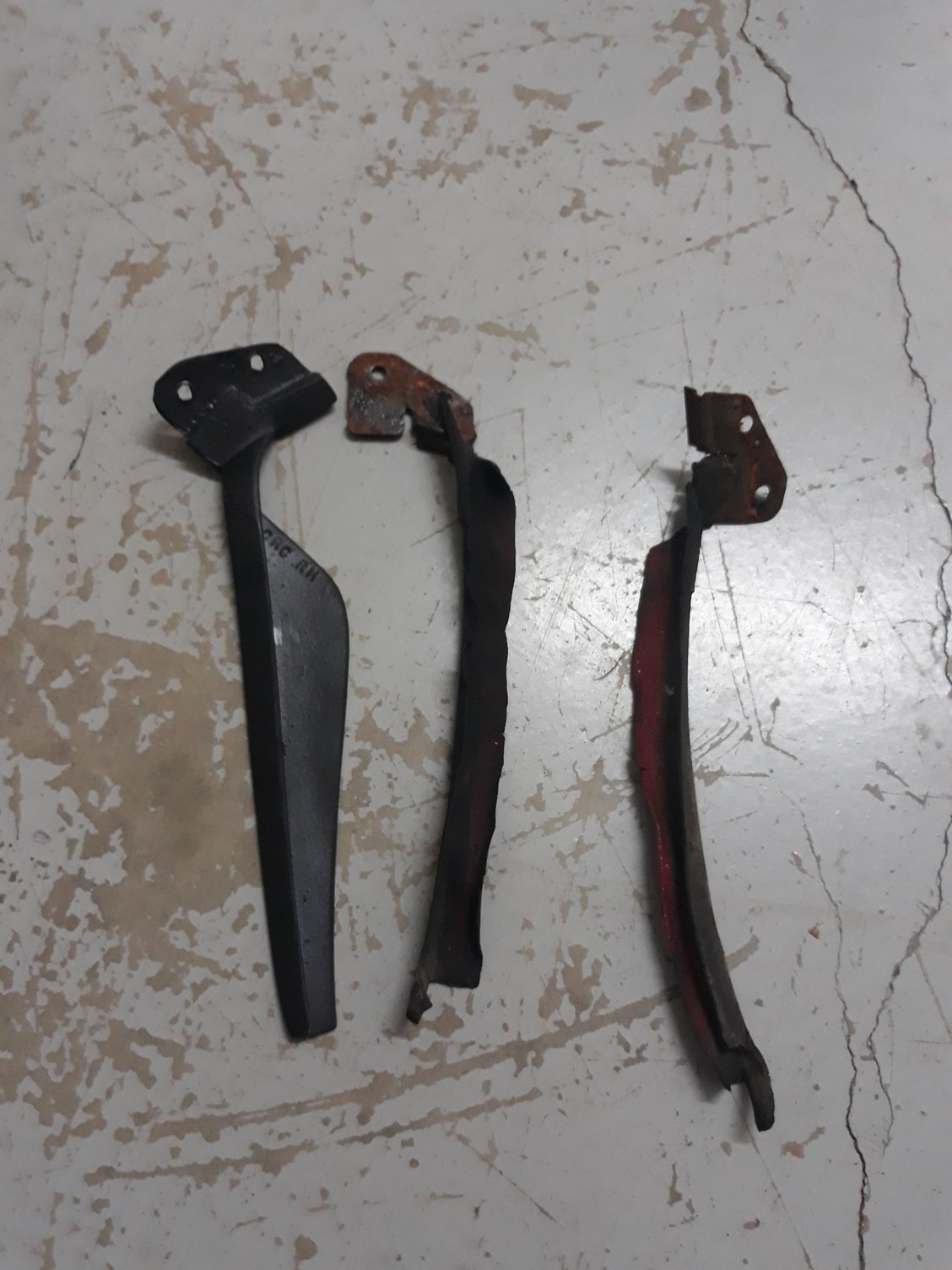

those weatherstrip/weather shields at the bottom outside corners of the windshield. Mine were like toast. Get some on order.
These things, my 2 old ones next to a new one.
Also.
A piller weatherstrips. You will almost certainly need to replace them to get the windshield side reveal mouldings off.
also, between the A piller weatherstrip holders and the side windshield reveal is a foam adhesive strip, I got mine from ZIP. Also 3M Strip-caulk will be needed to reseal the chrome T panel on your roof while your in there.
sanding down and repainting the windshield frame should be a given. I found rust I didn't know I had.
This was a surprise.
After some welding and repainting.

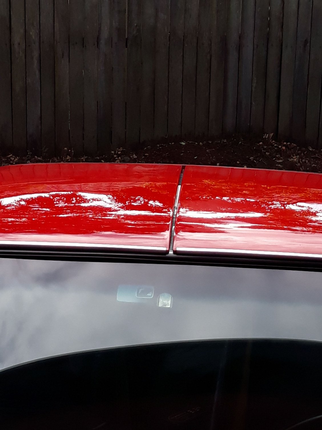

Notice how my stainless T section is off. And those corner sections as mentioned above. Took my corner sections to a pot metal chrome specialist. Had them repaired and re-chromed for half the price of new ones. Resealed the roof. Re weatherstriped my T tops and spent hours getting them aligned perfectly .
while your in there!
sorry if I forgot something. I live in Australia, when I did mine I got hung up over a couple parts I listed above.
