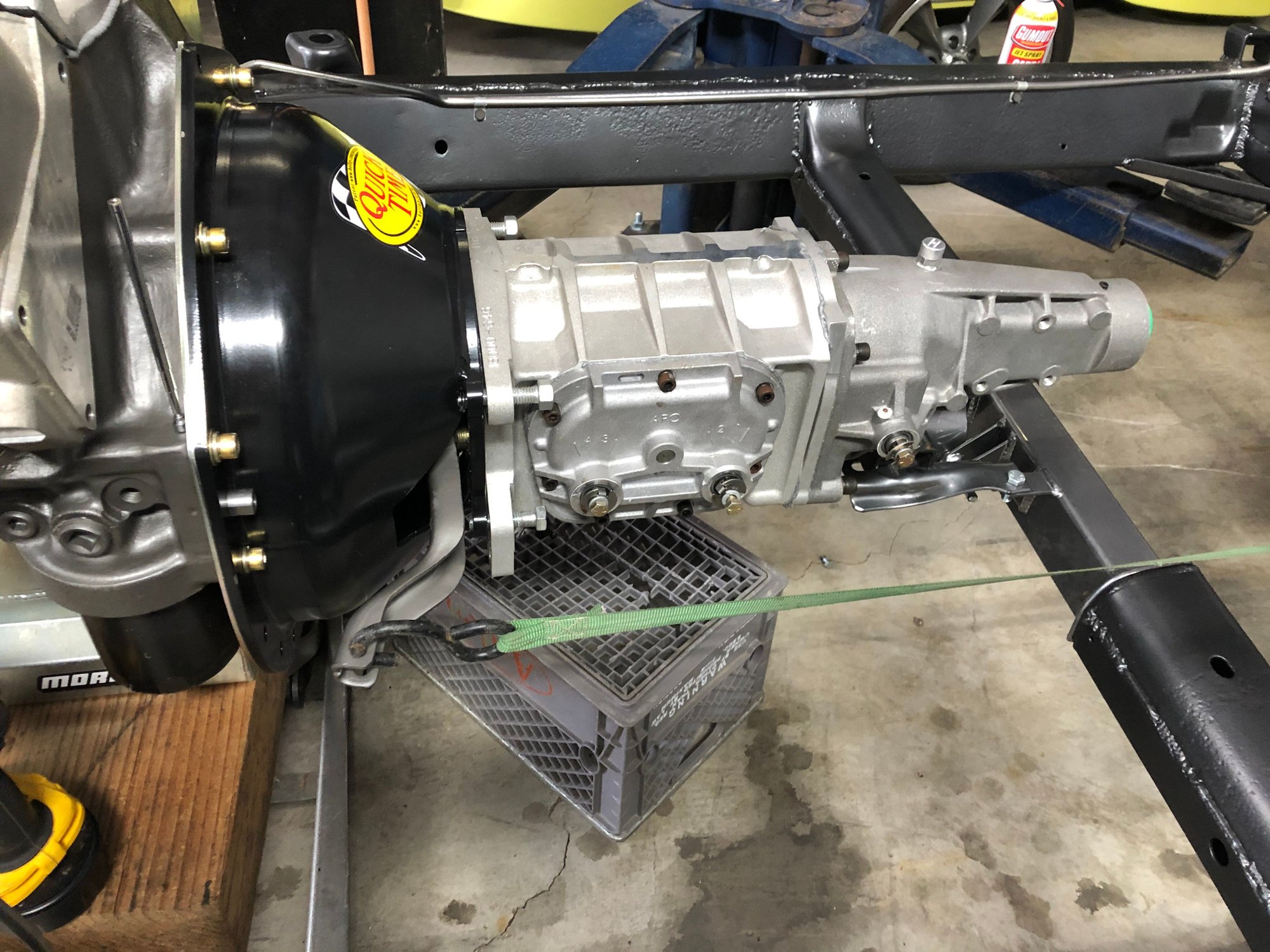

N24Z trans 336 gear
28" tall tire 600-800hp Perfect in town or Hwy
Not my ride but I dig it
