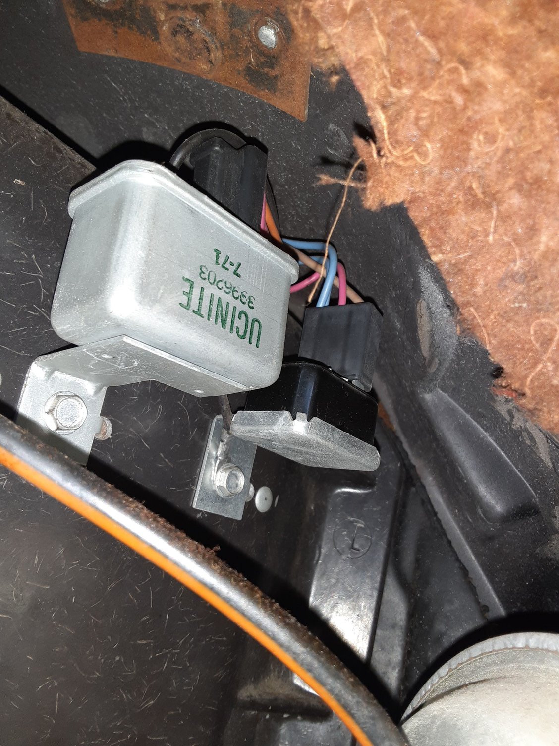

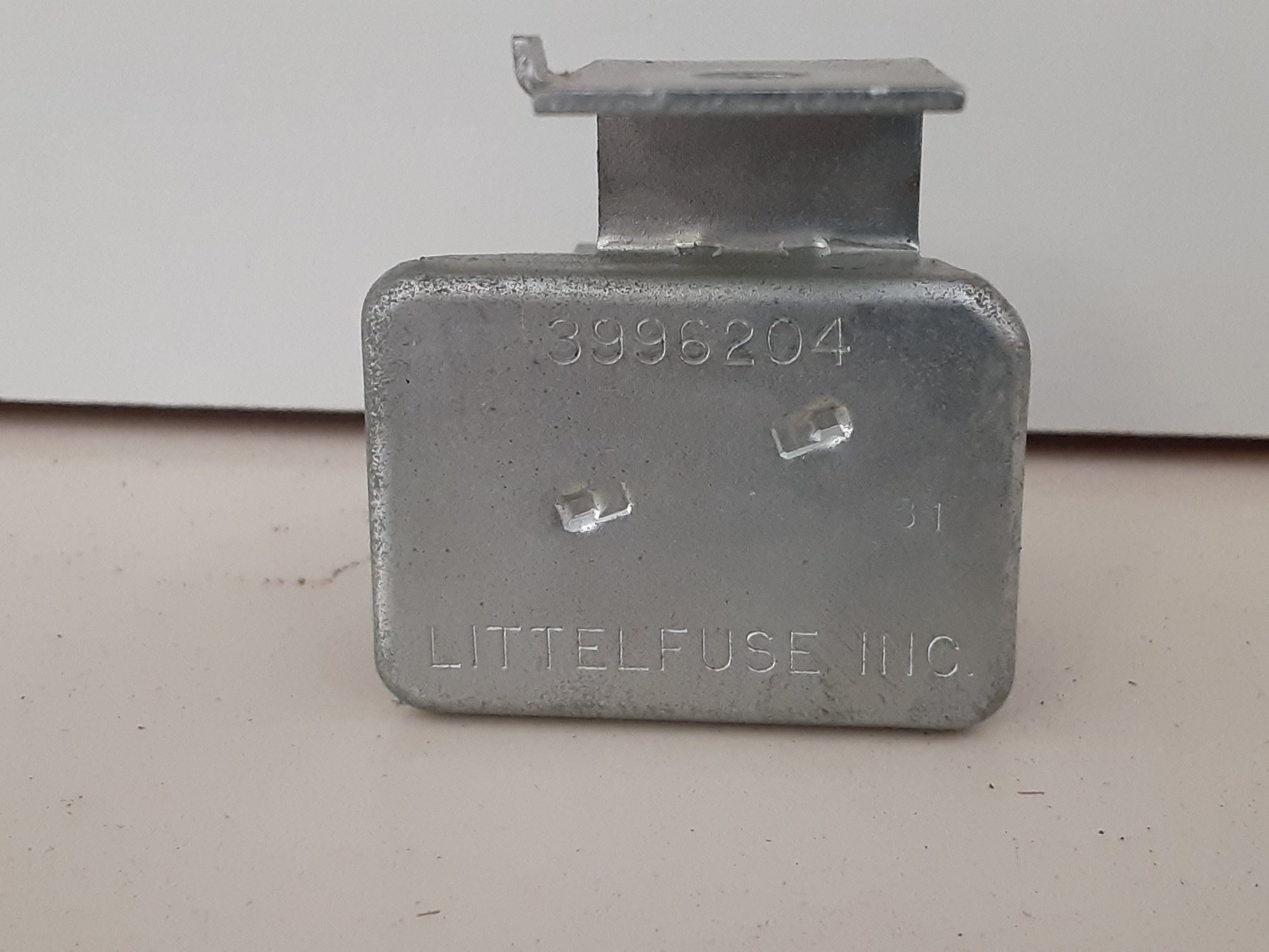

Do you use both relays or have you pulled them and jumpered the Anti Dieseling relay plug.
Here ya go Ted,
I was too curious, I pulled the dash and looked at the relays. From my research online, I found that the relay on the left should be part #3996203, and the relay on the right should be part #3996204.
Here is what I found behind my dash: The numbers match what I found online, note that there is a black wire with lug under the mounting screw on relay #3996204. Also, both relays have 3 prongs.

Originally Posted by 71 Green 454
Here ya go Ted,
THANK YOU VERY MUCH. YOU WENT WAY ABOVE BY PULLING THAT DASH TO FIND THOSE RELAYS
THE ONE I NEED IS 3992603. BOTH 3 PRONG RELAYS.
AGAIN THANK YOU.

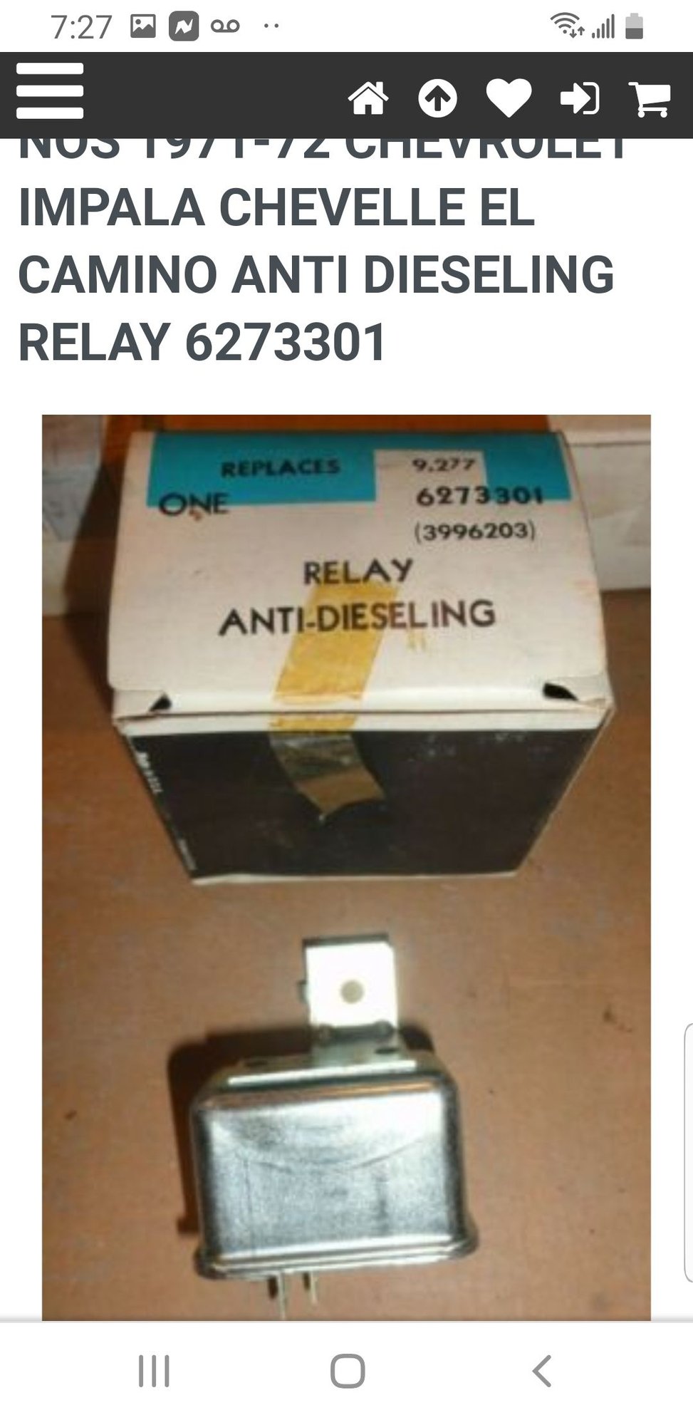

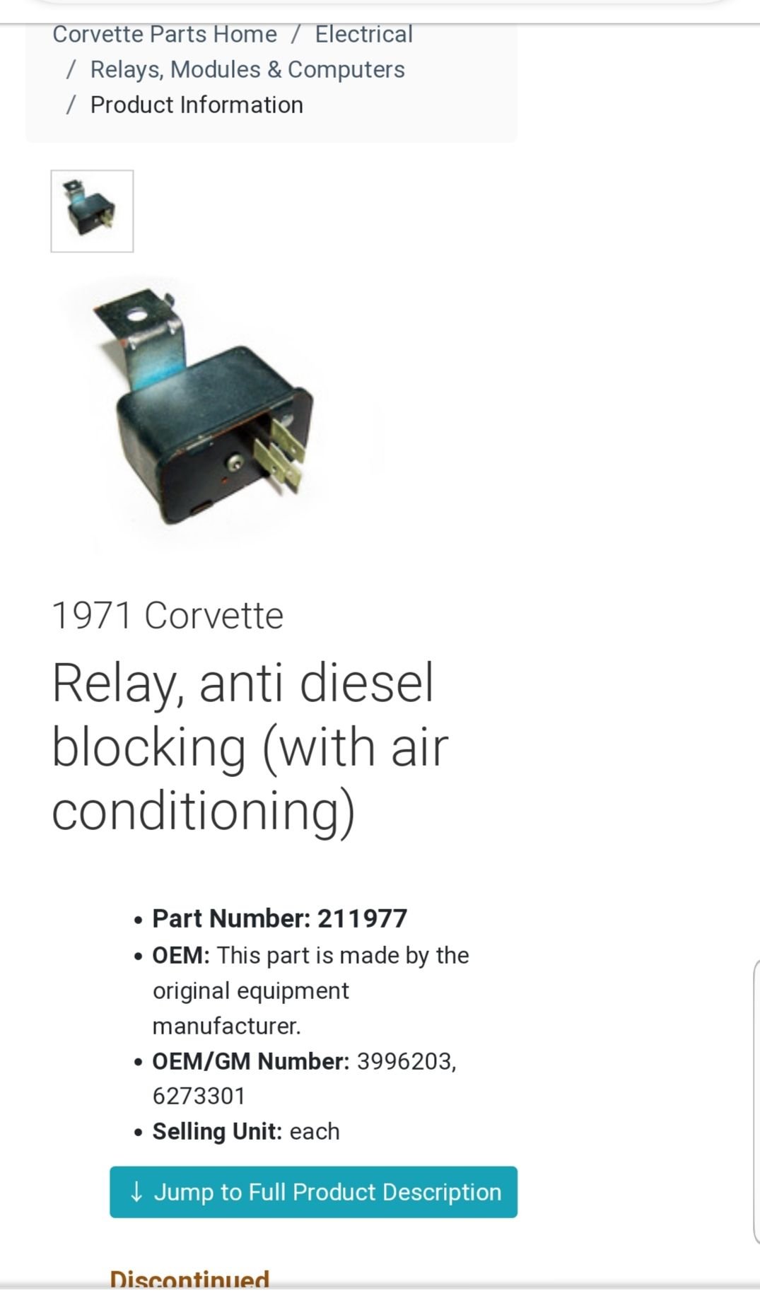

Default Relay purchased
Originally Posted by thelal1
Wish center console gauges were that easy to replace.
3996203
GM 6273301
Bought this one,,, the last I could find. Did cross reference. It is described as Anti dieseling blocking relay. Thanks for pulling ur dash and sending that pic.

Default 3996203
That is the one I needed. The 3996204 is called ant dieseling relay which is a thermal fuse.
The 3996203 is a anti dieseling blocking relay. I took your info and treid to find one. The cross reference gm number 6273301 came up. Found only one. Bought that..
