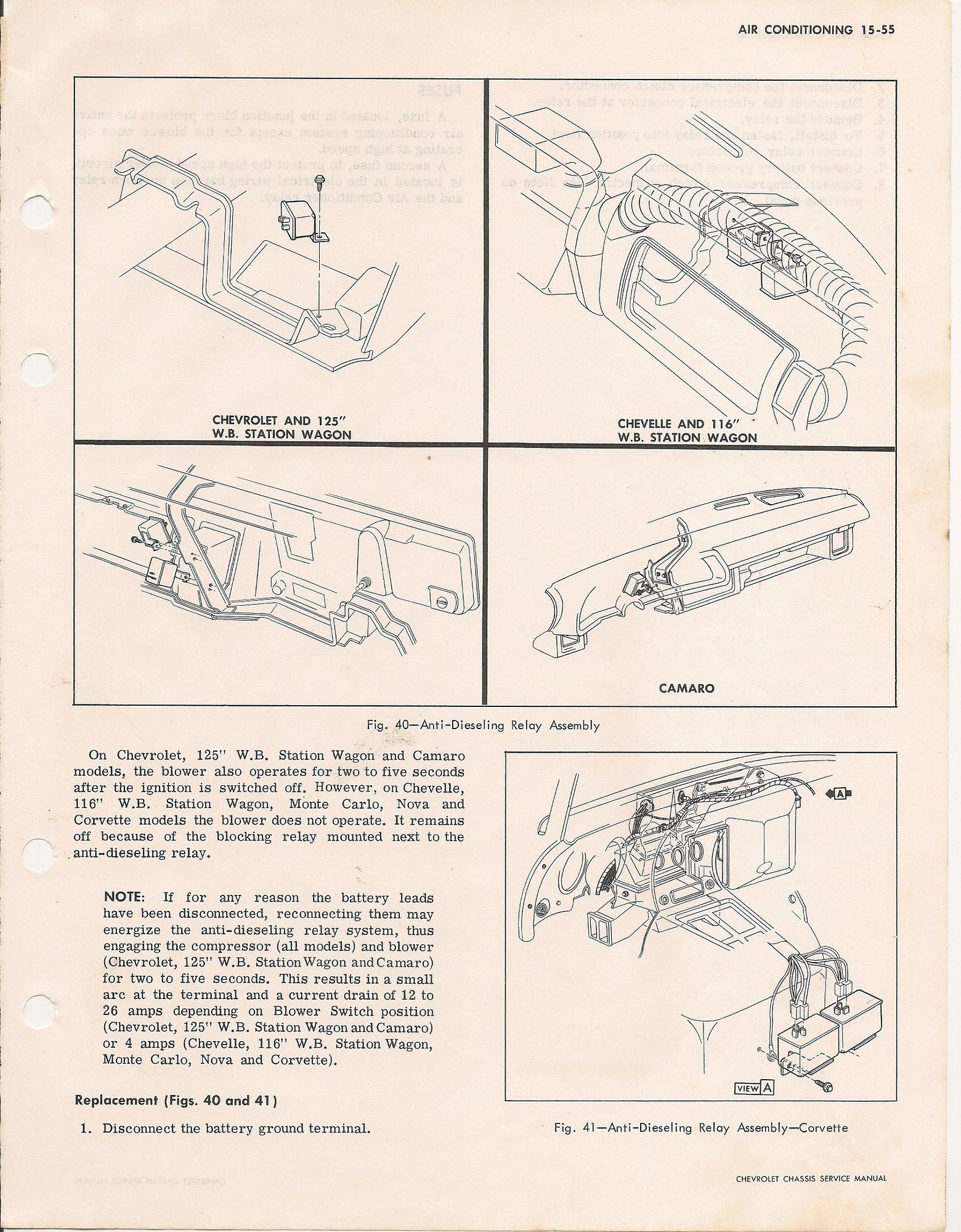

Originally Posted by thelal1
Dave,
Installed new relay, everything works as should on AC and both relays sending signal to compressor and the new shutting down high speed blower.
One issue when turning on AC one relay has a tinging humming noise.
Is that usual???
TED
Ted, concerning your humming noise, which relay on your car has the ground wire lug under the relay mounting screw?
Mine is mounted on the right relay and ajchance's is mounted on the left relay.
I was looking at the drawings (fig. 41) and it shows the ground lug under the left relay mounting screw.
