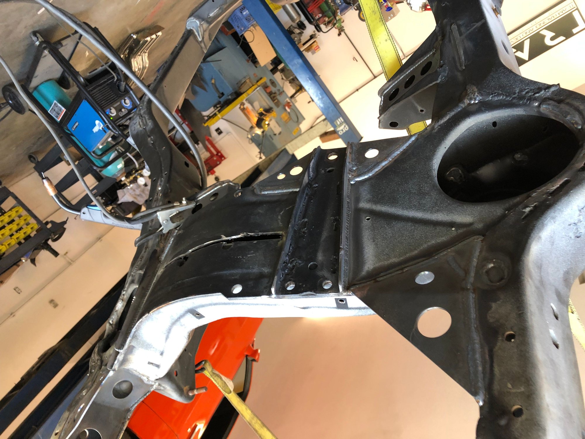

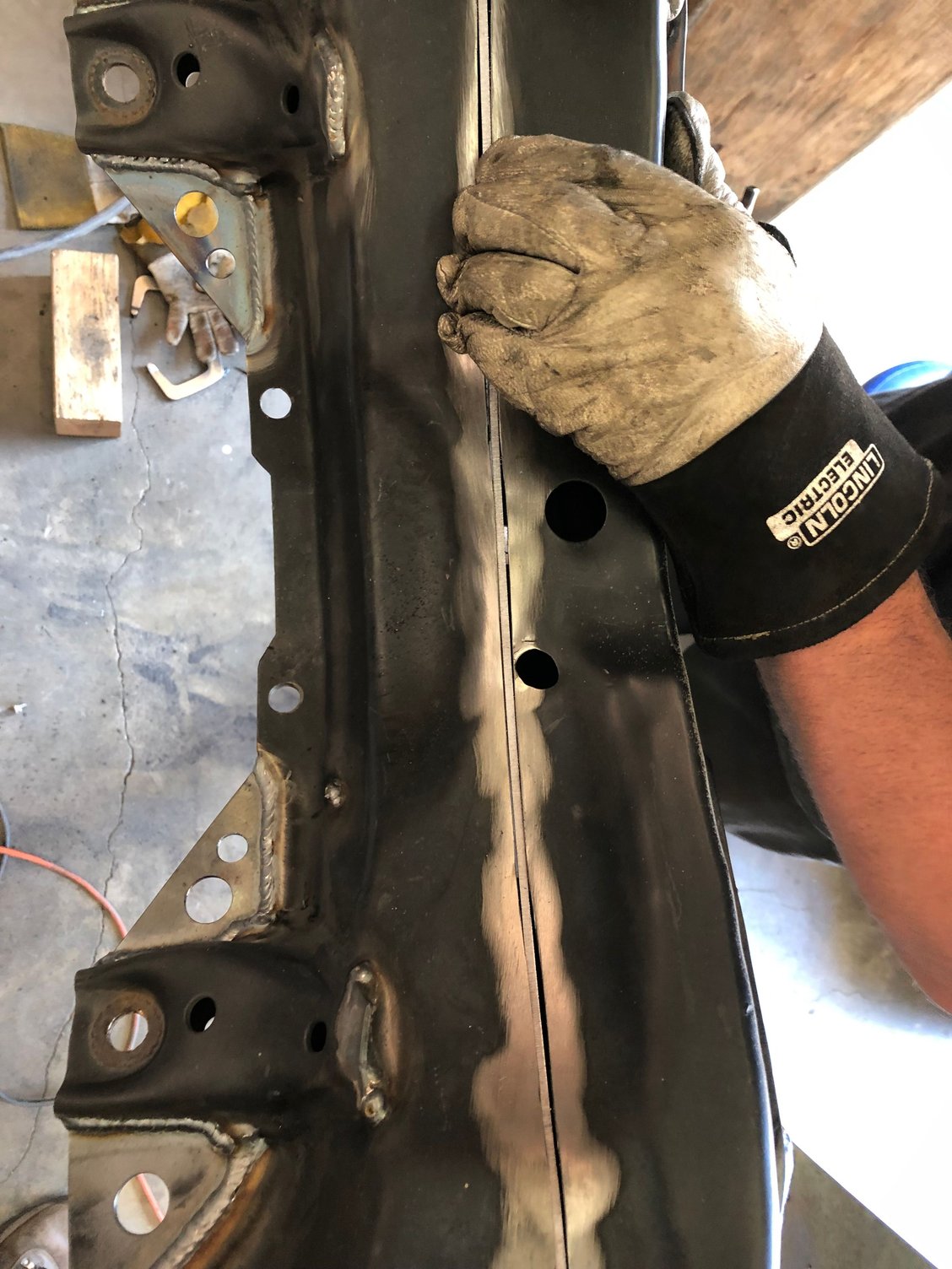

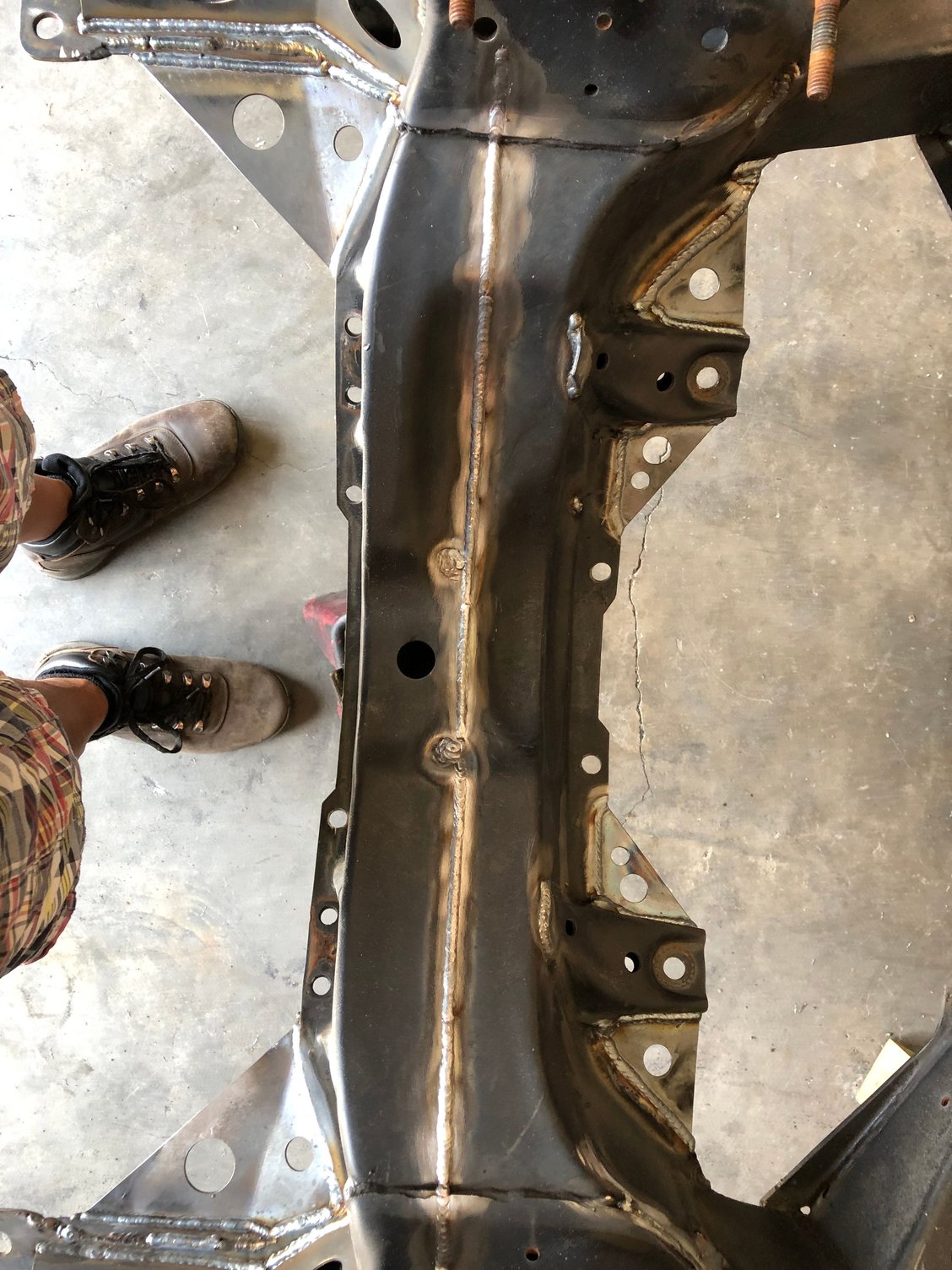

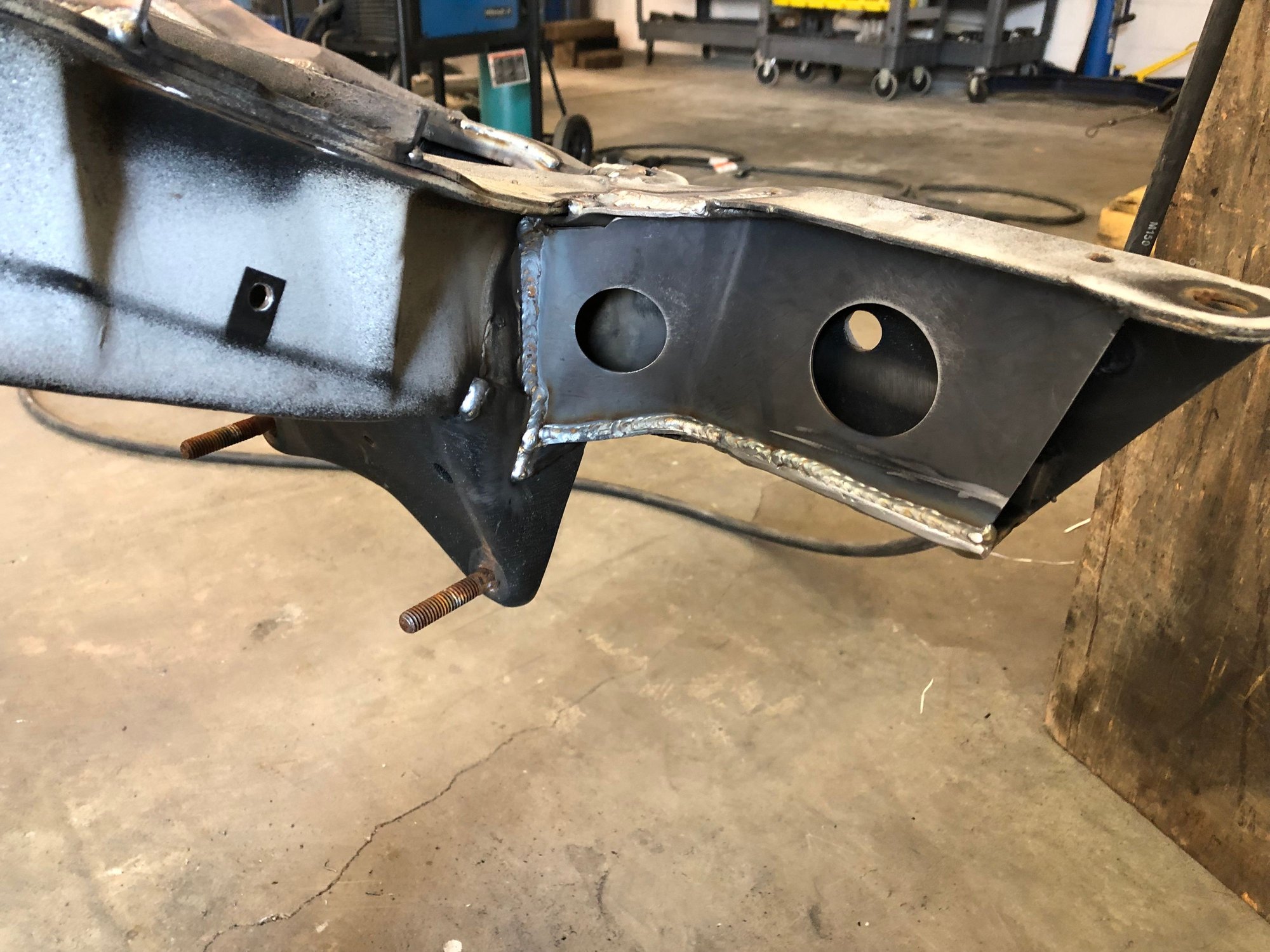

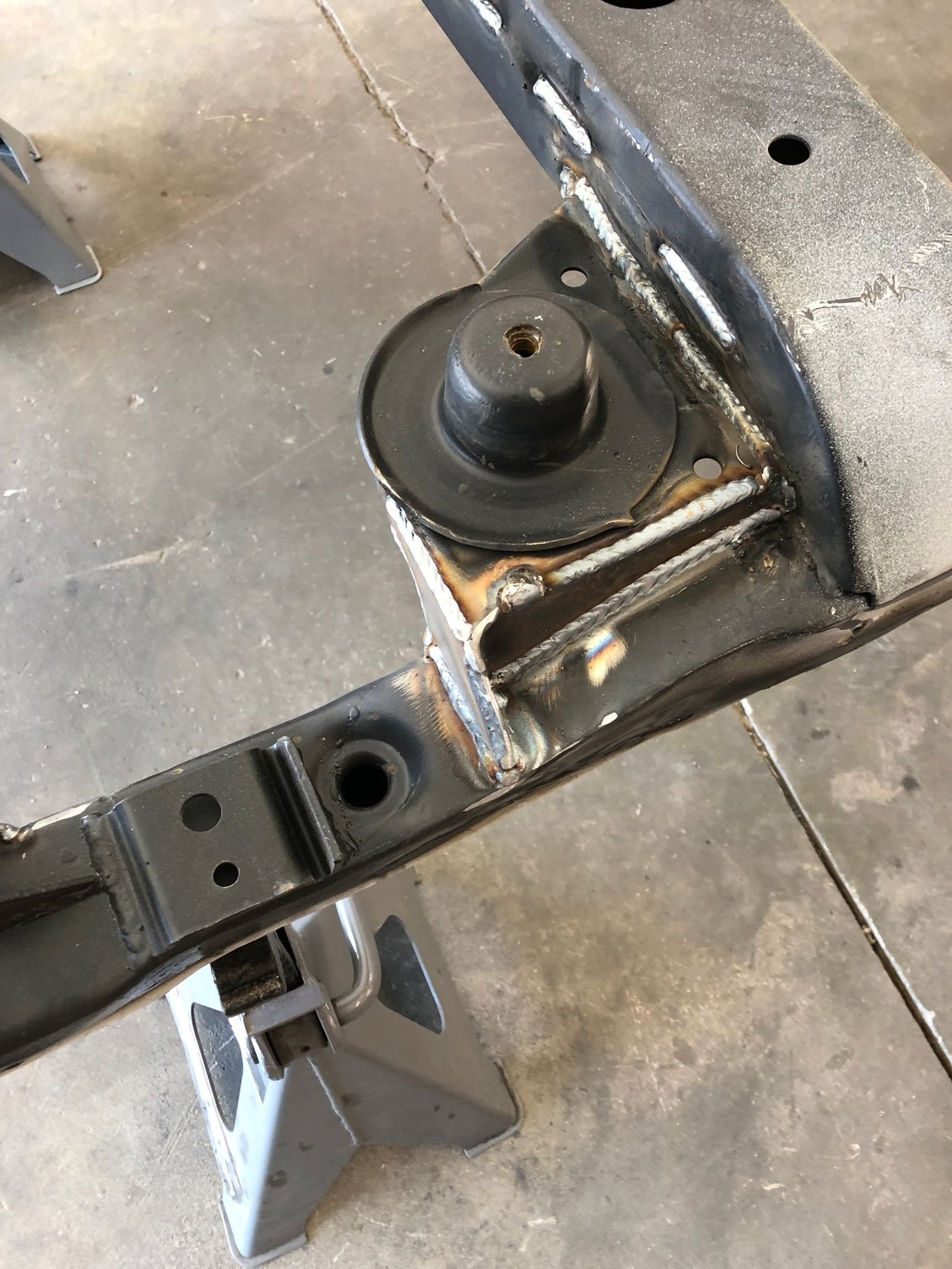

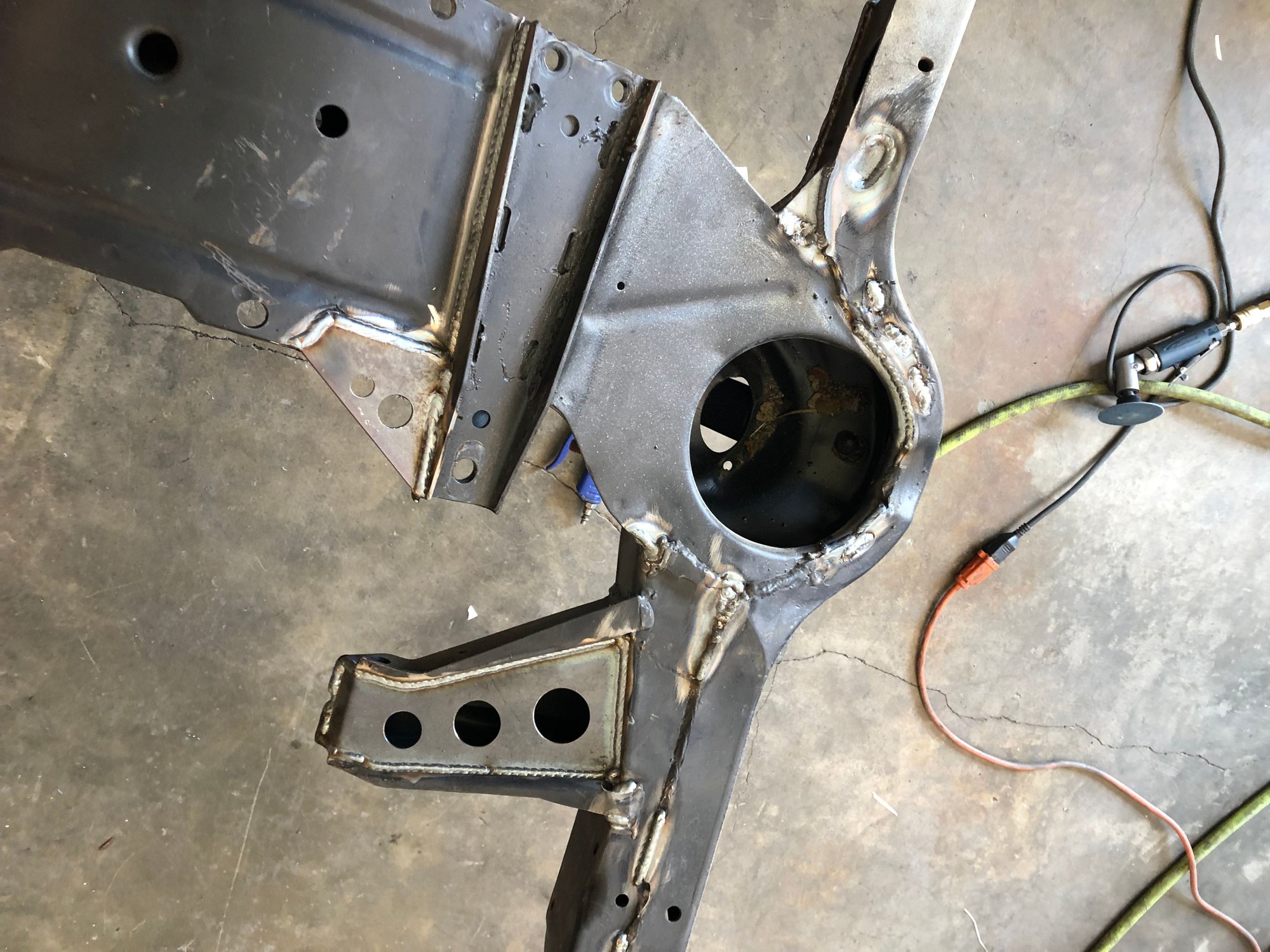

Instead of fully welding the frame we just welded where the factory didn't and added a few things. Car is not together yet so not sure how it is

Reno I really like those bulkhead style inserts you added. That should help a lot!

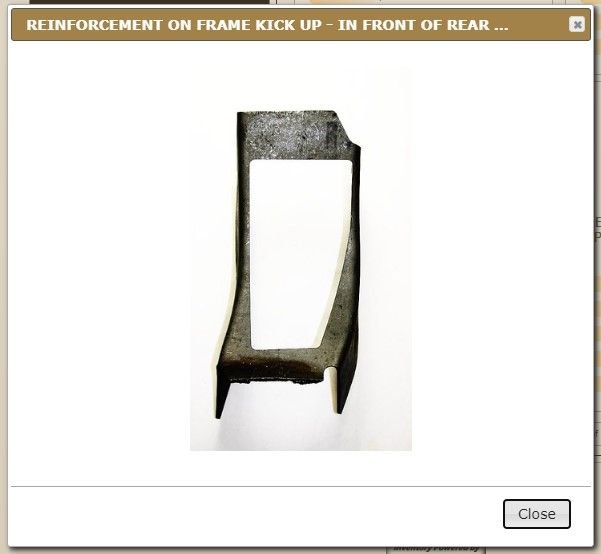

What do you guys think of these rear kickup reinforcements I found on http://www.vetteproducts.net/? (These guys have everything for the frame)

Reno Stallion's mods in the front of the chassis (braces) are almost identical to the Chevy Power Book. When I had my body off, I also added these supports as well as finishing the seam welding on the frame as per the CPB. Also like Reno, I went over the welds for the lower front control arm attachment to the chassis itself. You see so many pics of these pulling off the frames, it just makes sense while you are in there.
My setup is the fully welded frame and gussets as per the CPB. I also have a Borgeson steering box, so I was able to close the round hole in the frame which allowed access to the old power steering ram mount point, which is identified as weak. While I was rebuilding, I changed my rear end mount point to solid and eliminated the top hat bushings on that crossmember. The rear suspension was changed to the VanSteel coil-over setup and the front is the (now defunct) VB and P front transverse leaf spring and adjustable shocks, so not much stock to provide a comparison.
It is a very solid feeling ride though. Too bad I just love the looks of the original aluminum rims on the car. I bet it would handle much better if I wasn't riding around on giant chocolate donuts for tires
I have friends who autocross, but I do not. I'm just one of those fools who enjoys a challenge and did it all myself.
Good Luck.

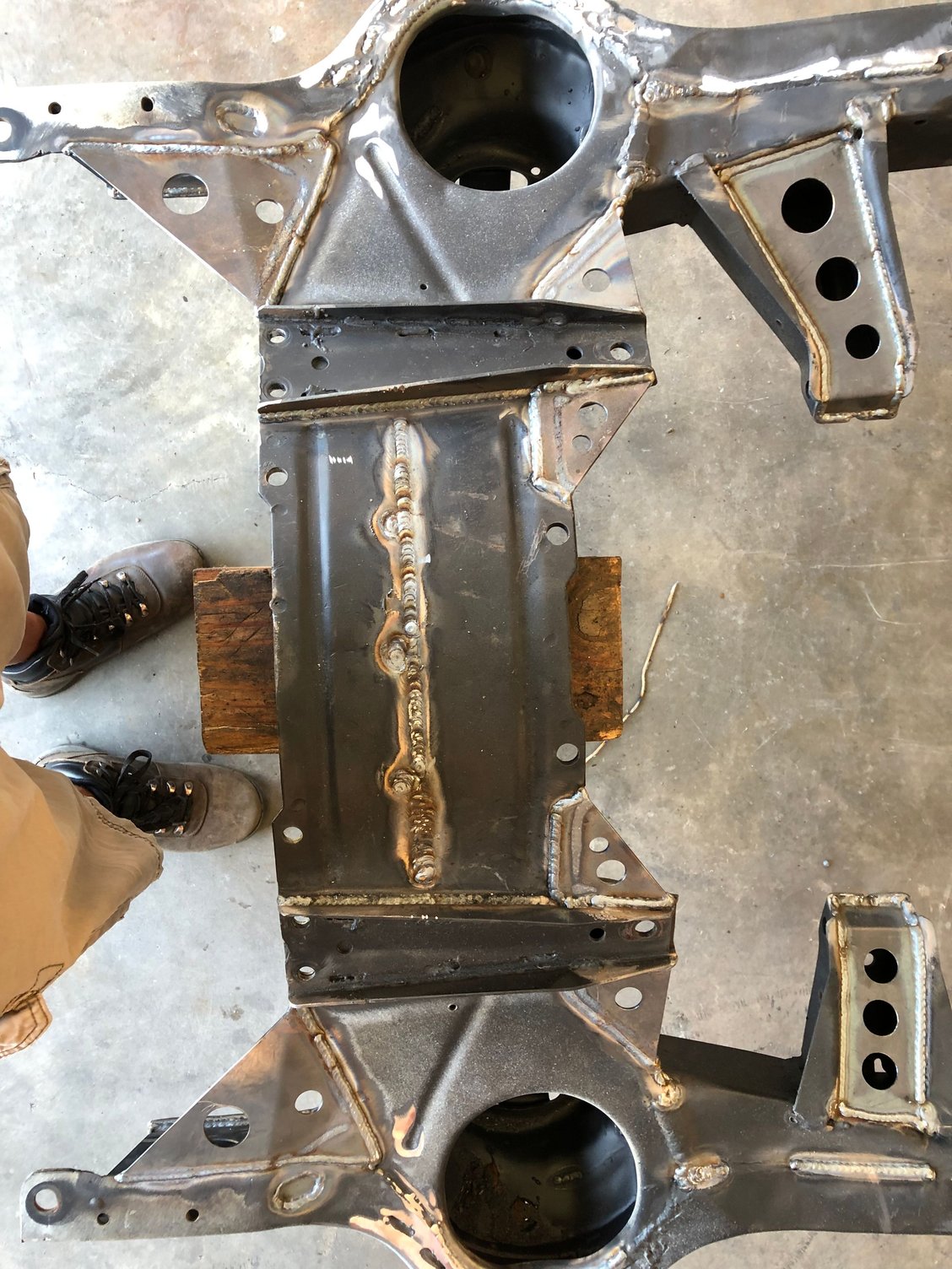

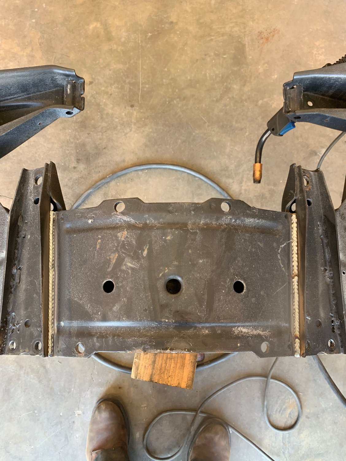

Can't believe no one asked about this pic
Have any of you done this?
It's certainly on my list of things to do, the next time I have my body separated from the chassis.
It's in the Chevy Power Book:
https://www.duntovmotors.com/Corvett...wer%20Book.pdf

Reno ,Dont forget to fill and weld the hole adjacent to the steering box.

Reno I have to ask about the last pic. I dont recognize what is going on there.
I've added a 3/16 plate to the underside of my crossmember between the lower A arm mounts
I totally missed what was going on in that pic when I looked. Now that's impressive.
I don't think it is in the CPB but I was told by a guy that has been racing these chassis and winning for years probably shouldn't say who not sure if it is allowed in the class they run in. Anyway you slot the cross member top and bottom and weld in a 1/4" plate. They have a fixture they bolt the frames in and twist it to see what gives. He told me this is one of the best ways to eliminate front torsional flex. Hope I'm explaining it correctly
They would grind these down so you couldn't see it I didn't kinda like it
I don't think it is in the CPB but I was told by a guy that has been racing these chassis and winning for years probably shouldn't say who not sure if it is allowed in the class they run in. Anyway you slot the cross member top and bottom and weld in a 1/4" plate. They have a fixture they bolt the frames in and twist it to see what gives. He told me this is one of the best ways to eliminate front torsional flex. Hope I'm explaining it correctly. They would grind these down so you couldn't see it I didn't kinda like it
Wow! That is genius!
I think you are explaining it perfectly.
And physics-wise that extra bulkhead should really stiffen up the front section. As good as or better than a spreader bar. It's a Genius idea. It's the kind of racing mod where if you can't see it, then it must be legal, right ! LOL
Reminds me of Smokey Yunick tricks.. He used the hollow roll-cage for a NOS bottle, etc. etc.
Did anyone else catch the fuel line run on the outside of the frame rail away from the header's heat???

Now that I see what you meant, that's brilliant!
That trick is not in the CBD (the gussets I thought you were referencing are).
Thanks for sharing!

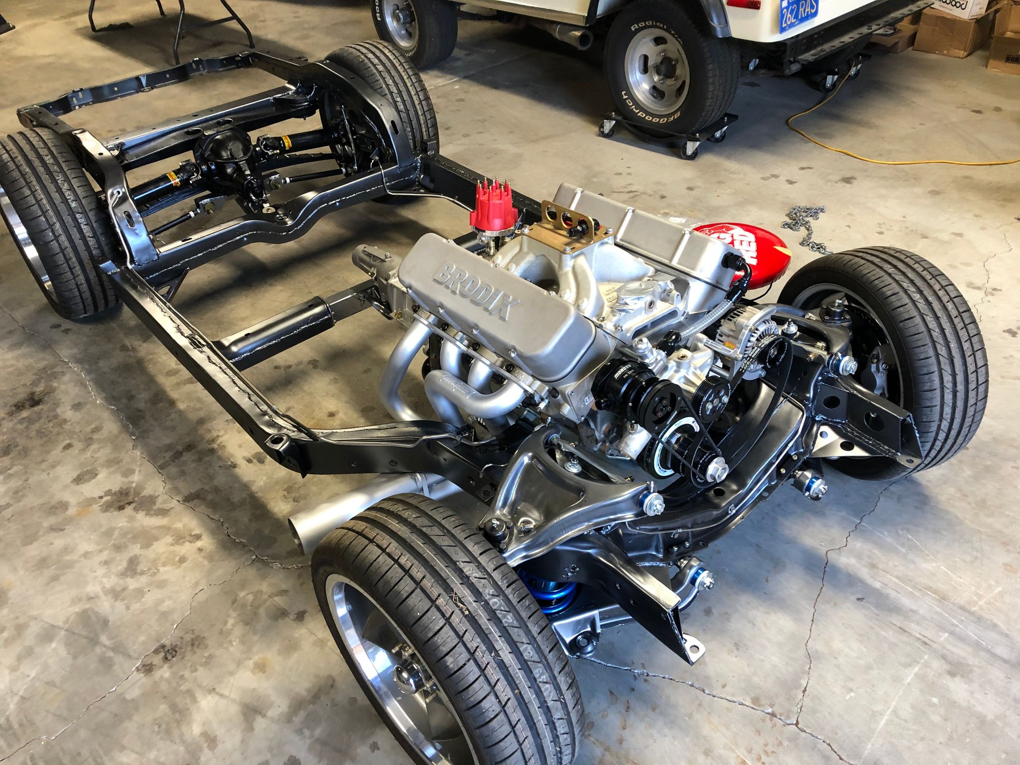

Progress

UUUH... That looks serious!! Yikes.
You are gonna need bigger tires! LOL

I like what you did with creating the removable cross-member. It looks very slick how you got the bolts tucked in like that. I added plates that bolted on the outside of the old cross-member. Not quite as trick, but it allowed me to use the original section instead of fabricating a custom one like you did.
Any other hidden gems we haven't picked up on yet?
