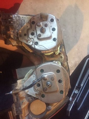

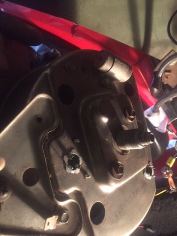

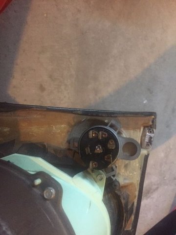

Here are some pictures..
was a nice day out !
everything working - thats me in the shadow ..LOL

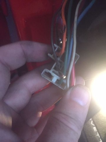

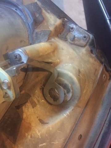

back of dash - ground to headlight switch
tach Nov 19 1967..
52 years of dirt!
trying to label the vacuum hoses to make reinstalling a bit easier .

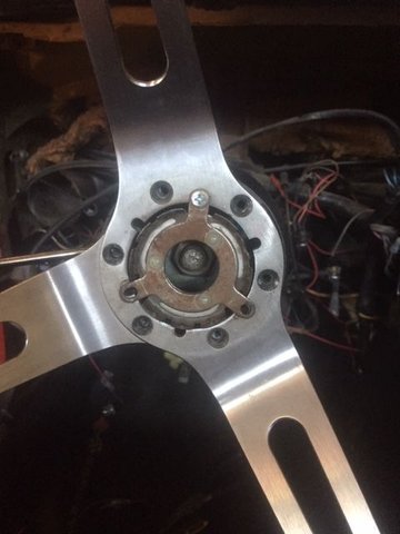

Steering wheel removal

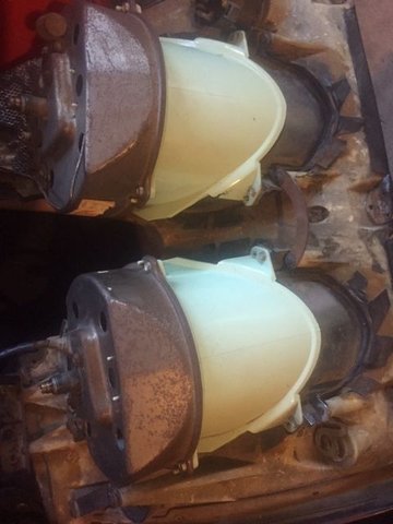

Instrument cluster is out ... that was not fun , not easy and not enjoyable !
cleaned it up a bit
ignition - we have lift off.
Headlight switch , one of the tan wires was completely burnt out .
