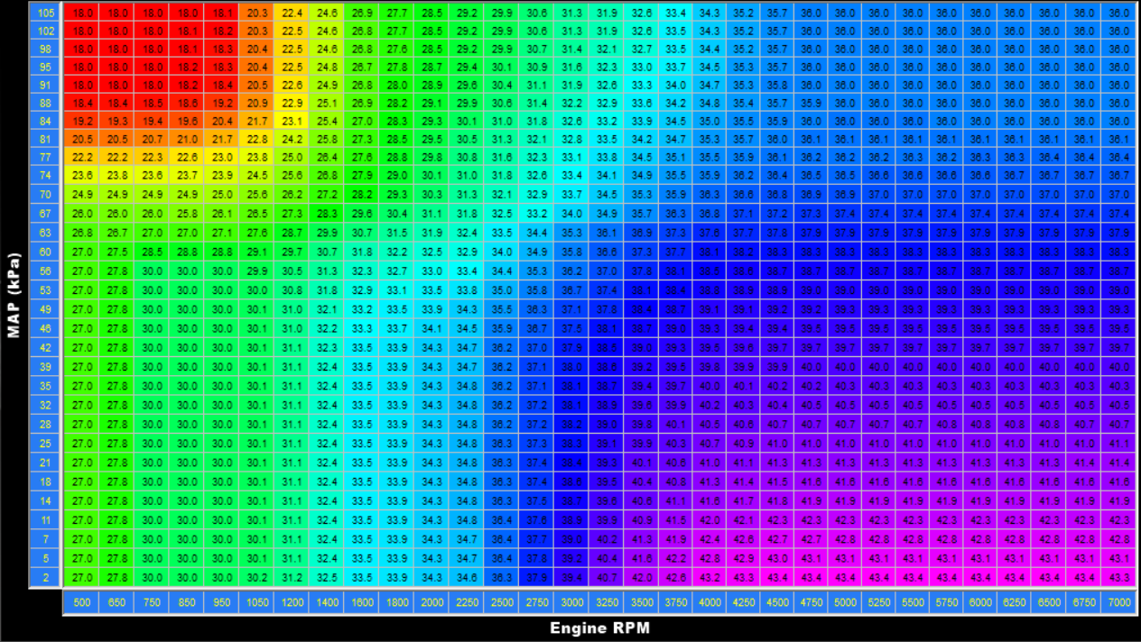

1968 427/390
setting up timing table for Holley Sniper / Hyperspark
Looking for timing advance for:
Idle
cruise
WOT
this internet and ref manuals are full of procedures to set timing... I just need the numbers....
thanks - TK

This should work for you. You may want to reduce advance at idle to 25 degrees. I run 30 because I have a bit of a cam in it. It's a built '71 454 LS5. 10:1 compression.

15 base
38 total
48-50 part throttle cruise
Play with the base to see how it responds to you.
Jebby
