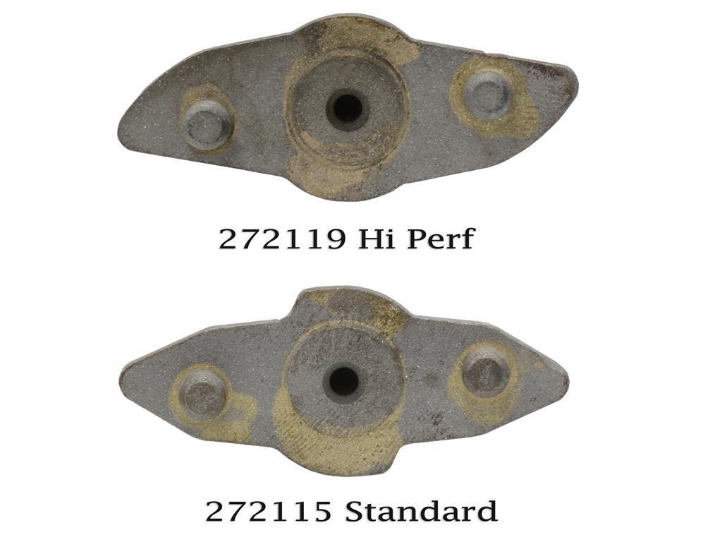

That alone may cure your problem. But another member recently had a problem with the distributor "football" and it gave him very slow advance at 1800-2400 and he had a mild bog like you.

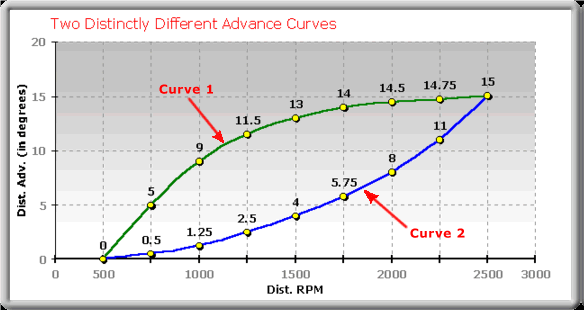

GM supplied many football shapes. but there are basically two available today. The std one and the hi-perf one. The hi-perf one (curve 1) gives about 7 more degrees at 75% of max rpm vs the retarded std one. Engines with better than mild factory cams really respond to it. Looking at it another way the high-perf football gives 11 degrees advance by 1250rpm vs 2 degrees for the slow std one. If you have a timing tape you could measure it and plot it. It sounds like it needs more advance, sooner. This fix would help a WOT low rpm bog.

Also agree that the stock GM curve for timing is kinda junk for higher performance applications. I ended up making my own curve, center piece, to get the timing advance I wanted.

You could read the timing every 200 rpm and make your own curve. Just use a dial back timing light, or a degree tape on the dampner.. With vac unplugged.
