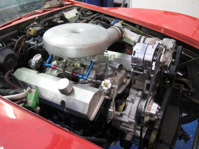

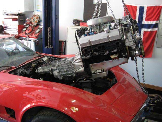

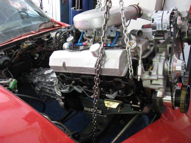

It drops in as an assembled unit in less than 10 minutes, working by yourself. I just use a tranny jack to get the tranny tailhousing up over the fixed crossmember as the assembly drops in, with the car sitting on the ground. Here is one I did not long ago with a Tremec tranny on it, which is bigger and longer than the stock Muncie. Engine goes in with all accessories pre-mounted, and this one has a supercharger on it, too:
Engine in the car and on the engine mounts. Just under 10 minutes:
Lars
