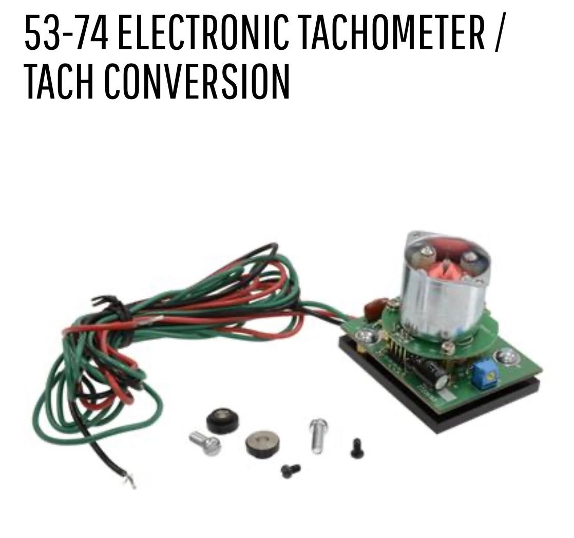

Has anyone installed one of these? Thinking of installing on my 69 427 coupe? Is it as simple as removing the mechanical drive from the rear of the tach and replacing with this module? Three wires - red positive, black ground, and green goes to positive on coil.

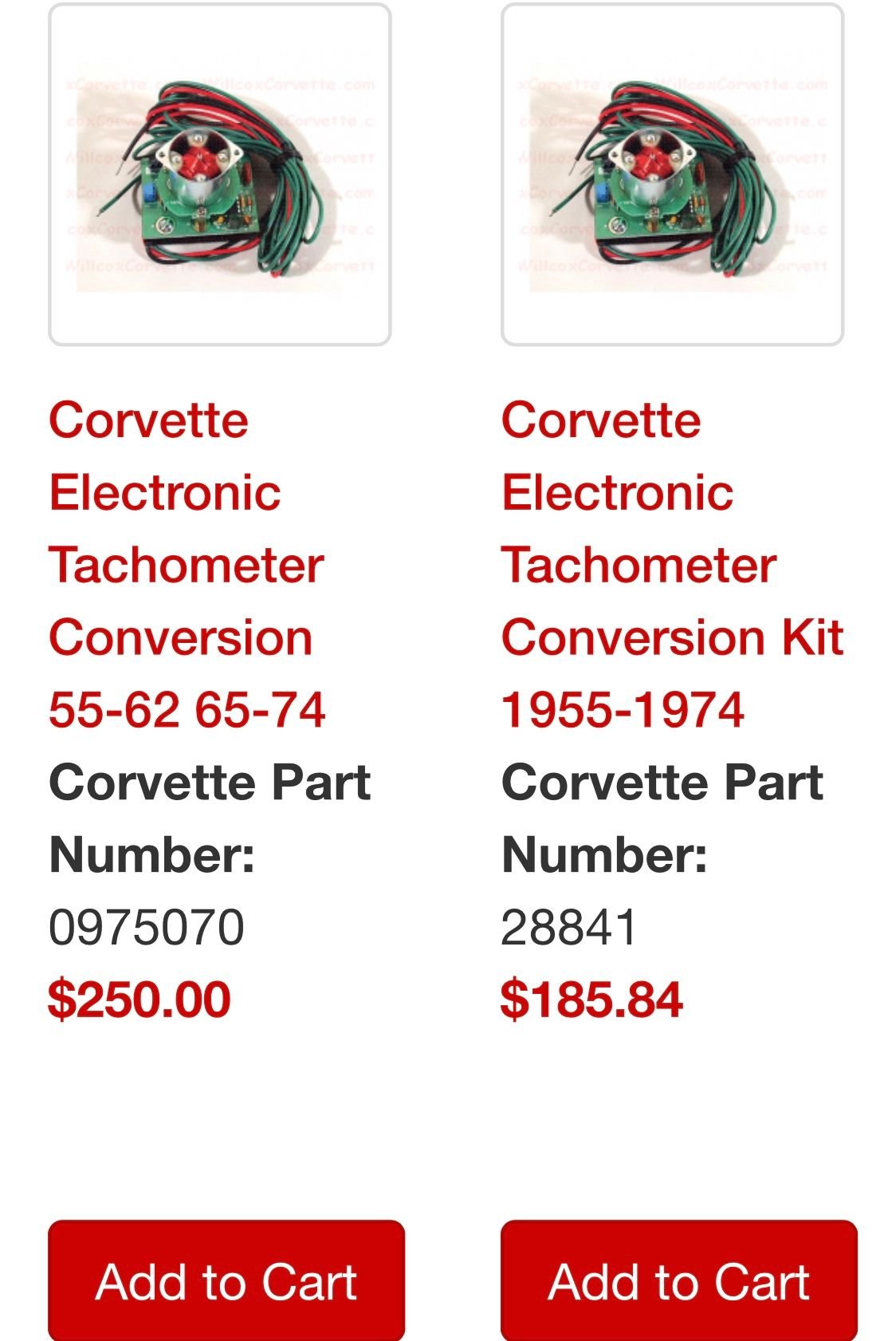

The below items are from the Wilcox site. Which one for a 69? Wilcox will calibrate prior to shipping?

Best to ask Ernie but I believe the $250 was for them to install it (you send your tach and they convert it)

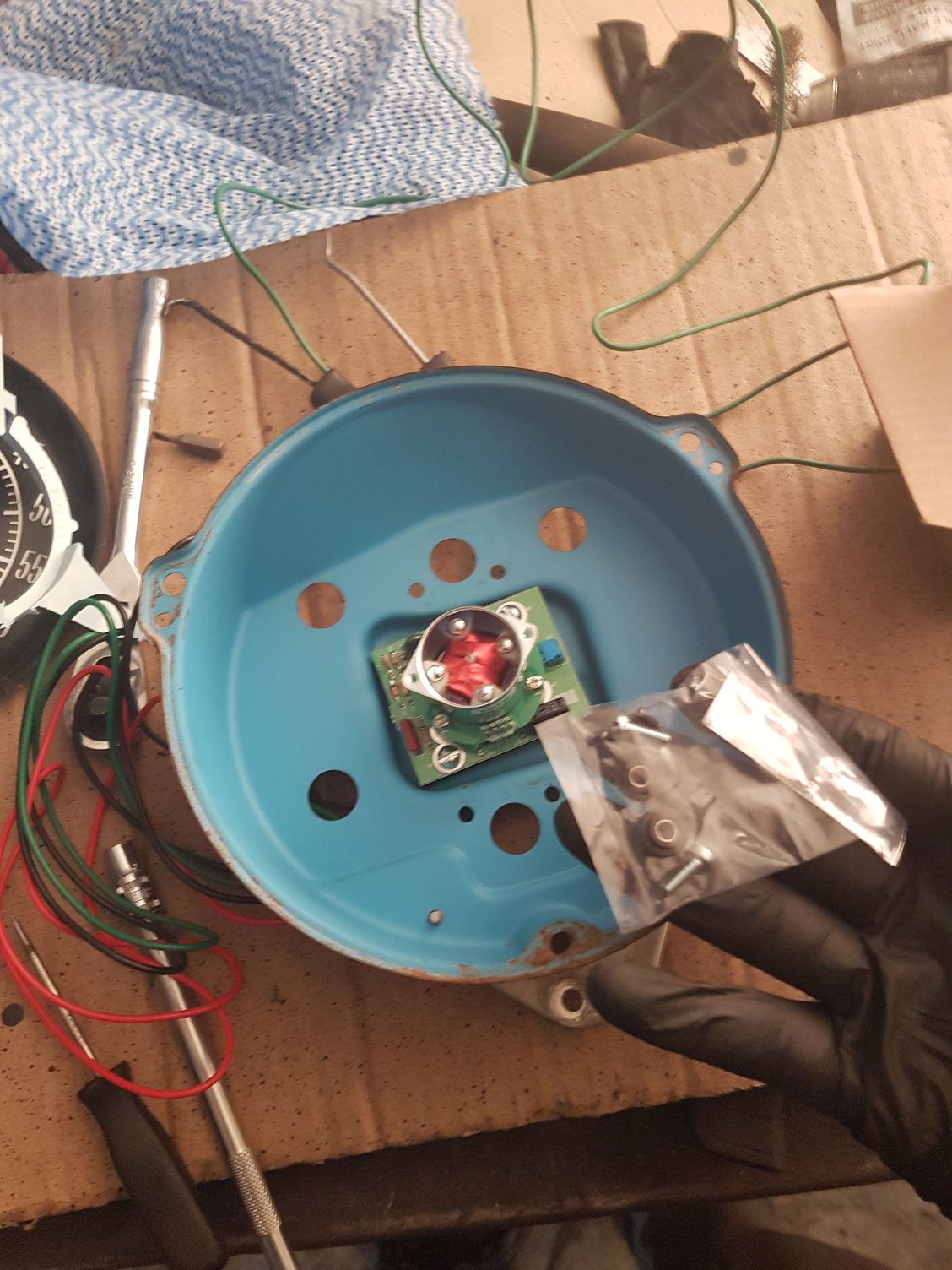

Hi mate,
yes it is pretty much that simple.
All hardware included and lines up perfectly.
Positive goes to ignition. Ground to ground and green to negative side of coil.
However you need to calibrate it also.
You can have it done from a gauge repair shop that will use a signal generator or if you have a digital timing light which shows engine RPM you can do what I did and calibrate it pretty darn close using the timing light. First you "zero" the needle by connecting all wires. Turn the ignition on and that is 0 on the gauge. Now adjust the needle to zero. Now everytime you turn the ignition on it should zero.
Now with your digital timing light set up you can start the car and when you have a nice idle turn the yellow screw on the side of the electronic unit to adjust the needle position to suit the RPM showing on your timing light. Making sure its consistent at various RPMs
here's a few photos I took doing mine
