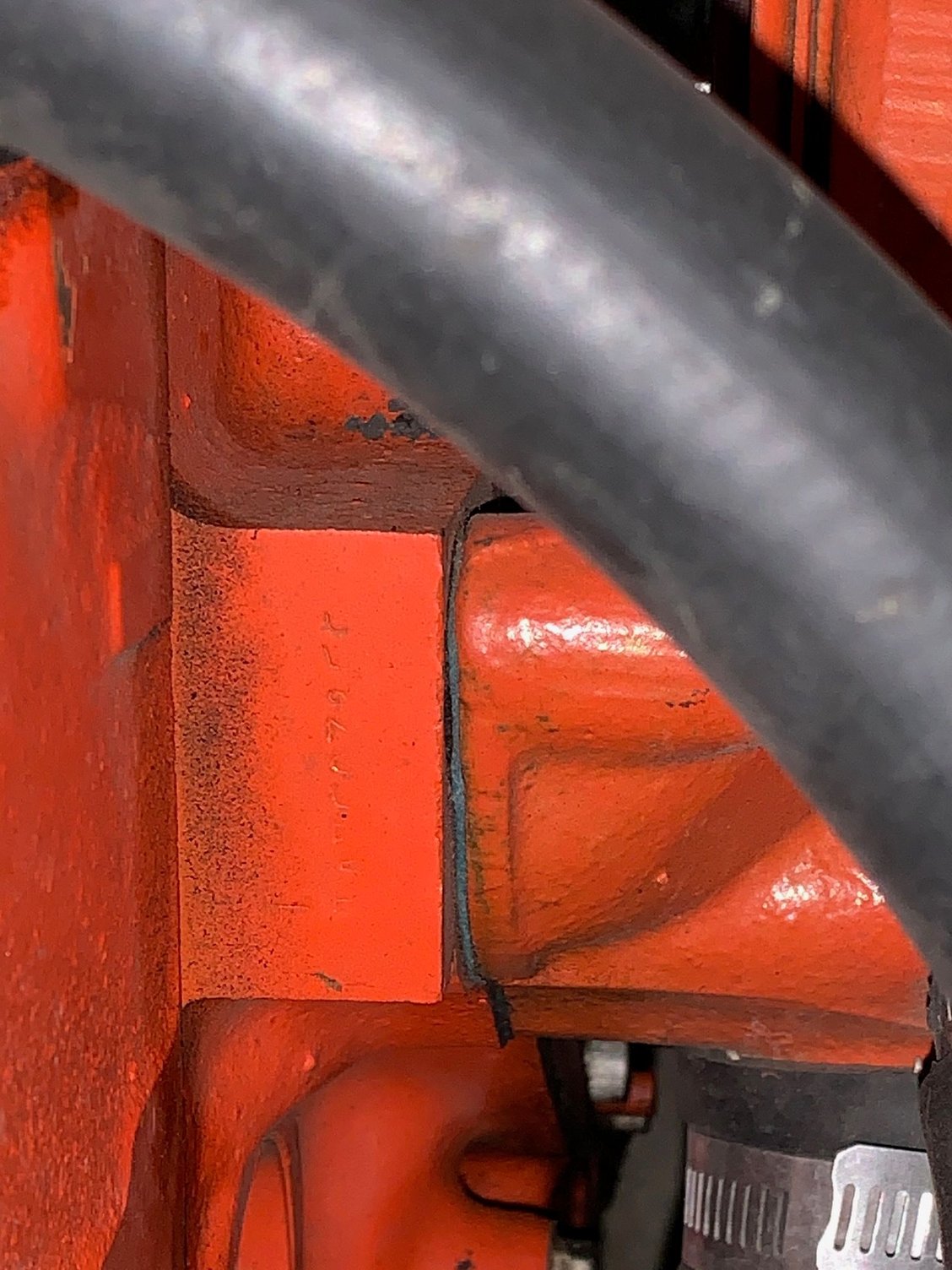

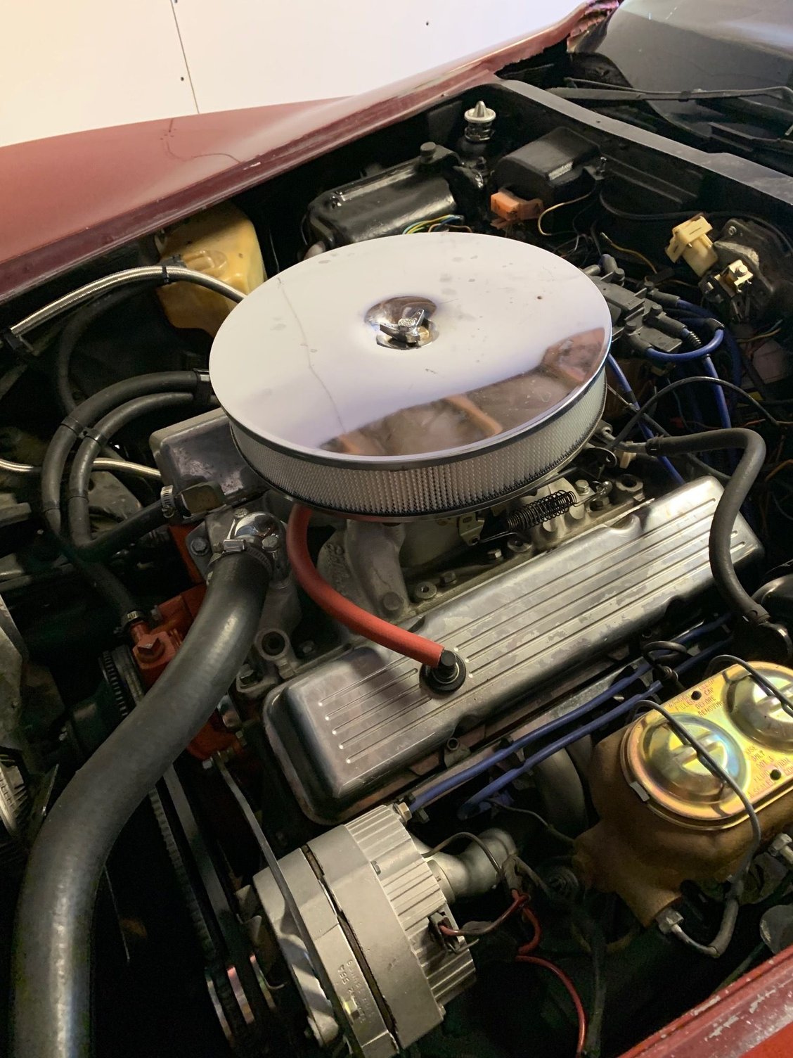

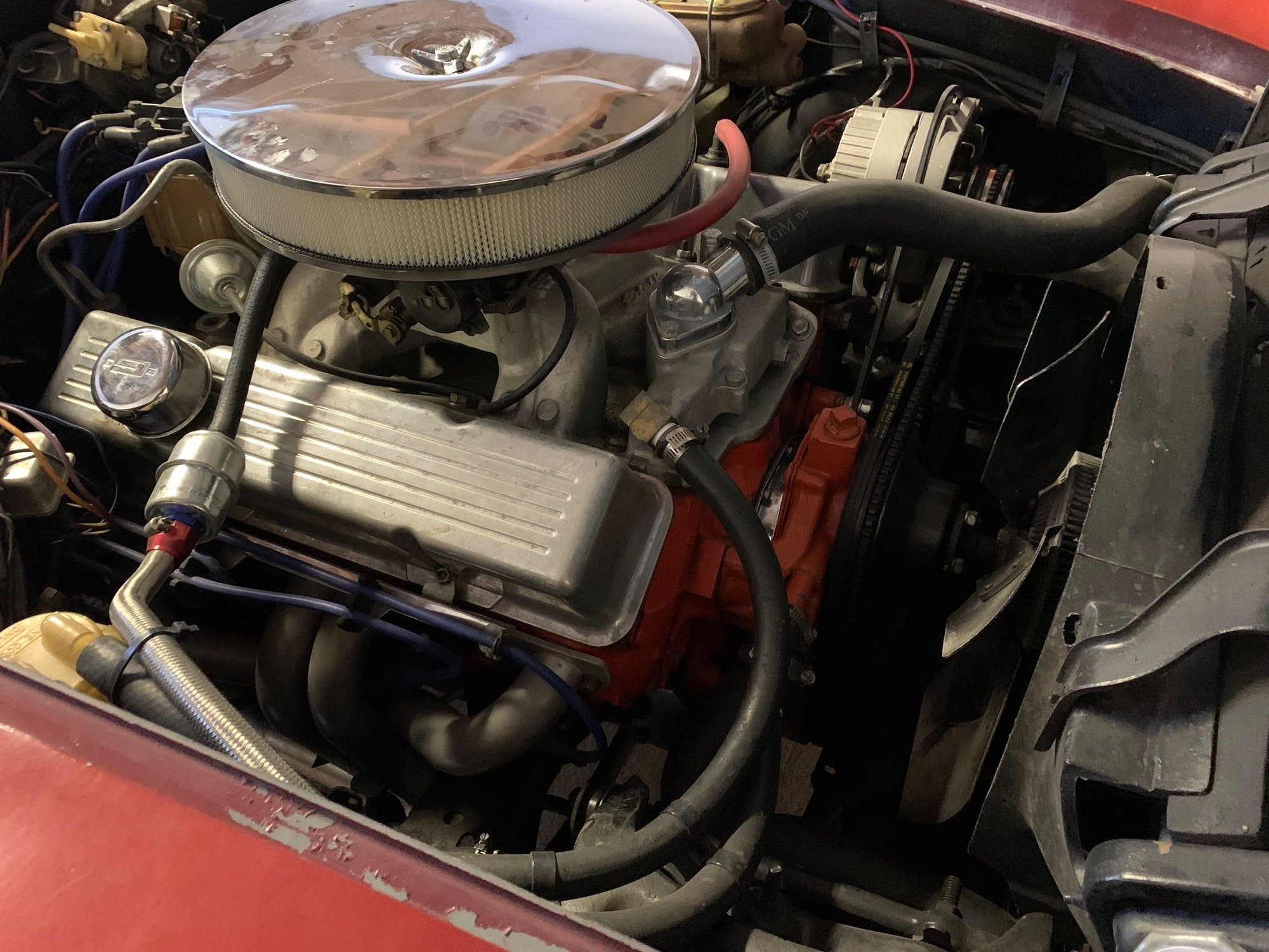

One other question I hope to get answered.. The previous owner said that the guy he bought the car from told him the engine was a rebuilt 400. I tried to have him elaborate on that but that's all he knew. I don't know much about engines myself so I was wondering if any of you could identify from the photos what kind of engine it is. I tend to think it's just the original 350 that's been rebuilt but I can't say for sure. There is part of an engine number under the timing belt on the right side but it's unreadable.

Get a better picture of the stamp pad (maybe use some steel wool to scuff the paint) so you can see what the block was born as.

It is not the original 74 engine based on the stamp pad shape.

The numbers on the stamp pad look pretty faint so you may want to use some acetone or turpentine applied to a rag and rub lightly to reveal the numbers. Using something abrasive is not a good idea.

Maybe try a lead pencil and rub it over a piece of paper over the stamped number.

It’s only a matter of time until a helpful soul rips your heart out since you posted a picture of a C3 with (gasp) rubber fuel line in the engine compartment. That along with the timing belt comment can sometimes be a death sentence lol.
Someone here will know exactly what engine you have. To my eye it looks to have been made by General Motors and its orange.

Should I be concerned with the rubber fuel line? I don't know a lot about cars to include the C3 so any advice is appreciated. I can handle the criticism so that's not too much of a concern for me lol.

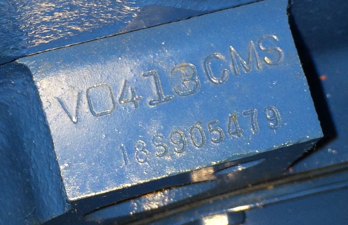

Thank you all for the advice. I was able to get it a lot more clear then it was but it's still not that visible
. Can anyone make any sense of this?

unfortunately you stamp pad has been partially removed by a prior decking. The last two digits are the "suffix" and used to determine what the engine was born as (SBC engines all interchange for the most part so just about any displacement and hp can be made)
http://chevellestuff.net/qd/engine_stamp_numbers.htm
https://nastyz28.com/gm-chevy-codes/...s-suffix-5.php
Check the casting code on the back of the block near the bellhouse, on the drivers side. That will tell what bore it originally came with and further deduce what displacement might be in there

OP the consensus here is any rubber fuel line in the engine room is a recipe for fiery disaster. Yours looks pretty fresh/robust so I’m guessing that pretty 74 won’t self immolate anytime soon. Maybe put it on the medium priority honey dew list.

That is a 1977 or newer engine and the pad would read something like this ( 78 pad.). Engine info on top and partial vin on the 2nd.
