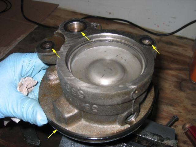

if you took it all the way apart here are the additional o rings that could leak from 1 the female connector or 2 the two studs...

iirc, the o ring i show cannot be removed without pulling apart the pump. i'm just guessing here that maybe its not there.
or maybe "If your Corvette is a 1980-1982, be sure to install the small o-ring. There is also large o-ring that sits behind the big nut in back of the PS pump. If you want to change this, be aware that it's spring-loaded. Oil o-rings with p/s fluid and carefully thread in the couplers."
is this the o ring you spaek of? if so it shouldnt be there..
