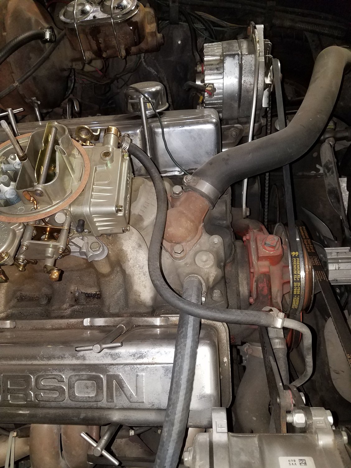

He bought it from a local dealer 5 years ago, and was told it was an old strip car, and 400hp.
I drove it a few minutes, and it certainly has a cam.
It actually runs pretty good, and has older hp bs like unilite tach drive and Holley 1850.
It spewed out the overflow on start up, so obviously the rad cap is done.
The shroud is trash, it has aftermarket air, and usually runs cool.
I bet the stat is gone too.
The fuel line is a treat. It can actually touch the belt.

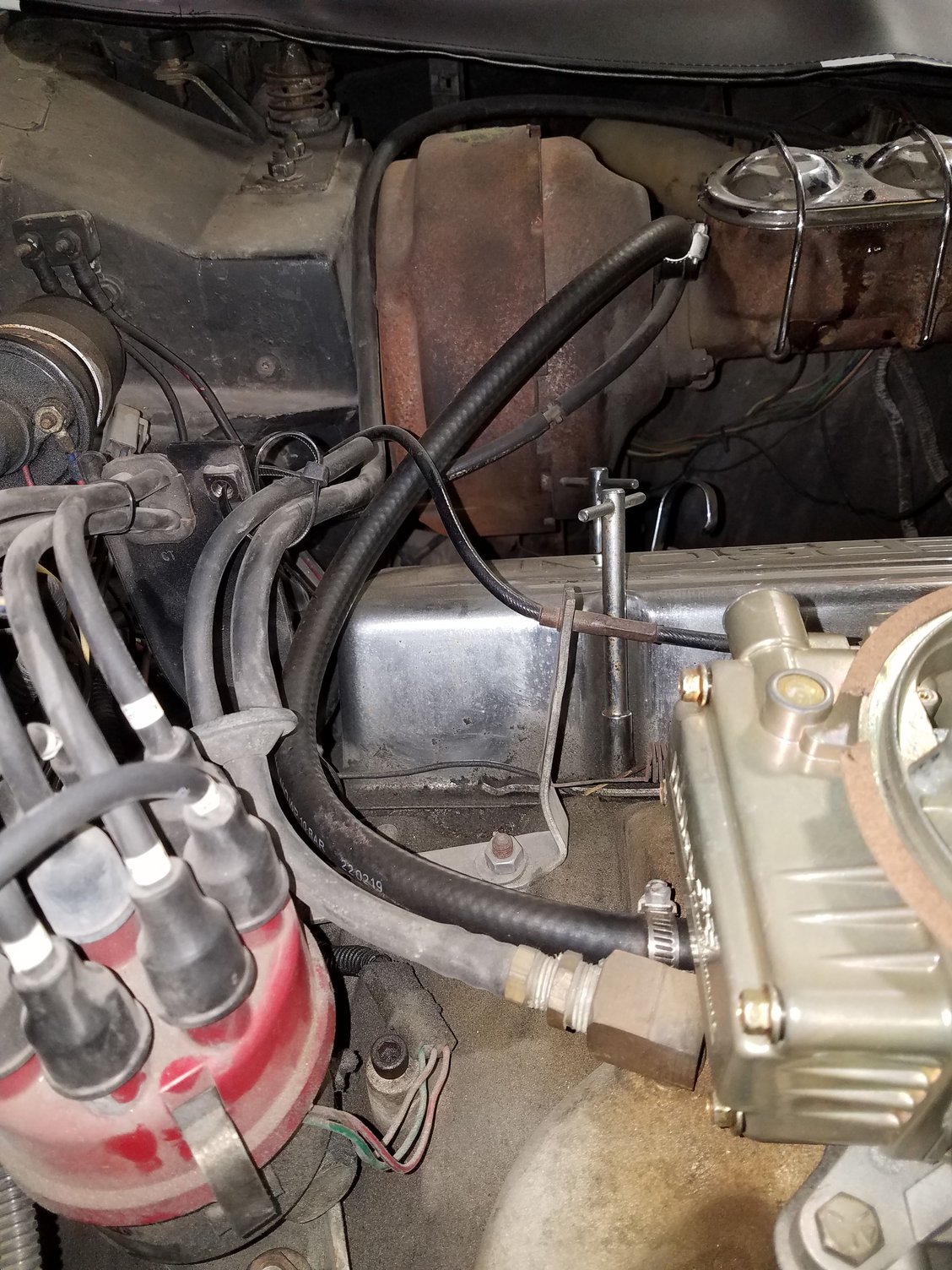

The filter sock is cut off, and an inline filter right before the fuel pump.

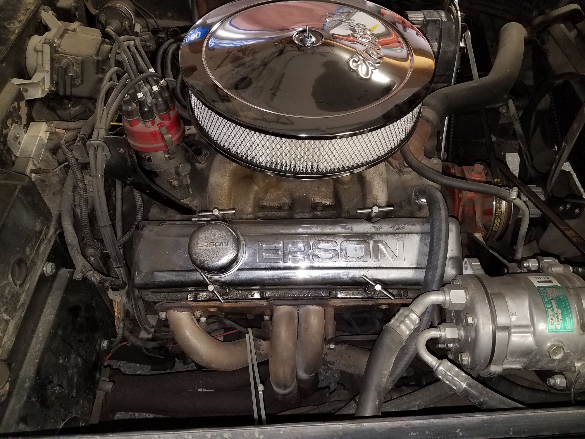

So, the plug wire ty wrap treatment is nifty.
Funny thing is, all this crap is what we did in high school.
It's actually a treat in a way.
So, feel free to comment, say "you should do this", or enjoy the "barn find" I would call this, or ask questions,
I have already told him the fuel system is trash, and I will replace it sender to carb the correct way, along with the flex fan has to go.
With the A/C , and he does live where it's hot, elec fans would be the better option.
Still sorting the good from the bad.

static PCV

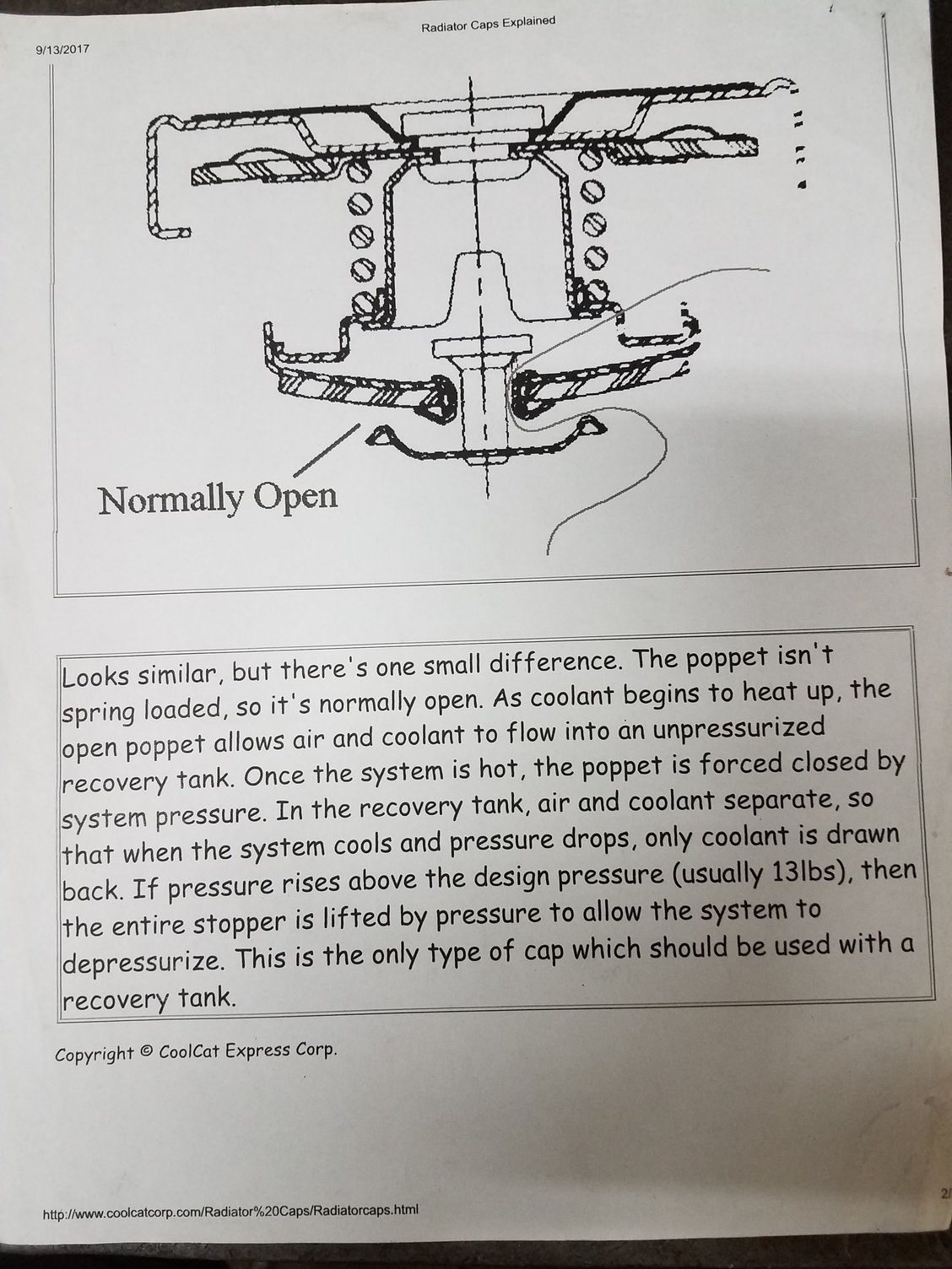

I borrowed my radiator shop buddies snap on tester. Cap holds nada. Its shot. Ill put it on the list.
Old May 19, 2020 | 01:42 PM
Big2Bird's Avatar
Big2Bird
Joined: Dec 2006
Posts: 8,837
Likes: 1,028
So when you visit your radiator guy, you get schooled on caps. Apparently this cap is for a reservoir system, which is missing. Reservoir on the list.
I included this.paper because it was informative.

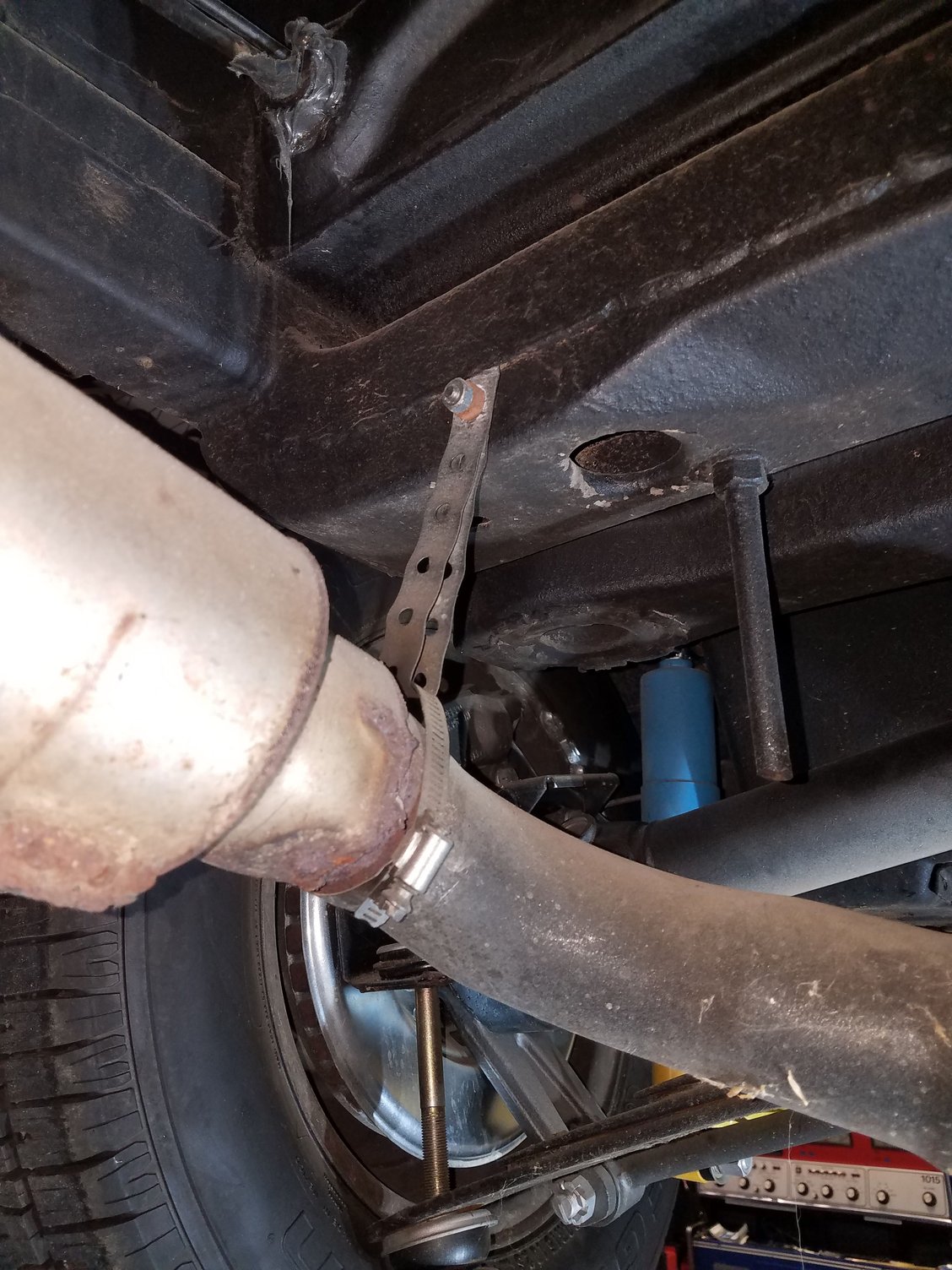

I do like the throttle cable bracket
To 73 way back machine
Old May 20, 2020 | 09:44 AM
Big2Bird's Avatar
Big2Bird
Joined: Dec 2006
Posts: 8,837
Likes: 1,028
Same manufacturer as the exhaust hanger I bet.
