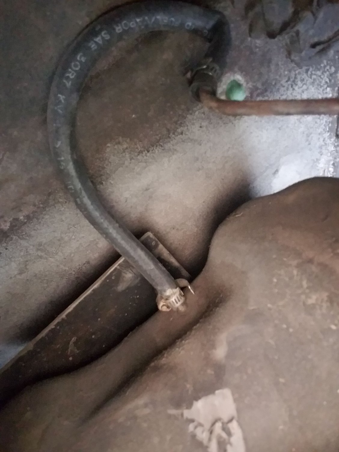

Looks like the return line is kinked.
Not surprised. The 3/8" fuel lines had 5/16" hose jambed on there.

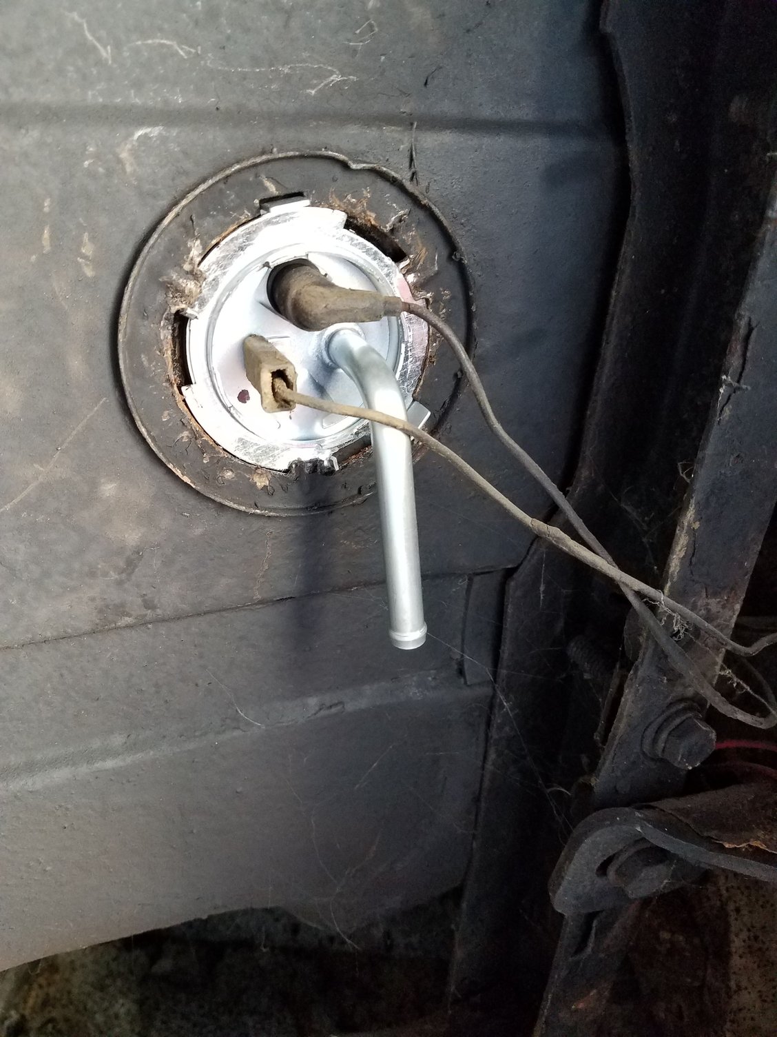

Corrected the fuel return line. Not easy without dropping tank.
Sender is in, but they cut the hard line. I will use my friends beading tool tomarrow, and do it right.
Installed the choke kit.
waiting on pump to finish hard lines.

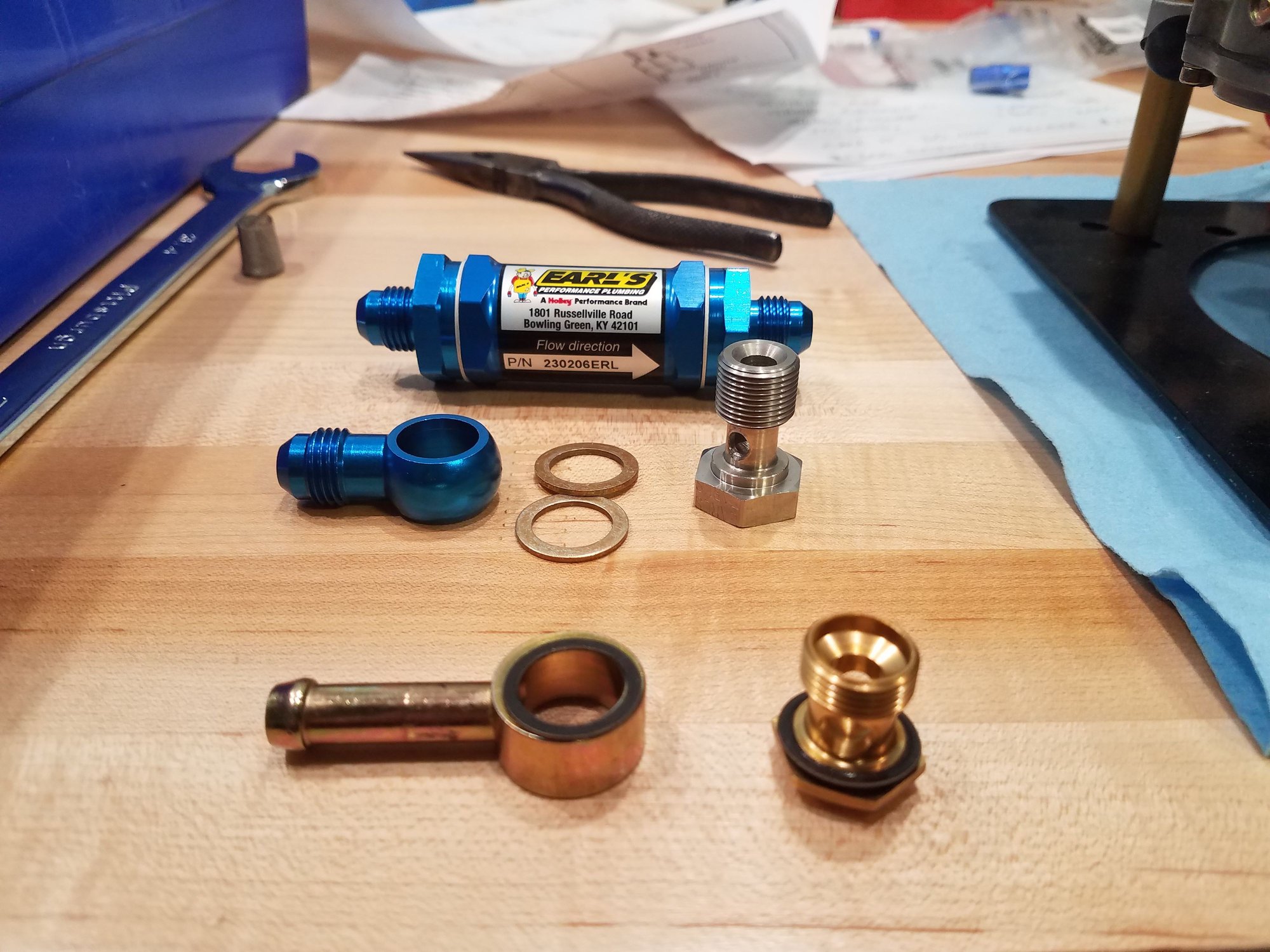

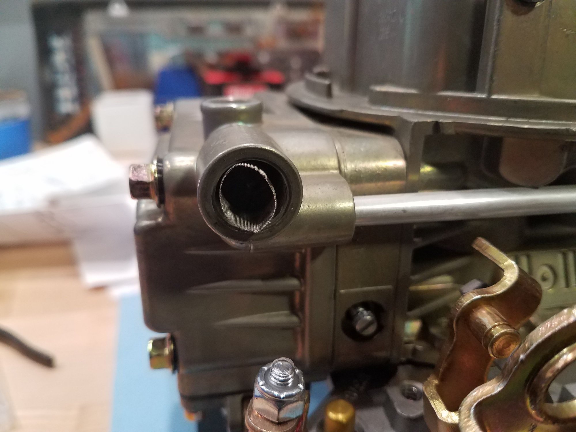

Lars hooked me up with proper fuel inlet to plumb hard lines. I ditched the screen in carb because it will not fit. Besides, I am installing an inline filter anyhow.

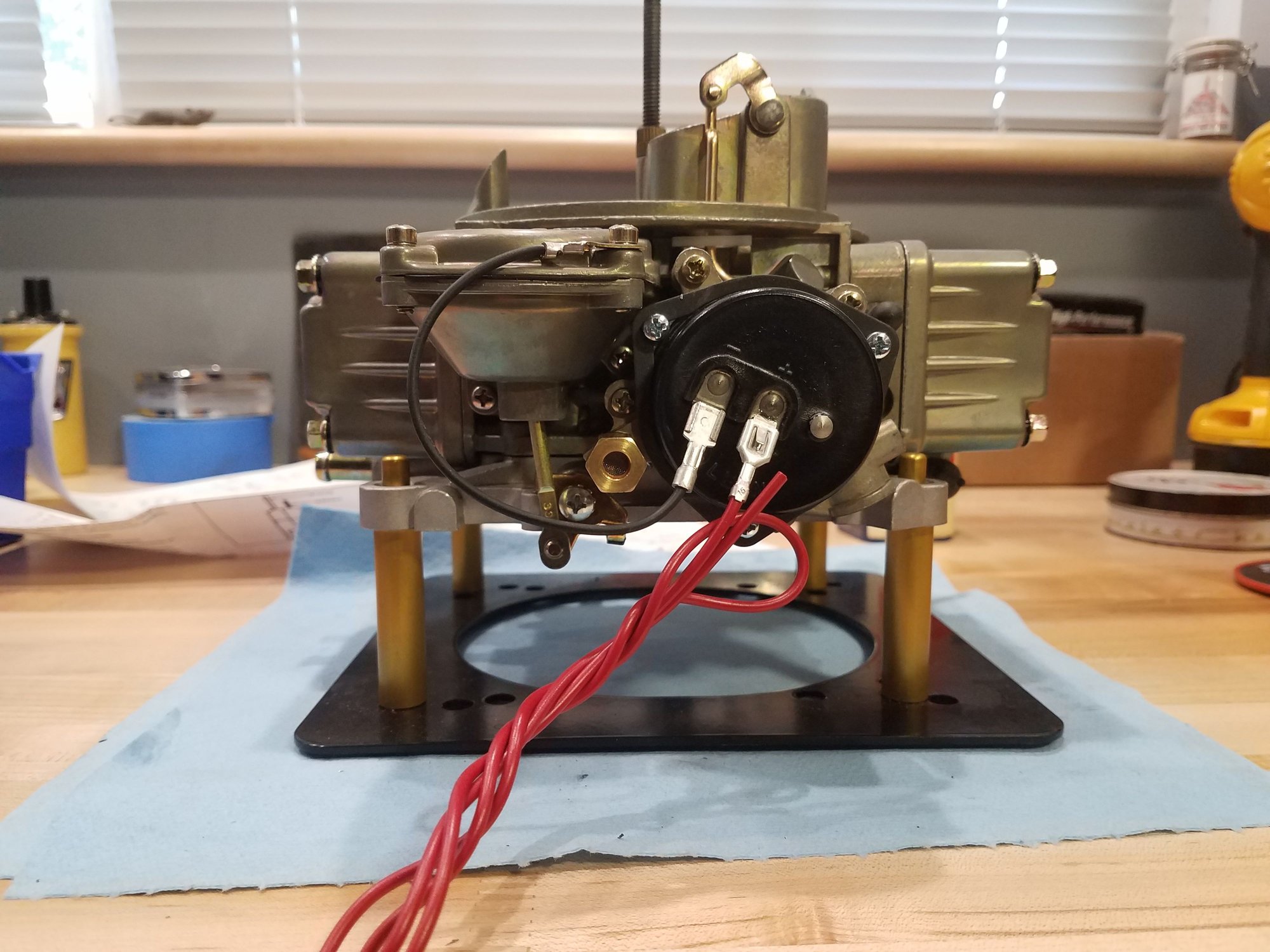

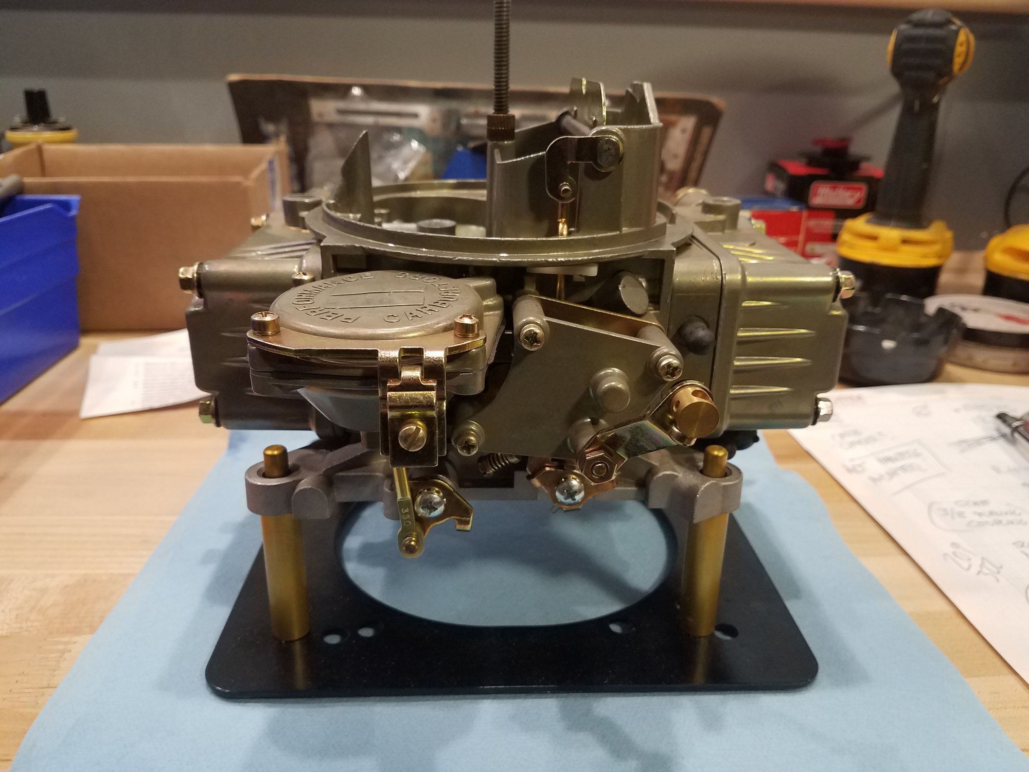

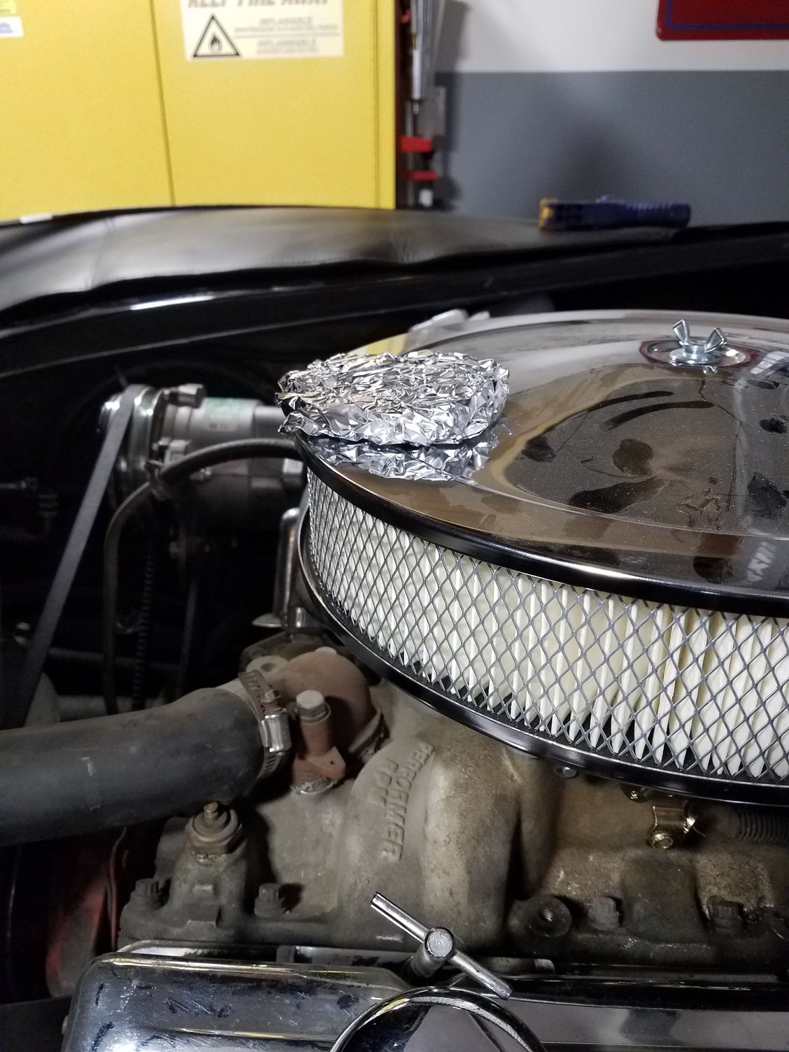

More better. Now I need carb studs, and need to see if I can use a thicker/ better gasket.

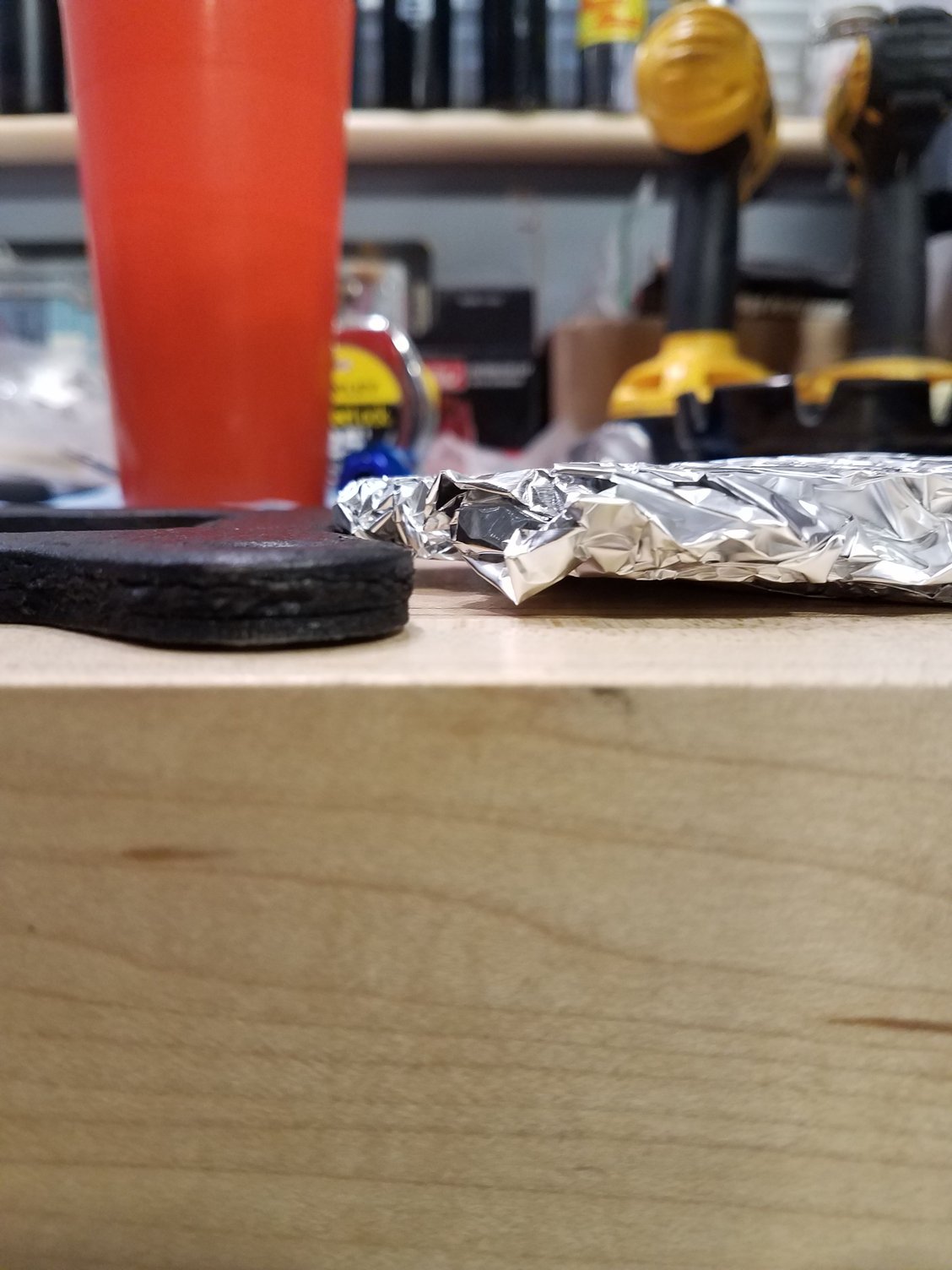

Gotta do the foil trick to check hood clearence to air filter.
How did you manage to do that?
Old May 24, 2020 | 03:25 PM
  #46
Big2Bird's Avatar
Big2Bird
Joined: Dec 2006
Posts: 8,837
Likes: 1,028
Small ratchet and by feel.

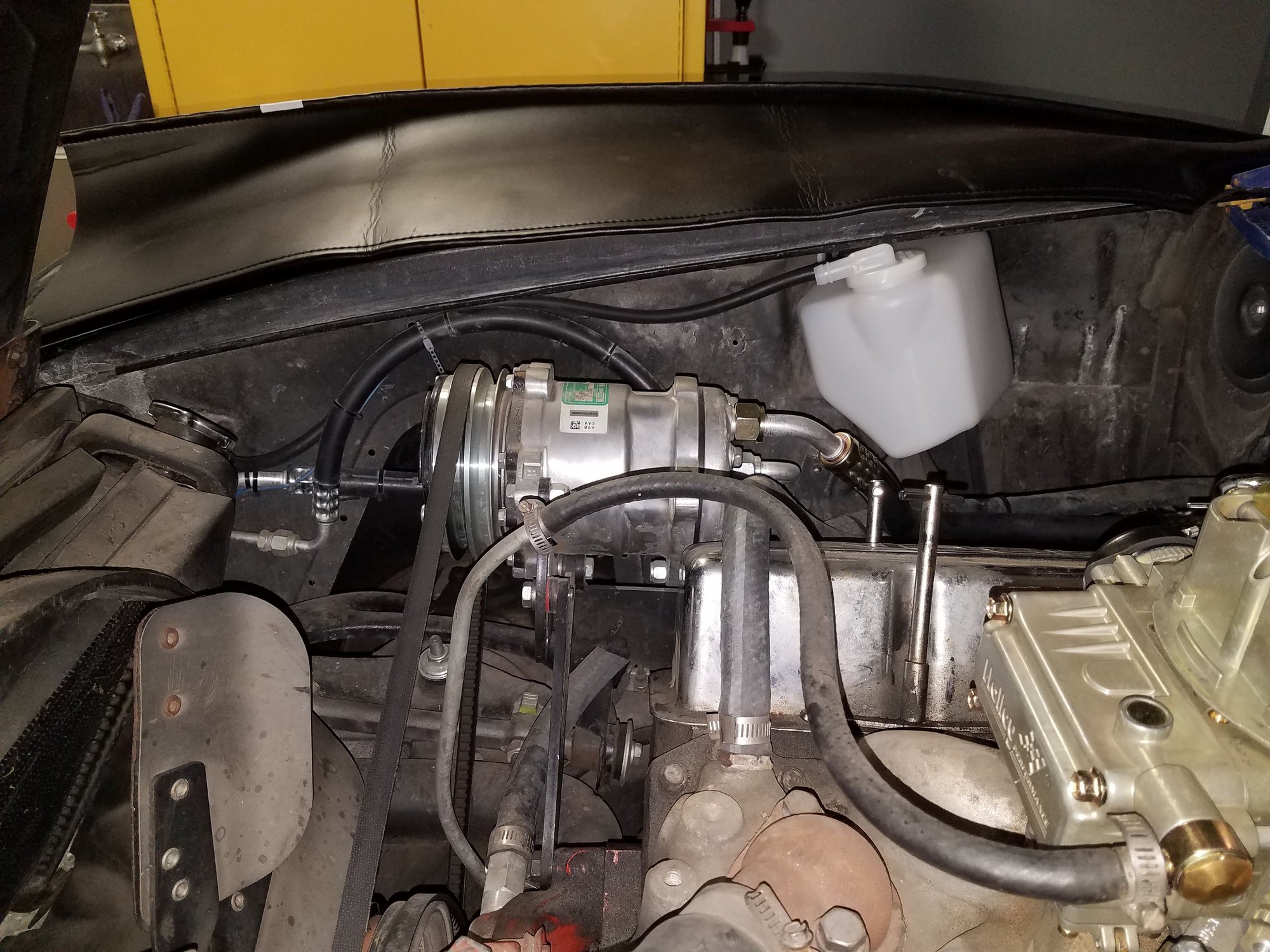

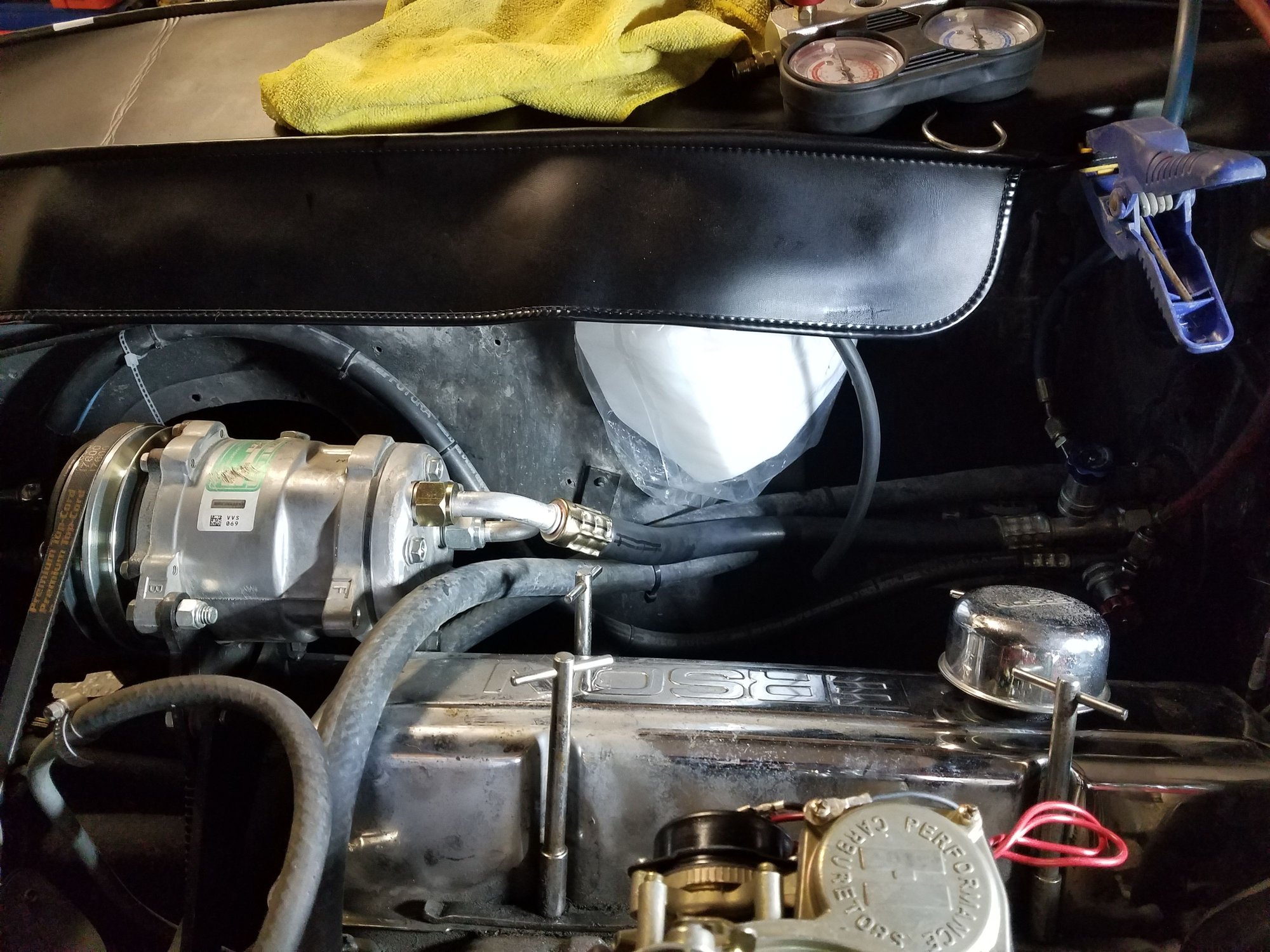

Monday my A/C guy came over. We bled the system, rerouted the hoses, and charged her up so I could install a reservoir.
Of course 73 is one year only, so I will shim the tank.
After 3 wrong caps, I bought one for an 81, and done.
Material is taking forever.

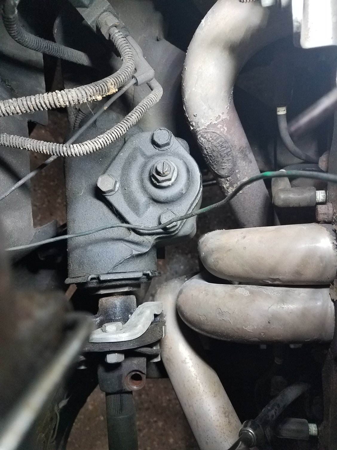

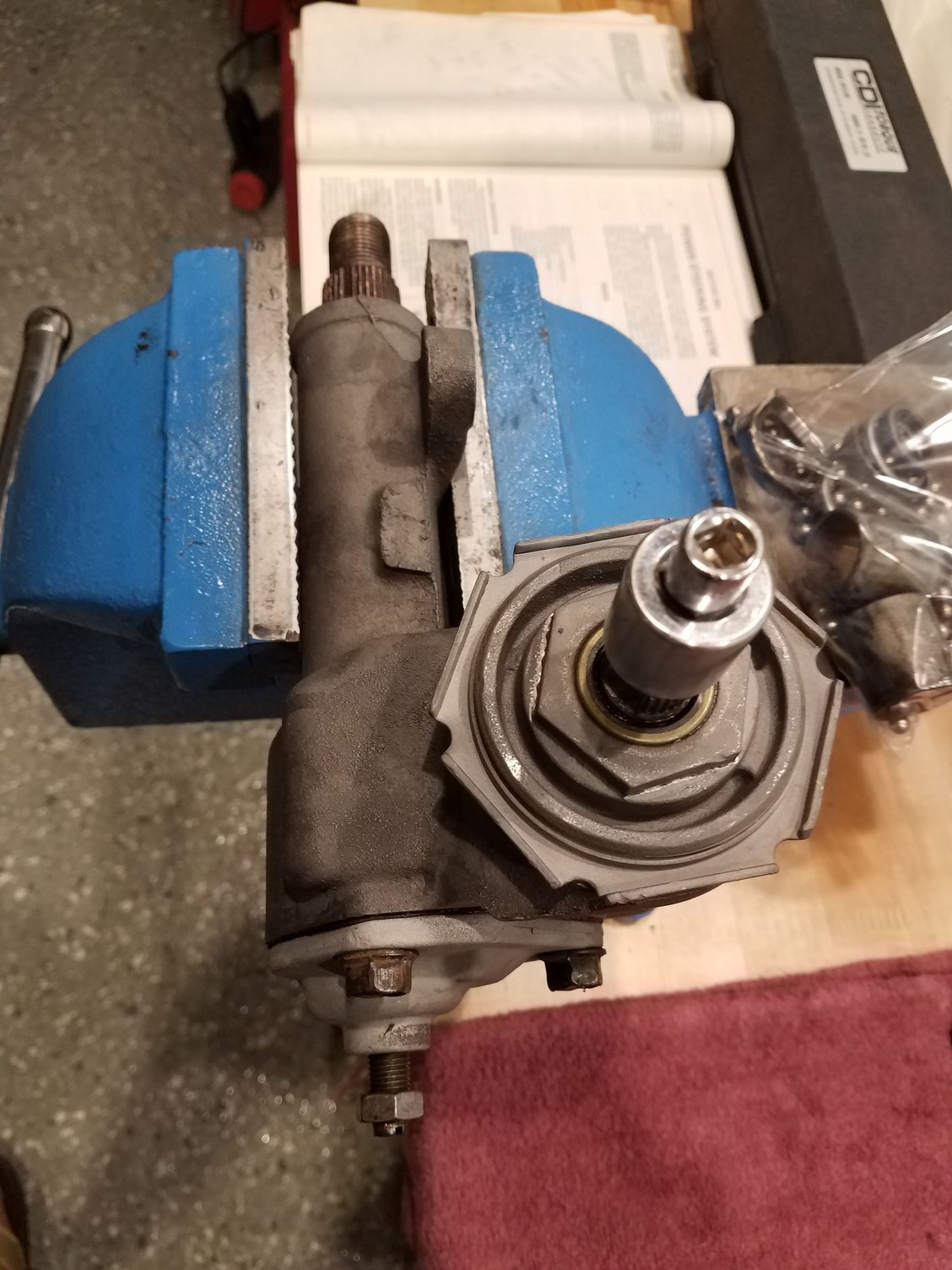

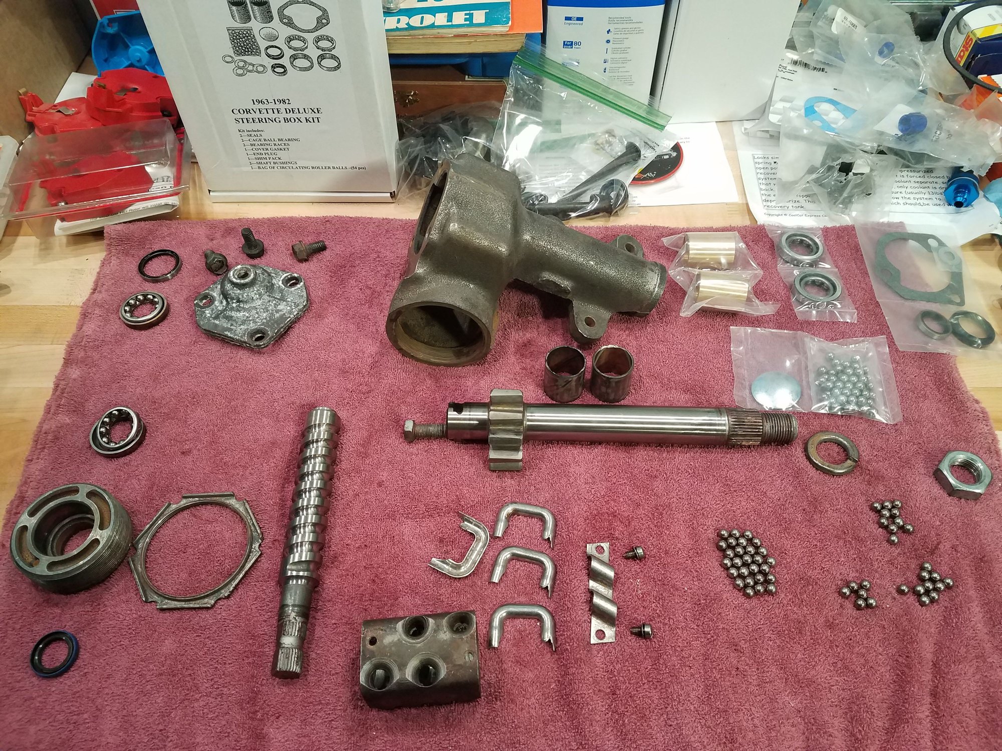

Tuesday I managed to give birth to the steering box without touching the headers. Soaked it in lye
overnight. Today I will blast it and install the kit.
The " rebuilt" box had two new seals and packed with grease. The bushings and bearings are original.
Buyer beware. Not all rebuilds are equal.

I'll set the preload and lash tonight, and paint it black.
The pitman arm nut is trash.
I found one on flea bay.
There goes another week.

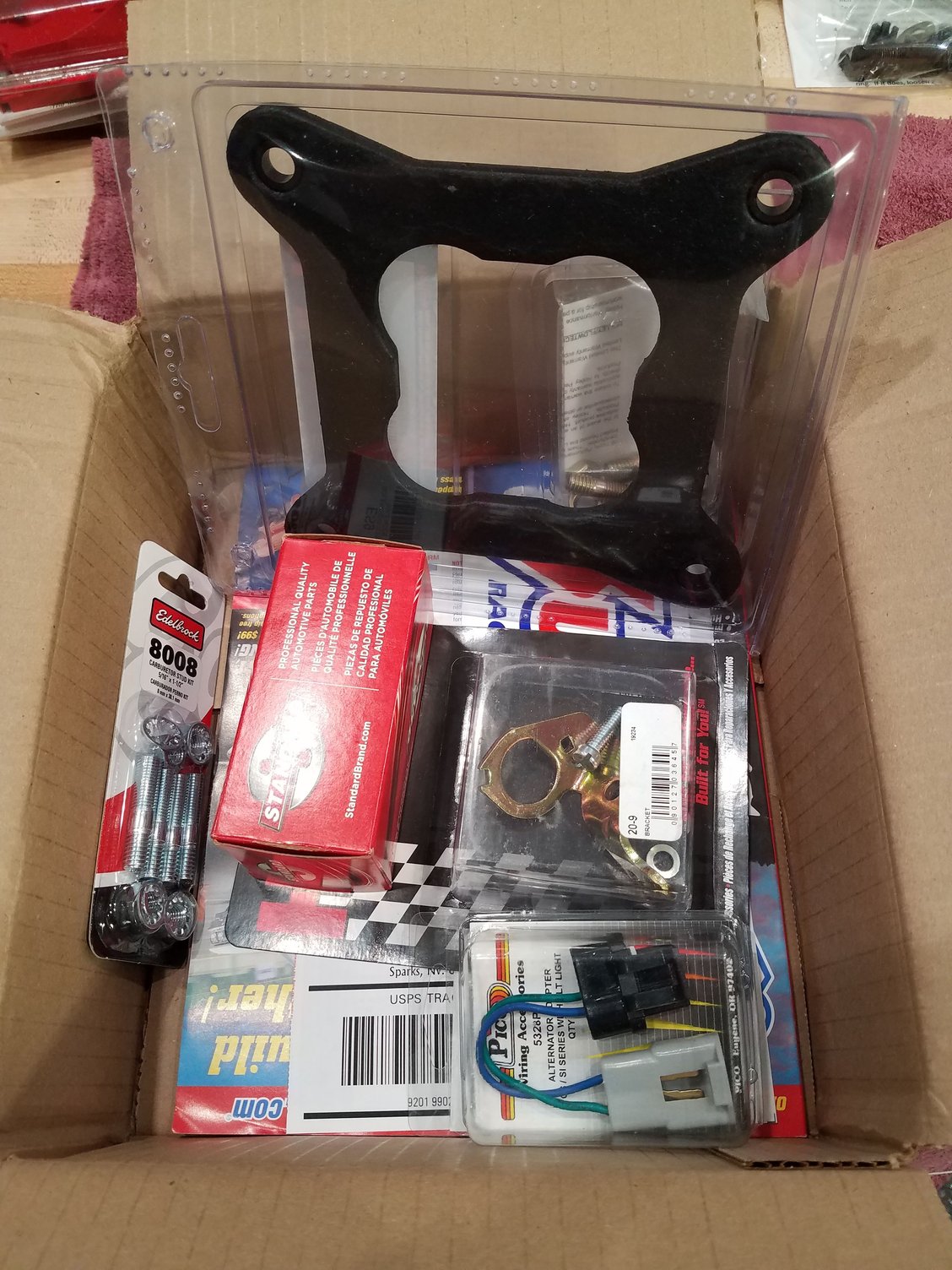

Parts are dribbling in.

According to my alumi gauge, the new heat spacer should just fit.
