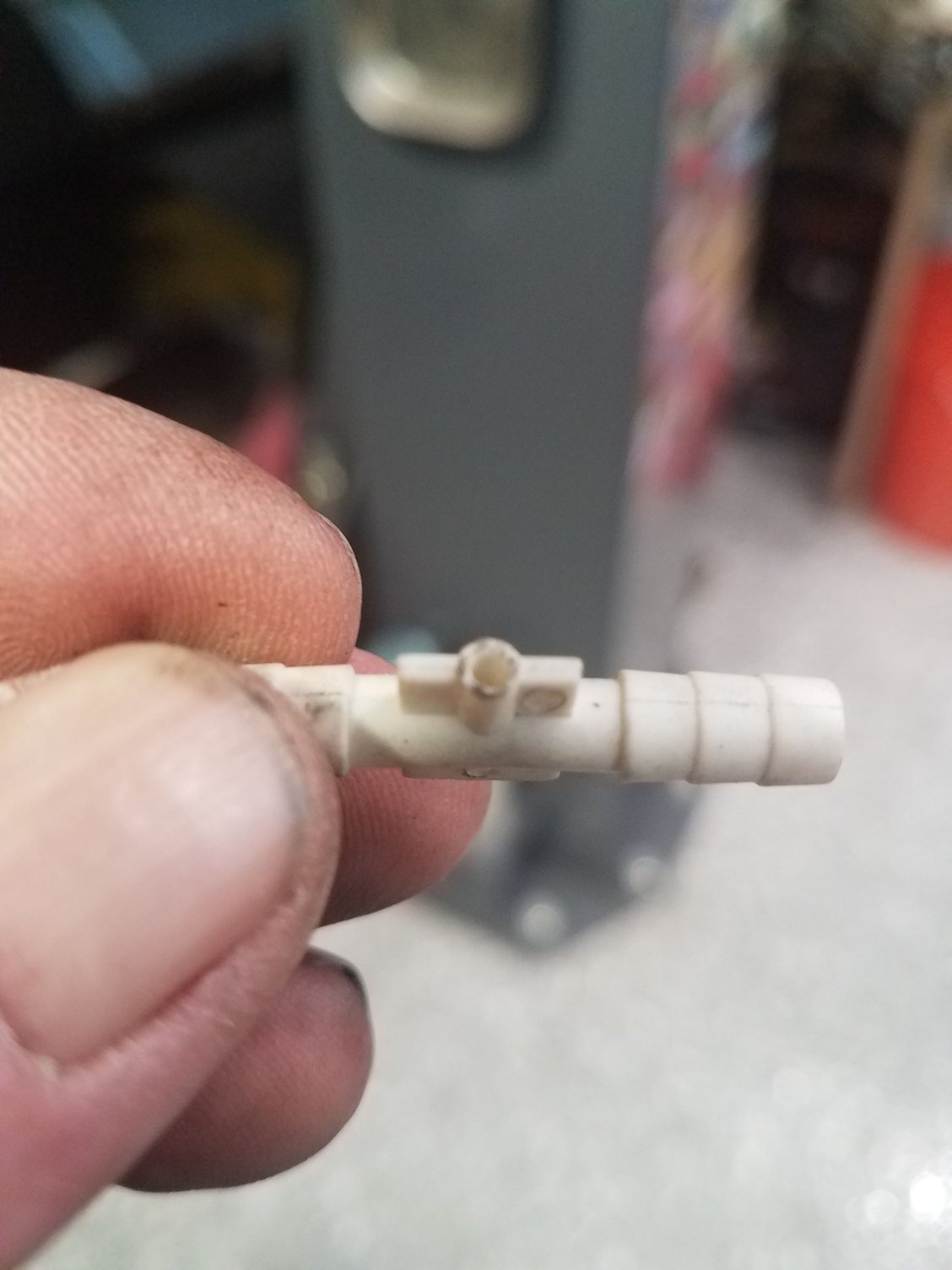

Found a tee snapped off.
Headlights now work and hold quite well.
Bypass does not leak, as there isn't one.
switch is quiet too.
Vacuum done.

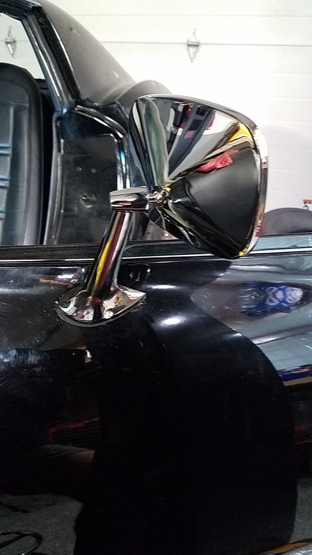

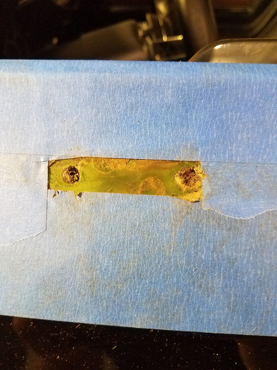

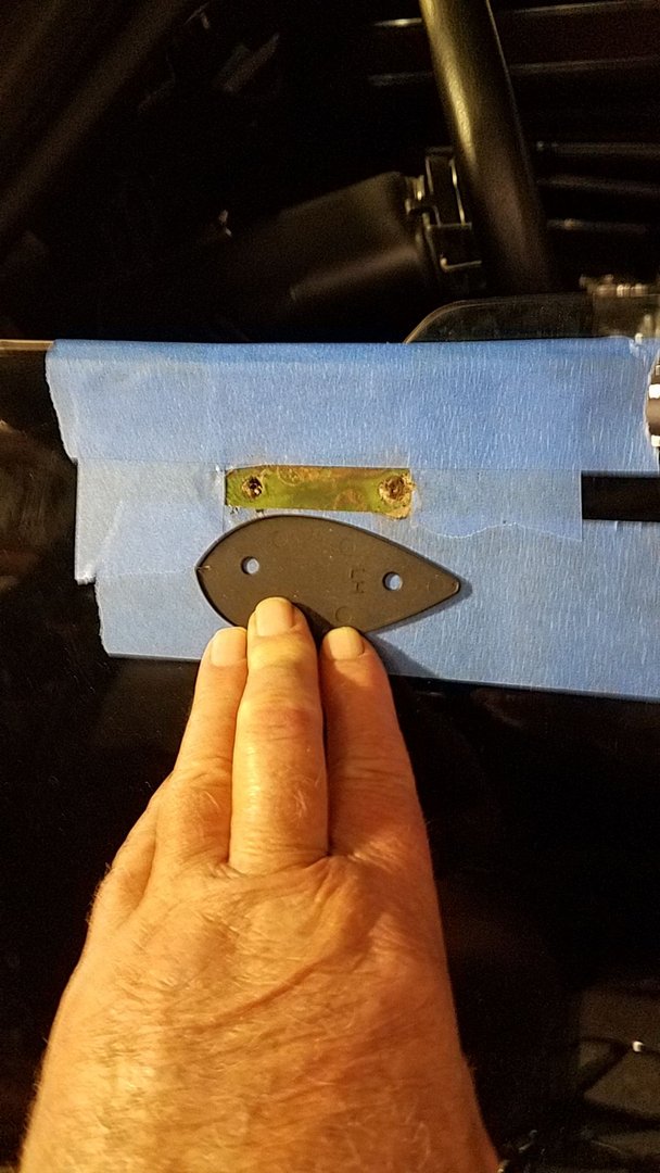

I had to drill the heads off the mirror basenplate to remove it and install the rubber cushion under the mirror. I managed to drill and tap new holes, so that's done.

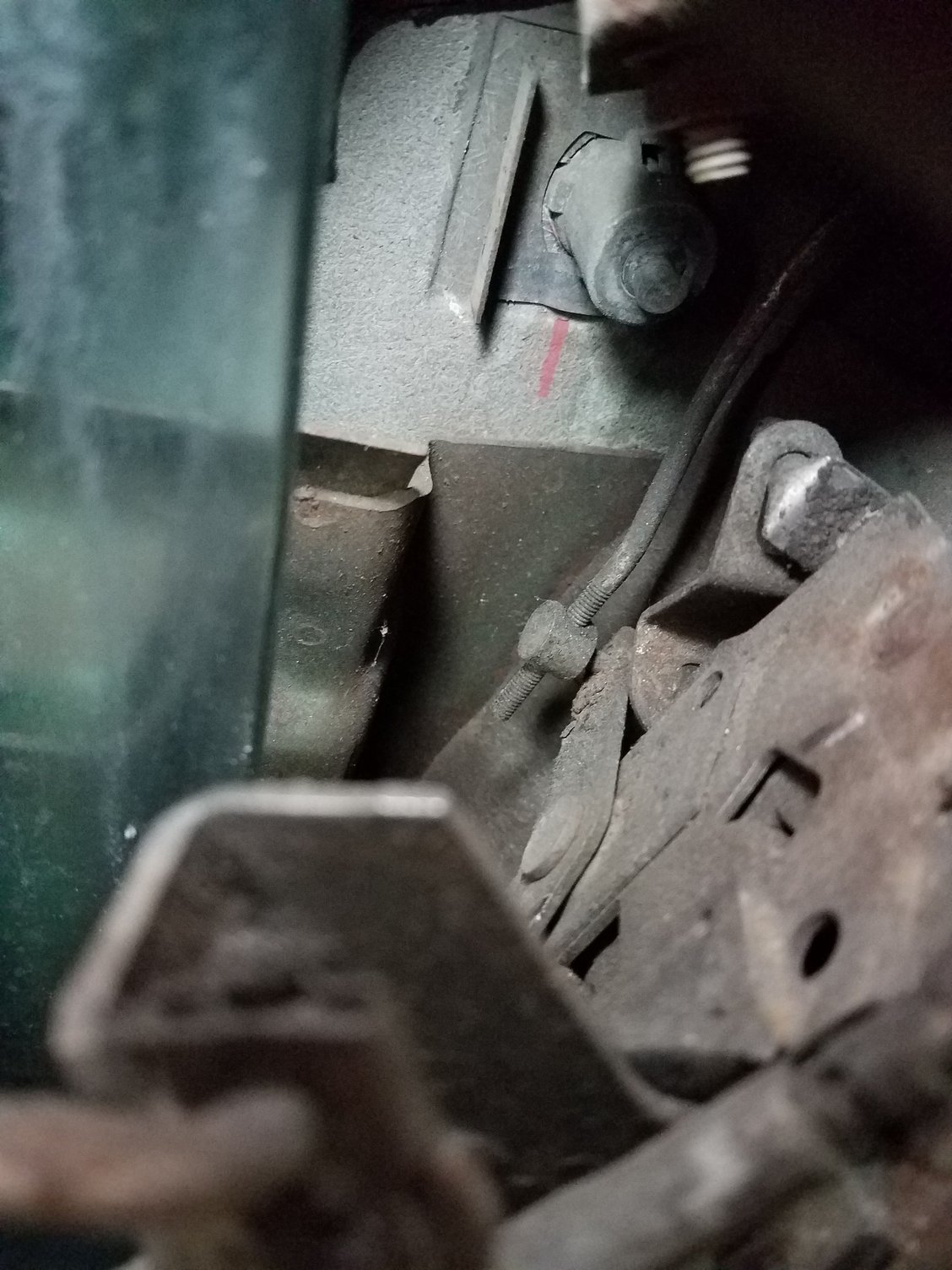

The pass side outside door handle does not throw enough to open.
That bent rod with the adjustable pin is shot. The threaded pin wobbles all over.
I think thats $10. No biggie.

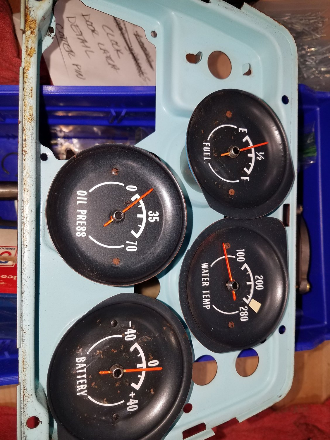

The new volt meter arrives today, so I pulled the center gauge cluster. That was fun.
The qtz clock he supplied is wrong year, so dial is green. I assume I can swap faces.
However the other gauges I question.
Old Aug 6, 2020 | 03:19 PM
  #247
Big2Bird's Avatar
Big2Bird
Joined: Dec 2006
Posts: 8,837
Likes: 1,028
The fuel gauge sits at 1/4 tank. Is that normal off?
The oil pressure does not sit at 0, and the temp gauge reads wonky.
My car, I would change them all , but his call.
I would hate to do this twice.
Gauges are $69@, and the correct clock is $170.
It would be nice to be done with it all at once.

We tested the other gauges. They are jacked up.
I will order new ones, the door latch, and latch rod. That should complete the known issues.

So far, two items ready. You can see how whako the old ones are. The temp spins like a Milton Bradly game board. Wished I had caught that sooner.
The oil reads high. I hope the new one doesnt read 20lbs.

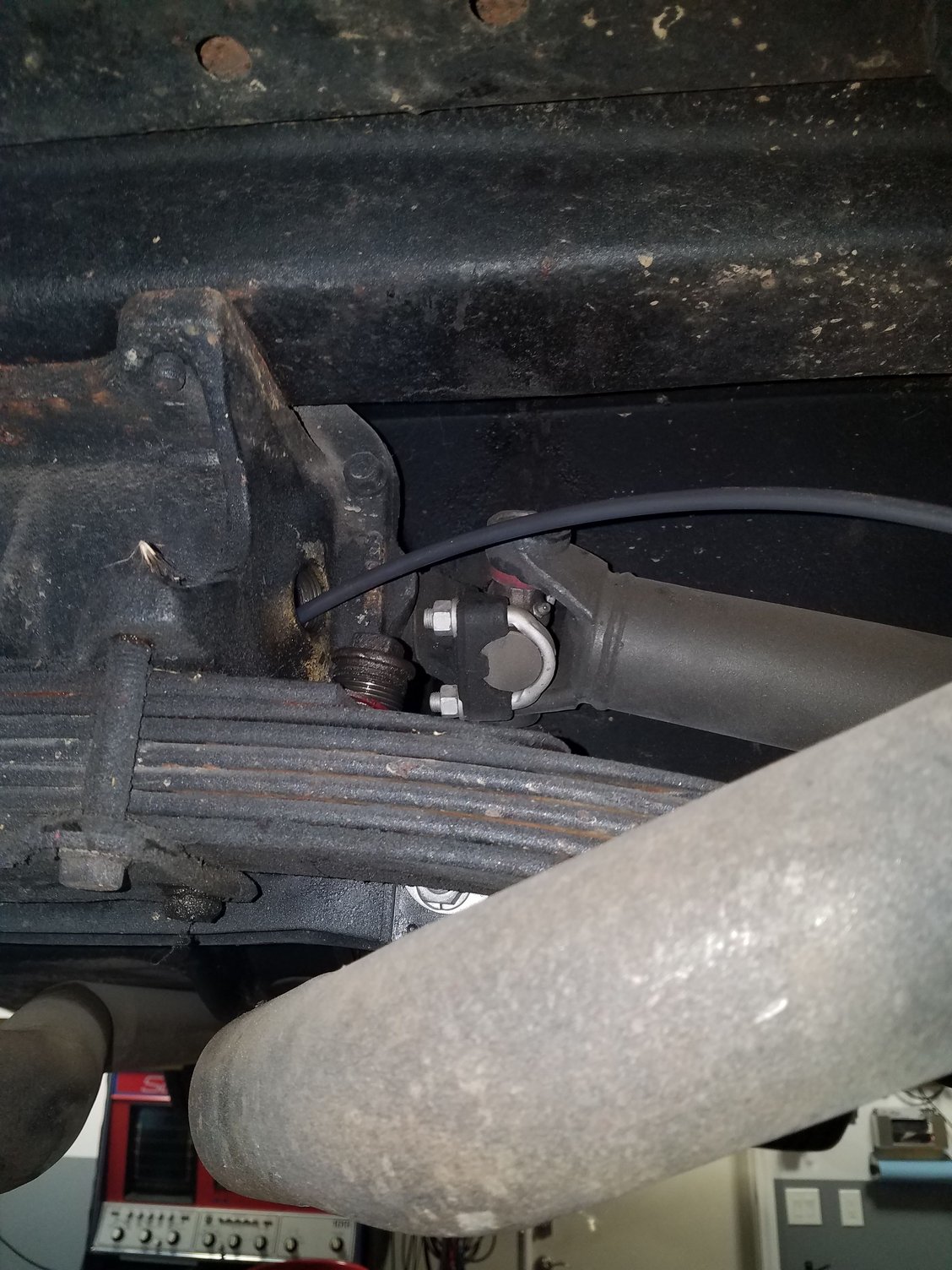

Is there a bullet proof oil gauge line?
Special tubing?
Old Aug 7, 2020 | 12:39 PM
  #254
DC3's Avatar
DC3
Joined: Apr 2001
Posts: 2,030
Likes: 363
From: Lubbock Texas
Special tubing?
When my plastic line broke years ago, I replaced it with a nitrous oxide hose. You have to source some fittings to adapt the hose. I've long since converted mine to Autometer gauges but I may have a pic of the hose and fittings. If you think it would help to have the pic, I'll look for it and post it.
DC
Old Aug 7, 2020 | 12:45 PM
  #255
Big2Bird's Avatar
Big2Bird
Joined: Dec 2006
Posts: 8,837
Likes: 1,028
I just found a ss braided an line with fittimgs for $30 shipped.
Old Aug 7, 2020 | 07:56 PM
  #256
Big2Bird's Avatar
Big2Bird
Joined: Dec 2006
Posts: 8,837
Likes: 1,028
https://www.ebay.com/itm/60-Gauge-Li...72.m2749.l2649
I figured that was a fair deal. The line is 55 years old.
The owner says he uses 20-50. That must be why the oil pressure pegged. I will try some fresh 30wt VR1. I bet it settles down.

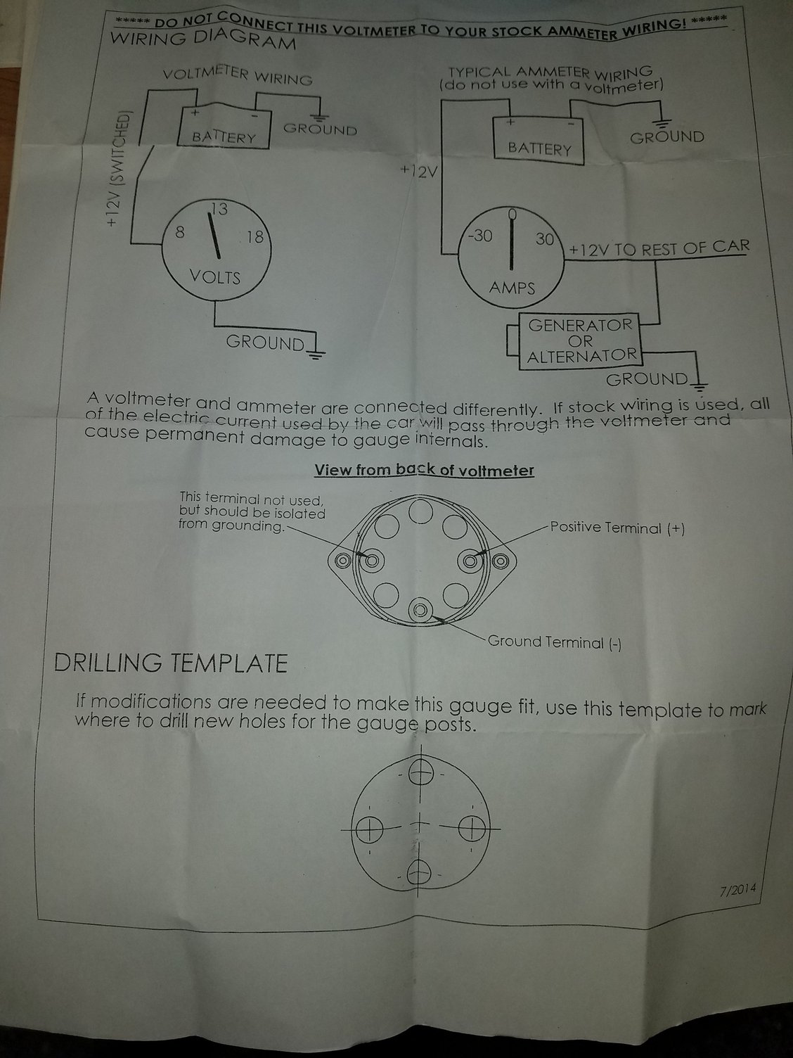

So while I am changing all the lubricants, and the car is in the air, I will take the ammeter lead off the starter, and swing it onto the ground post. That solves half of the wiring change to volt meter.
The other lead is on the positive post top side. Have to find a keyed hot for that upstairs.
