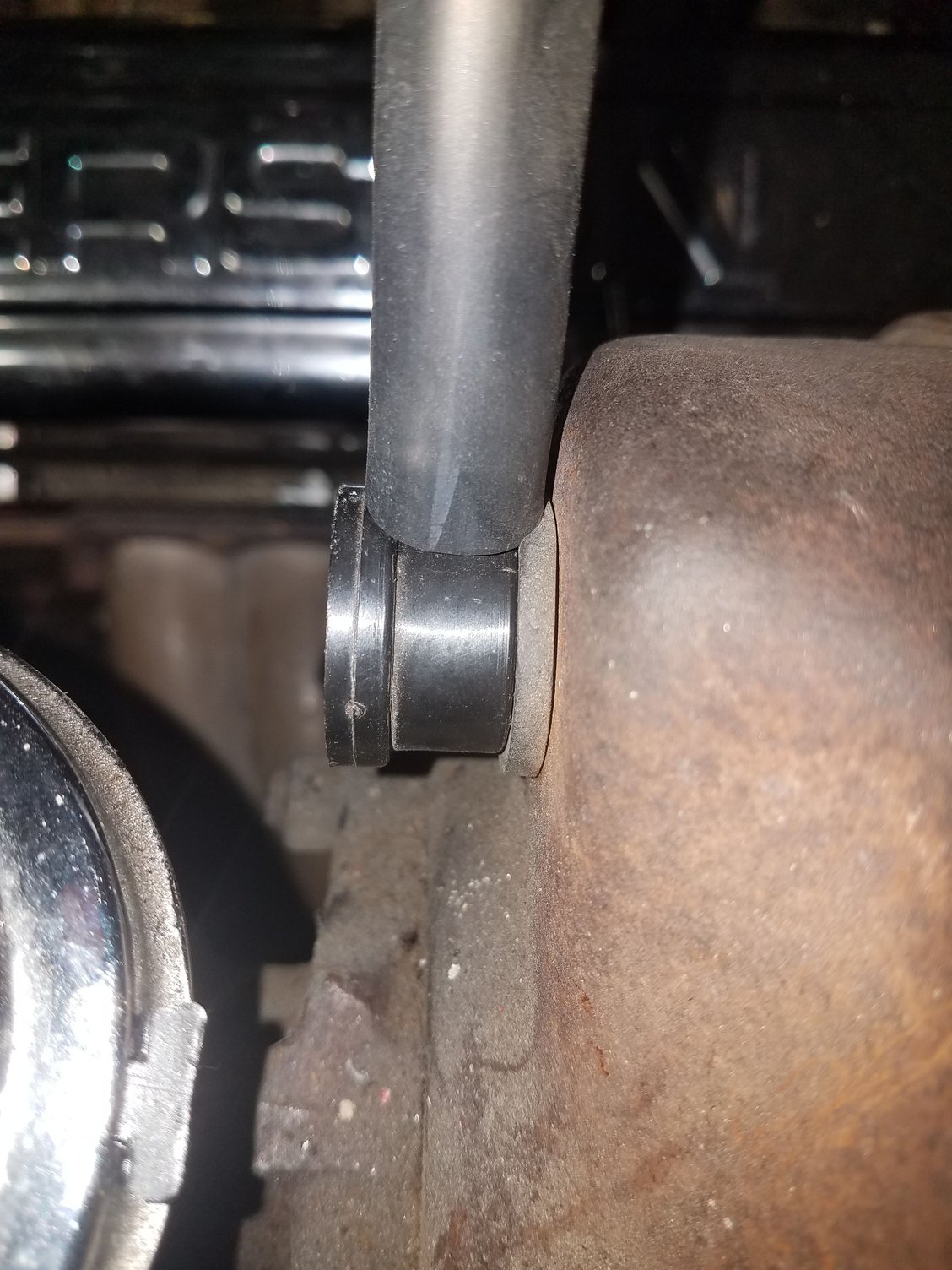

Looks like the air cleaner may just miss.
I could use a thicker base gasket, but the hood will hit. I will just keep an eye on it and see.

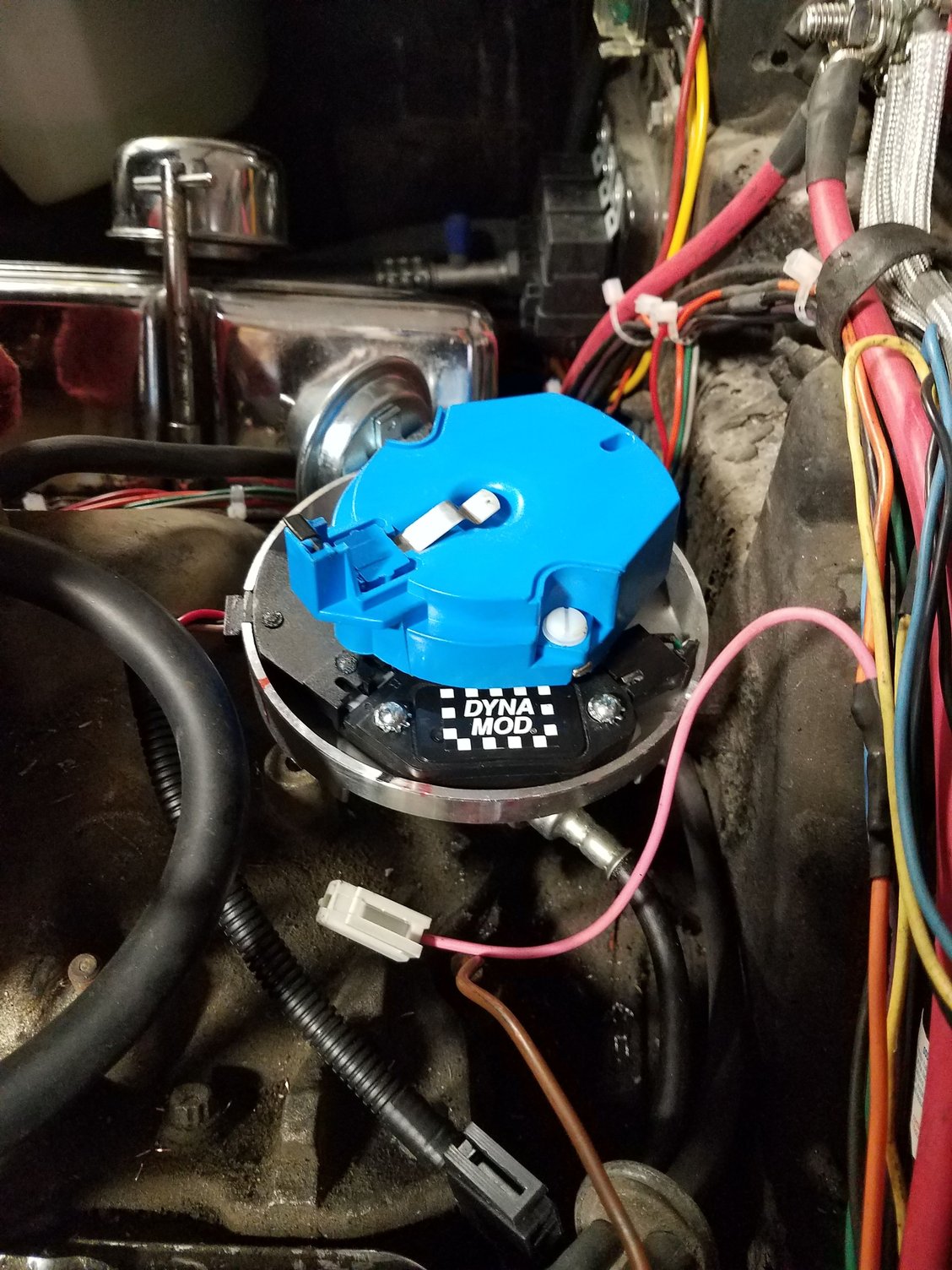

Originally Posted by 71chimera
curious, does the dui hei have a noise cap in the harness ?
Yes. Inside, just like GM.
This is a Letric limited harness, but same deal.

I appreciate the search and thought. I measured again, and if it's clocked close enough, I think it will squeeze by for now.

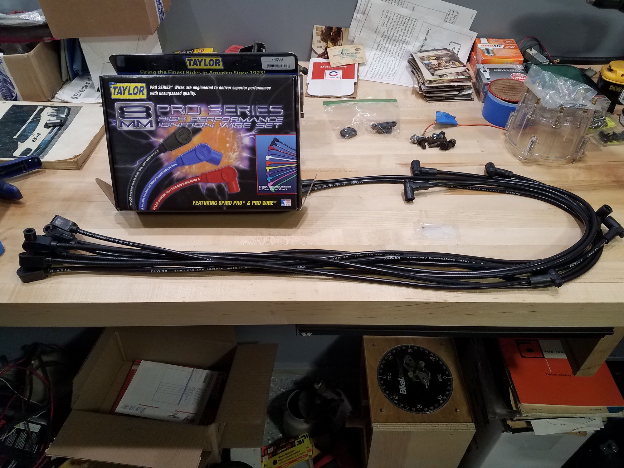

So yesterday, I went to work on plug wires, and got a call for free breakfast. Who turns that down?

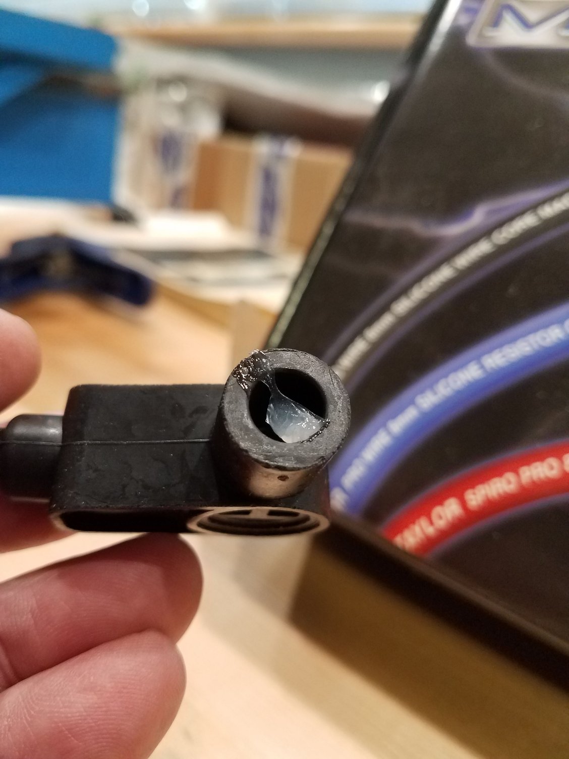

Came home, and ran the plug wires. They WERE underneath, so I bought a stock Vette Taylor set.
Numbered them up on the bench, a dab of silicone grease in each plug boot, and laced them up underneath.

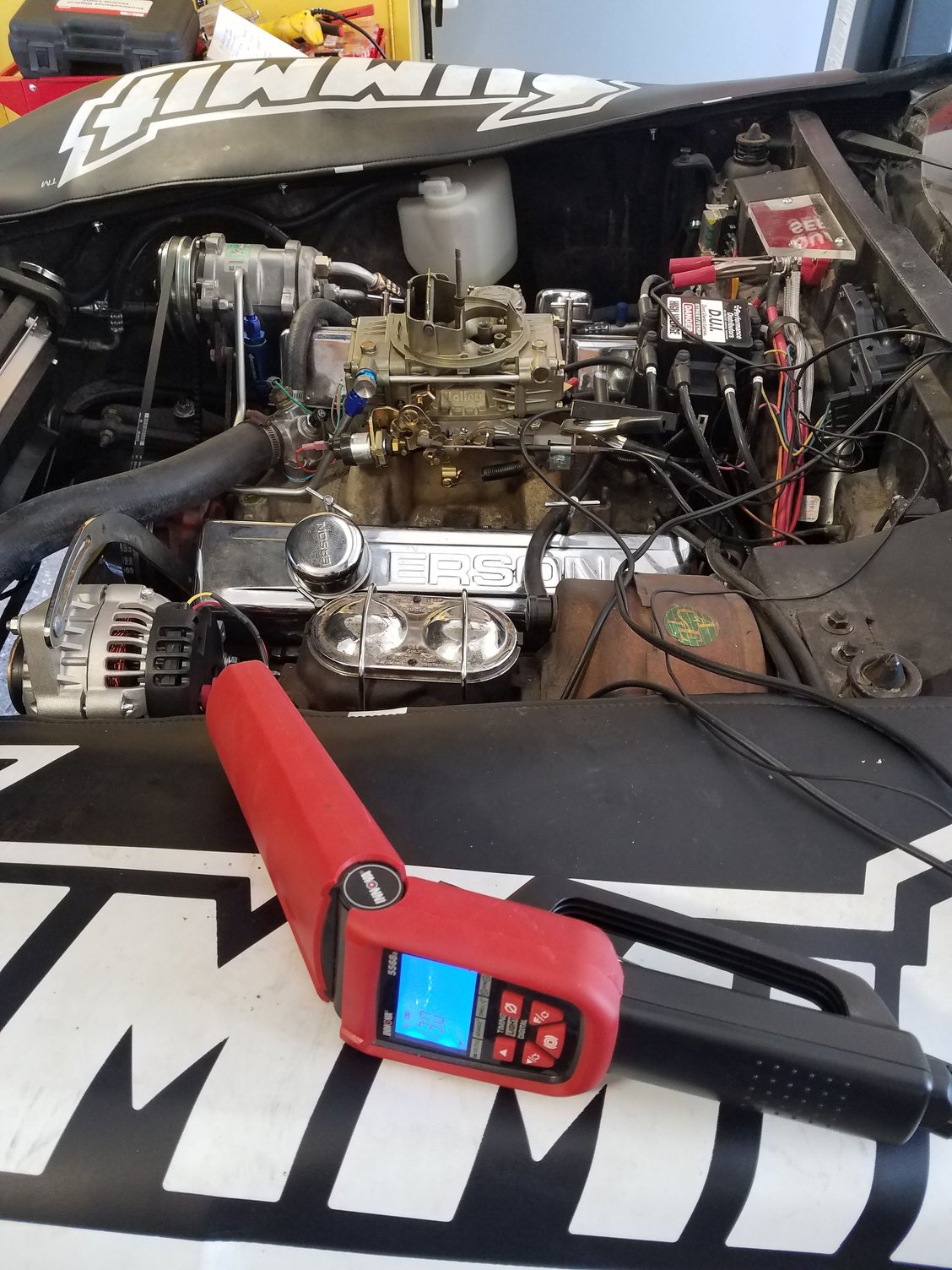

So, today, I know what calamity of events caused what.
I capped off all the vacuum, reset the choke to try another postion, plugged in the vacuum advance, pump the gas once, and varoom.
Instant start and smooth idle.
Tweek timing 2 degrees, and she is happy.
36* at 2800 rpm, 18* at idle. Add vc, and I get 28* at idle after start, and 46* at cruise.
The batt post at top makes a light easy.
If it was mine, I would also jump the purple wire on a button here to bump the starter over.

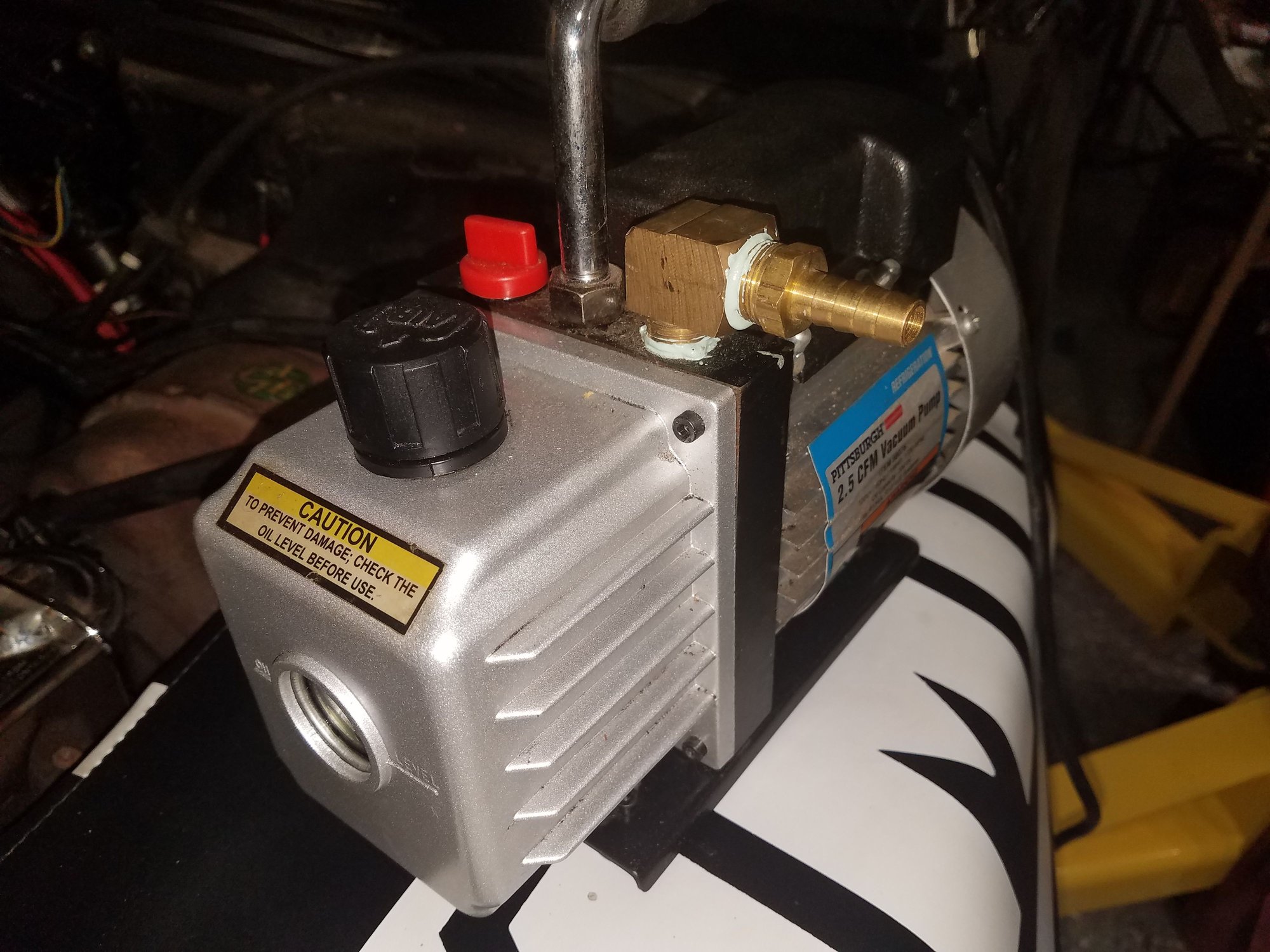

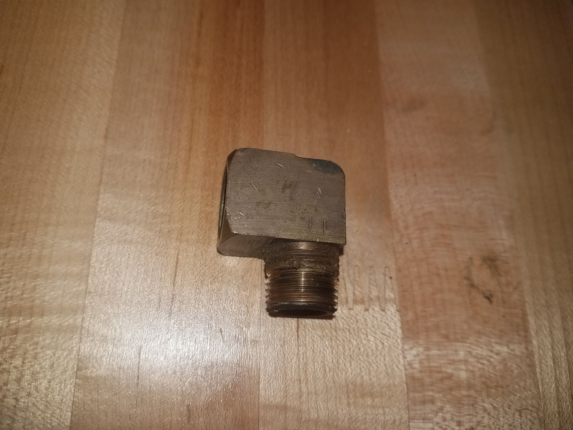

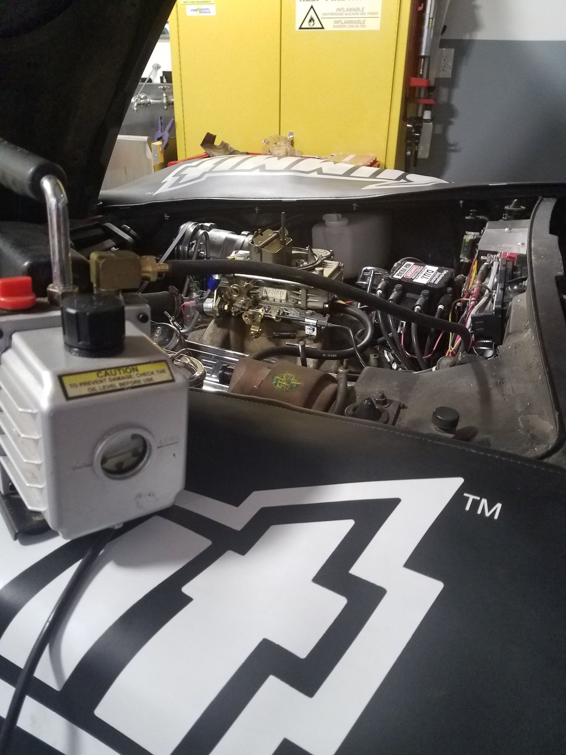

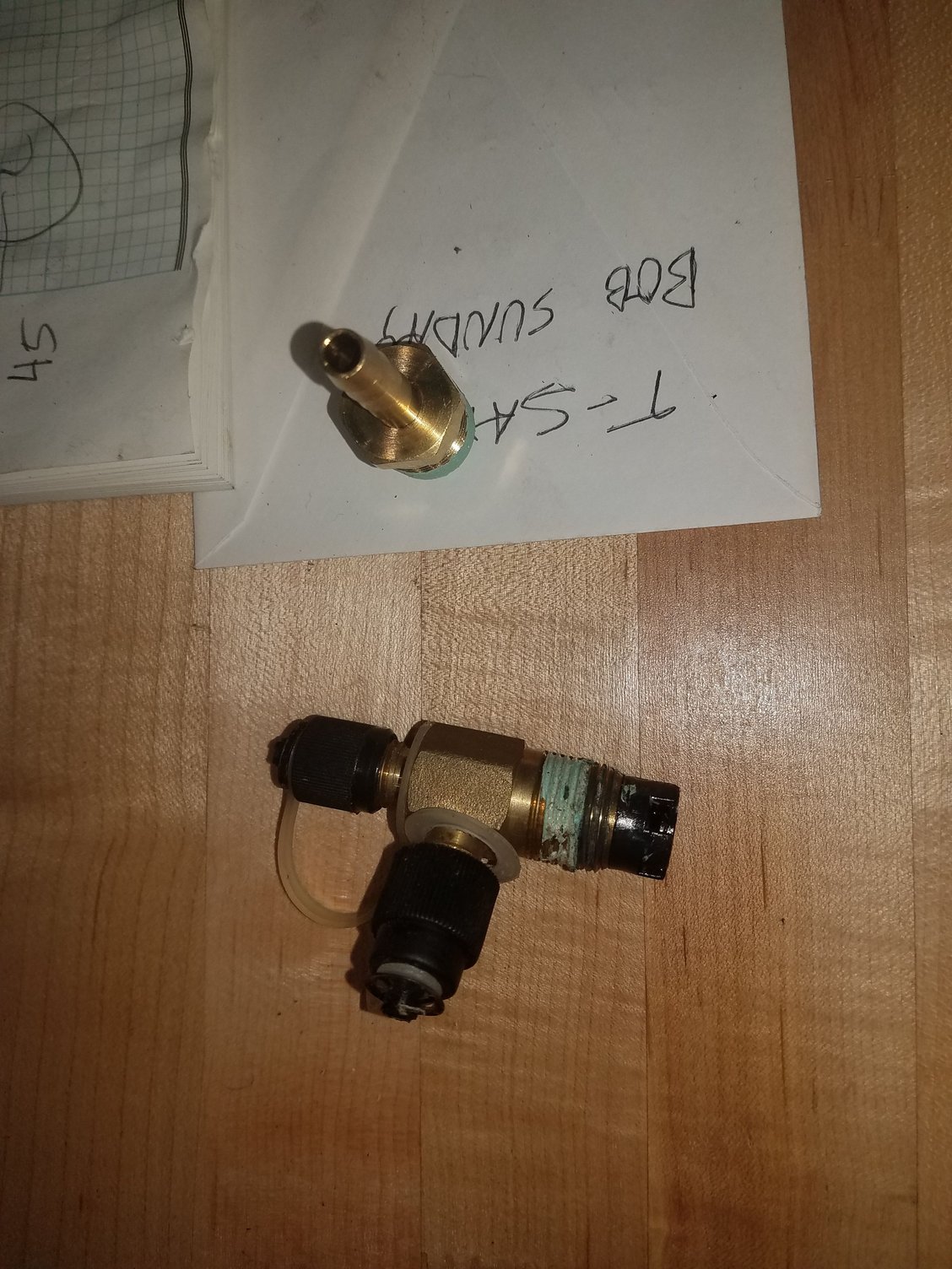

Today I want to go thru the vacuum systems.
I have RobinAir gauges and a HF vacuum pump for A/C work, but I did modify it for this use.
It comes with a freon type schrader port, and to change it, you have to remove the handle and switch cover.
A brass 90* 3/8" npt solved that.
With a variety of 3/8" x barb fittings, your good to go.
To 73 way back machine

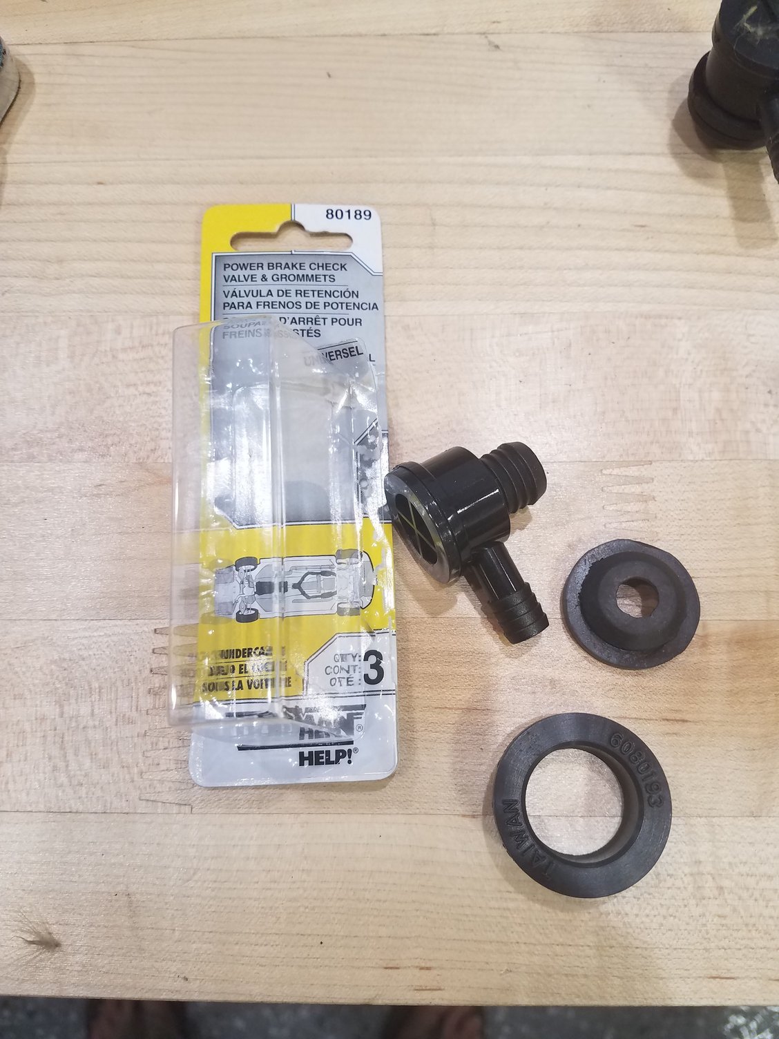

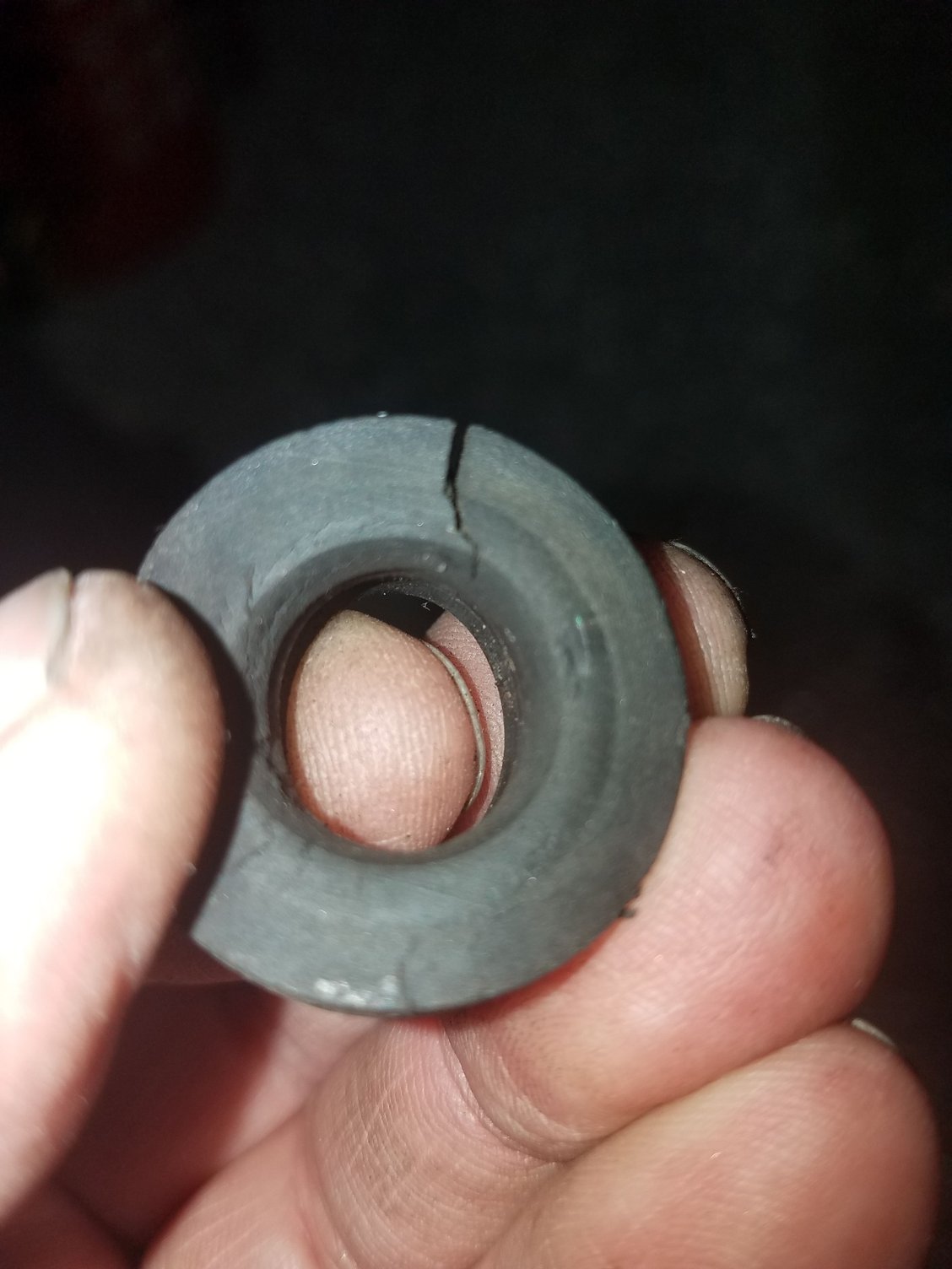

Right off the bat, the booster grommet is hissing. I will pull this apart, try some silicone grease. It is a fairly good amount of leakage.
Old Jul 30, 2020 | 11:08 AM
  #239
Big2Bird's Avatar
Big2Bird
Joined: Dec 2006
Posts: 8,837
Likes: 1,028
Of course its cracked.
Off to the parts store.
Be VERY carefull when installing. If it falls inside, shut the door and go in the house, and pour a drink.
Old Jul 30, 2020 | 12:19 PM
  #240
Big2Bird's Avatar
Big2Bird
Joined: Dec 2006
Posts: 8,837
Likes: 1,028
$5, and fixed. The hose was also a few milimeters too large, so I installed a worm drive clamp.
Now it holds vacuum.
On to headlights.
Much easier like this with the engine off.
Almost always the bypass valve hisses.
Tough to find with engine noise.
