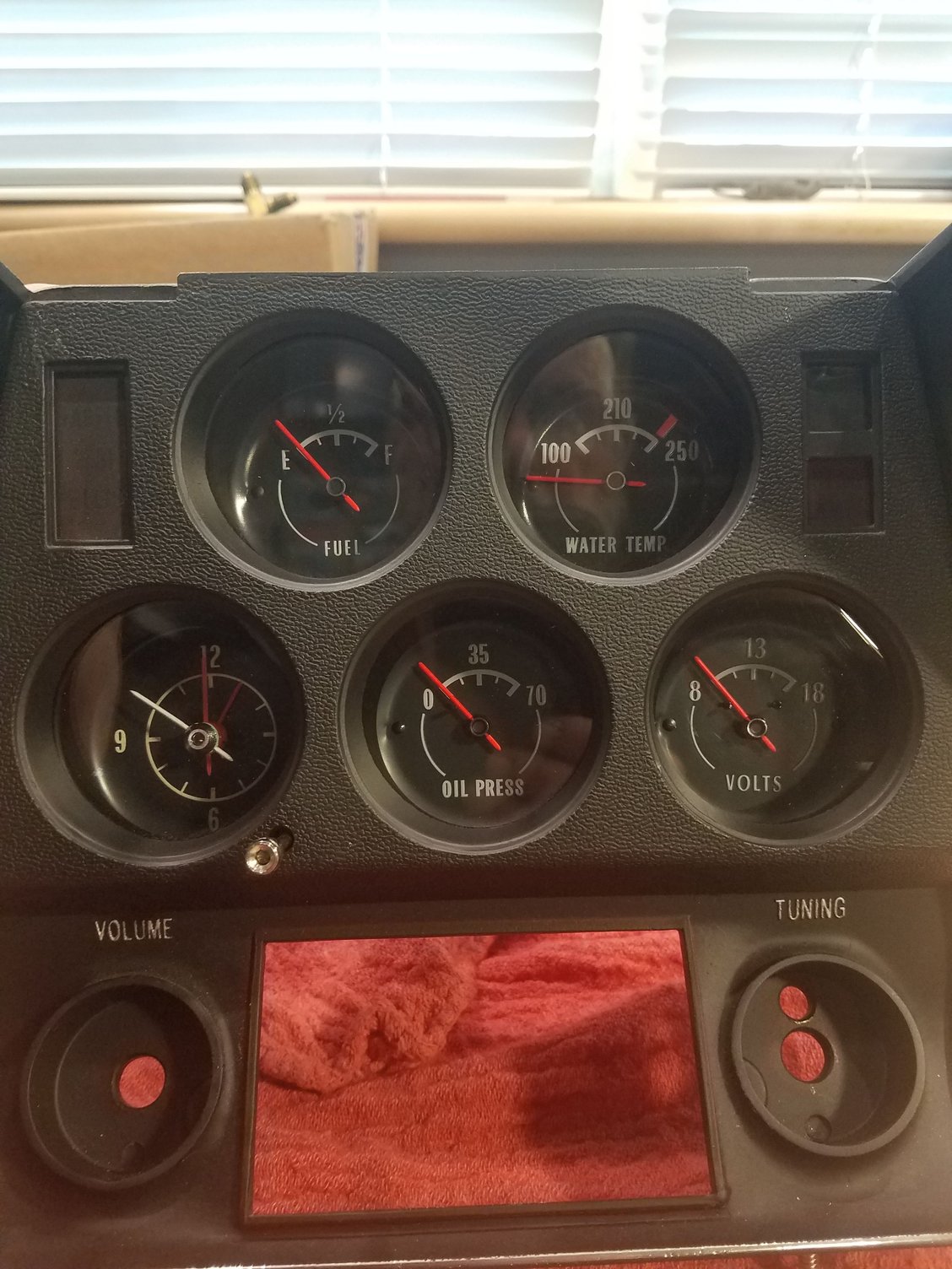

All new gauges just showed up.

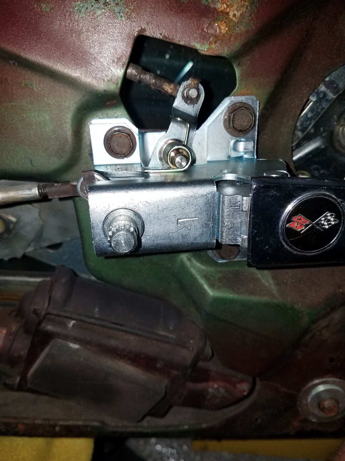

I think the hardest part is getting the handle on after the door panel.
Other than that, pretty easy.

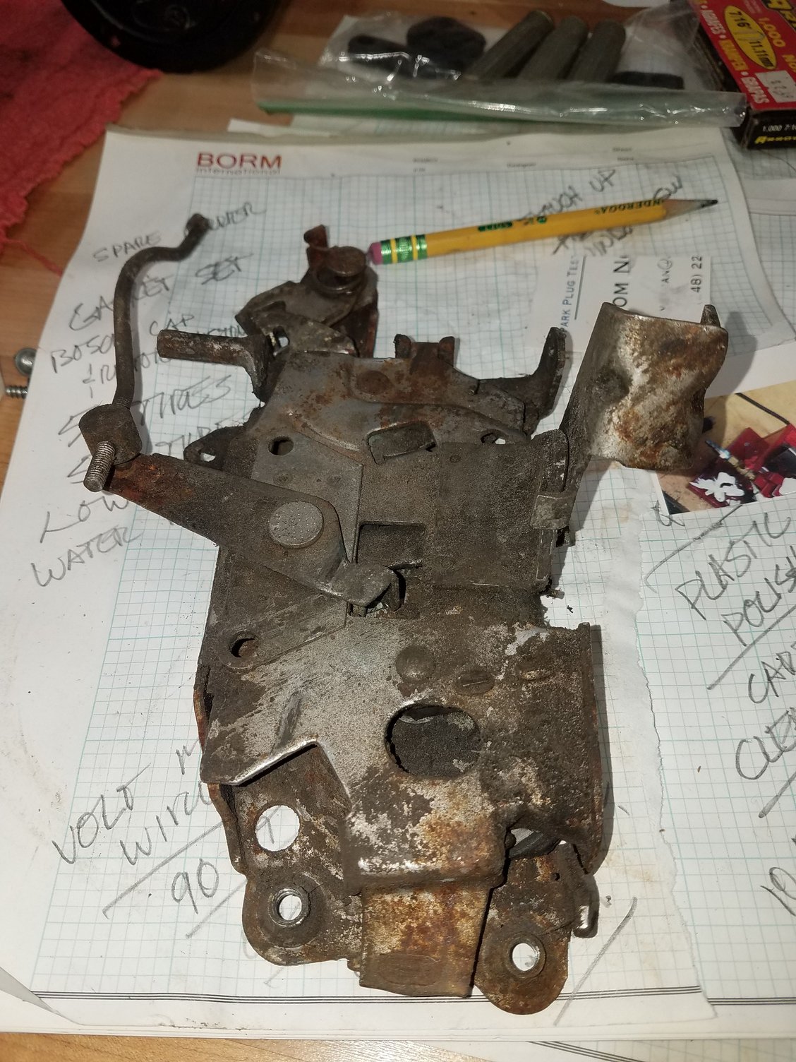

This is ready to go when I get the oil line parts.
I have the door lock soaking in lye for the night.

Follow the directions. The resisters are not used. You have to drill new 1/4" holes for the volt meter.
I modded the ammeter tabs for the new connections.

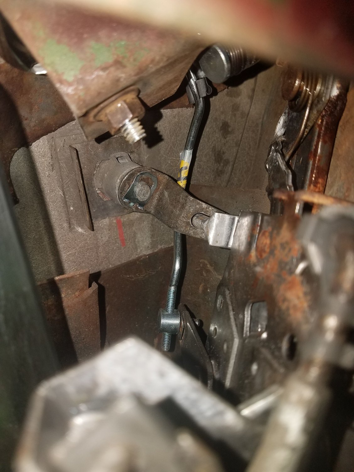

Old Aug 12, 2020 | 02:55 PM
  #268
Big2Bird's Avatar
Big2Bird
Joined: Dec 2006
Posts: 8,837
Likes: 1,028
An overnight soak in Purple power cleaned it right up.
A trip to Corvette Mikes got the lock pawl clip.
I had to pull the lock to assemble that.
Had to pull the outside handle to install the new rod and pin.
Now to crawl into the door to finish.

Done. Twice. I had to replace the outside handle. It was worn just a tad too much to get enough throw.
Cleaned and lubed the window tracks.
Closing in on it.

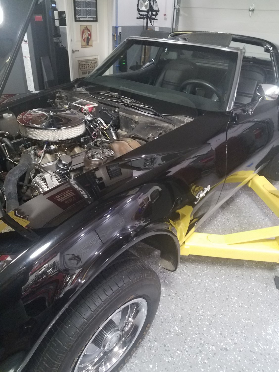

Almost done.

Done. Gauges work great.
Driving it hard gets it up to 220*
160 stat, so the old Big Block radiator is clogging up.
I see a De Witts in it's future.
Drives like it has 411 rear gears. Freeway its screaming.
Oil pressure is 35 lbs, 10 at idle hot.
I told him go 40 wt next time.
On to the next car.

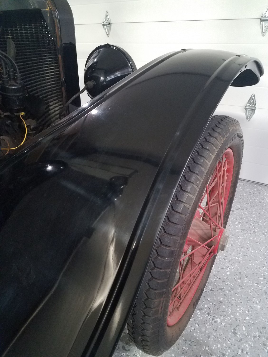

Now turn back the time machine another fifty years to 1923.
George
To 73 way back machine

It does have transverse leaf springs and a torque tube.

so what is that 23 w/ wire wheels ?
is the gas tank w/ white stuff for the 23 ?
great care & consideration shown on the black 73
Old Aug 17, 2020 | 11:12 AM
  #280
Big2Bird's Avatar
Big2Bird
Joined: Dec 2006
Posts: 8,837
Likes: 1,028
Yes and yes. New tank with one fill.
No varnish, just white powder appearance.
