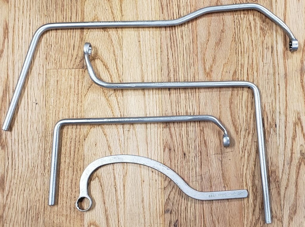

Originally Posted by Big2Bird
For you novices, that is a distributor hold down wrench.
I havent a clue if Proto stll makes them.
I have the same wrench. It has a few drawer mates:
Top to bottom:
Proto 6540 1/2"
Proto 6541 9/16"
Proto 6542 1/2"
Proto 6601 5/8"
DC

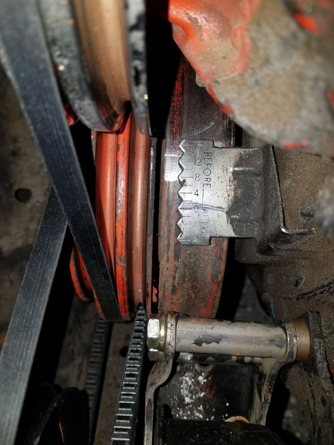

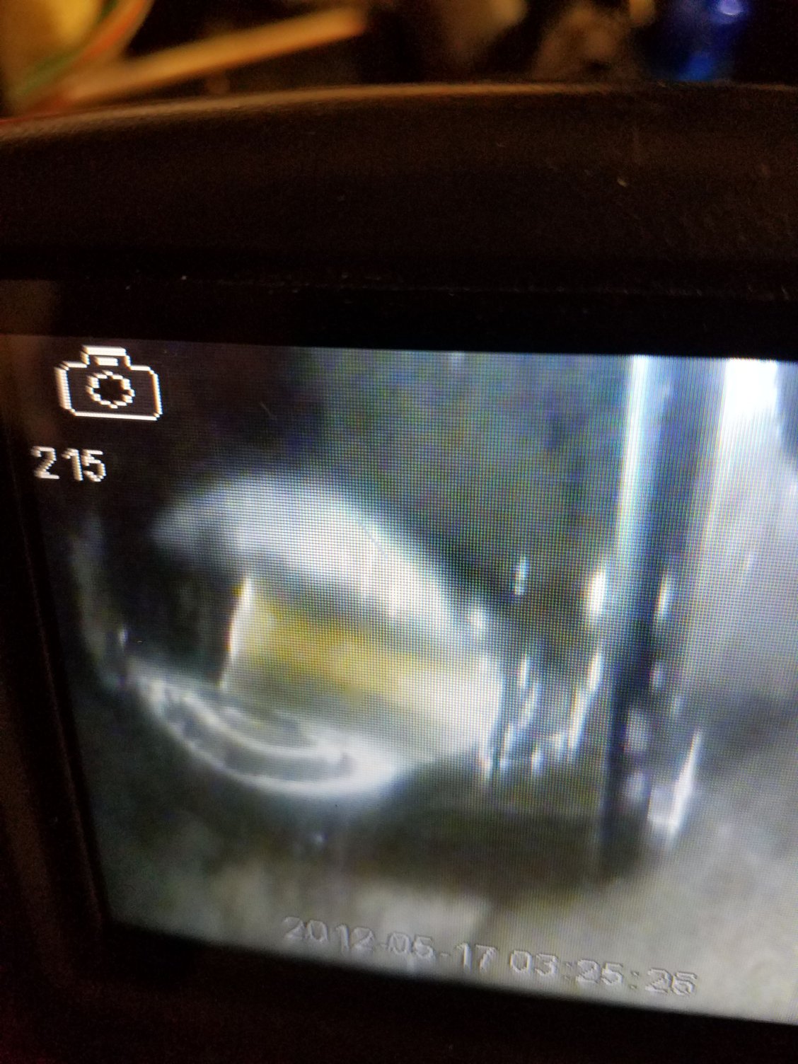

I set the timing mark here, just shy of my 18* target. I dont want kick back, so its safe.

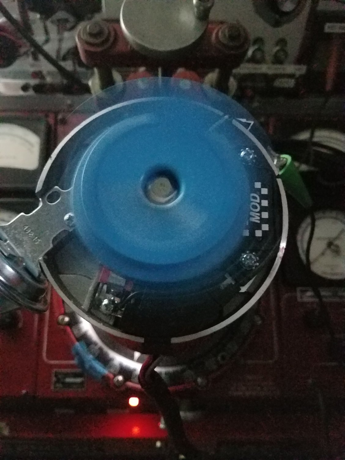

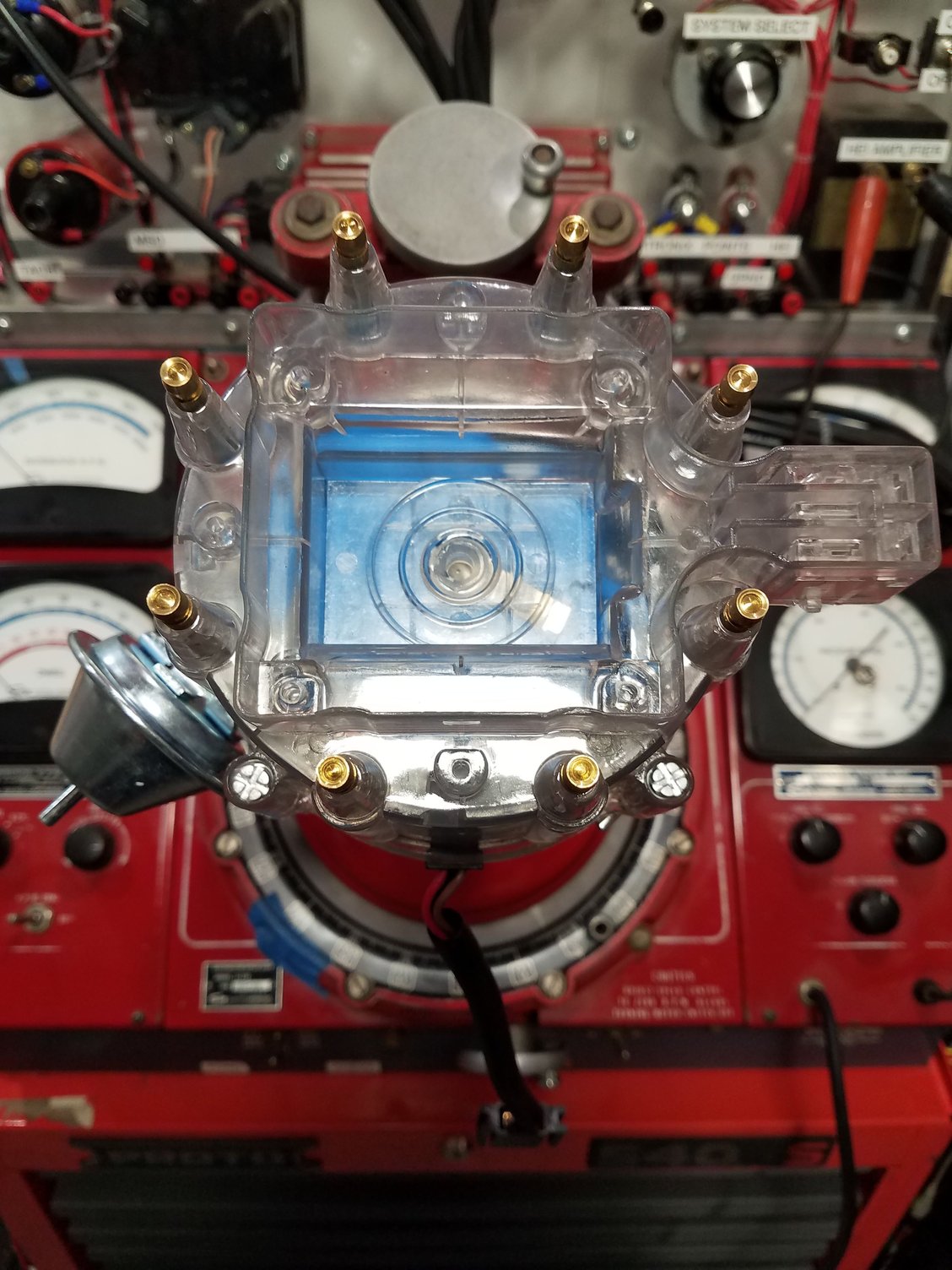

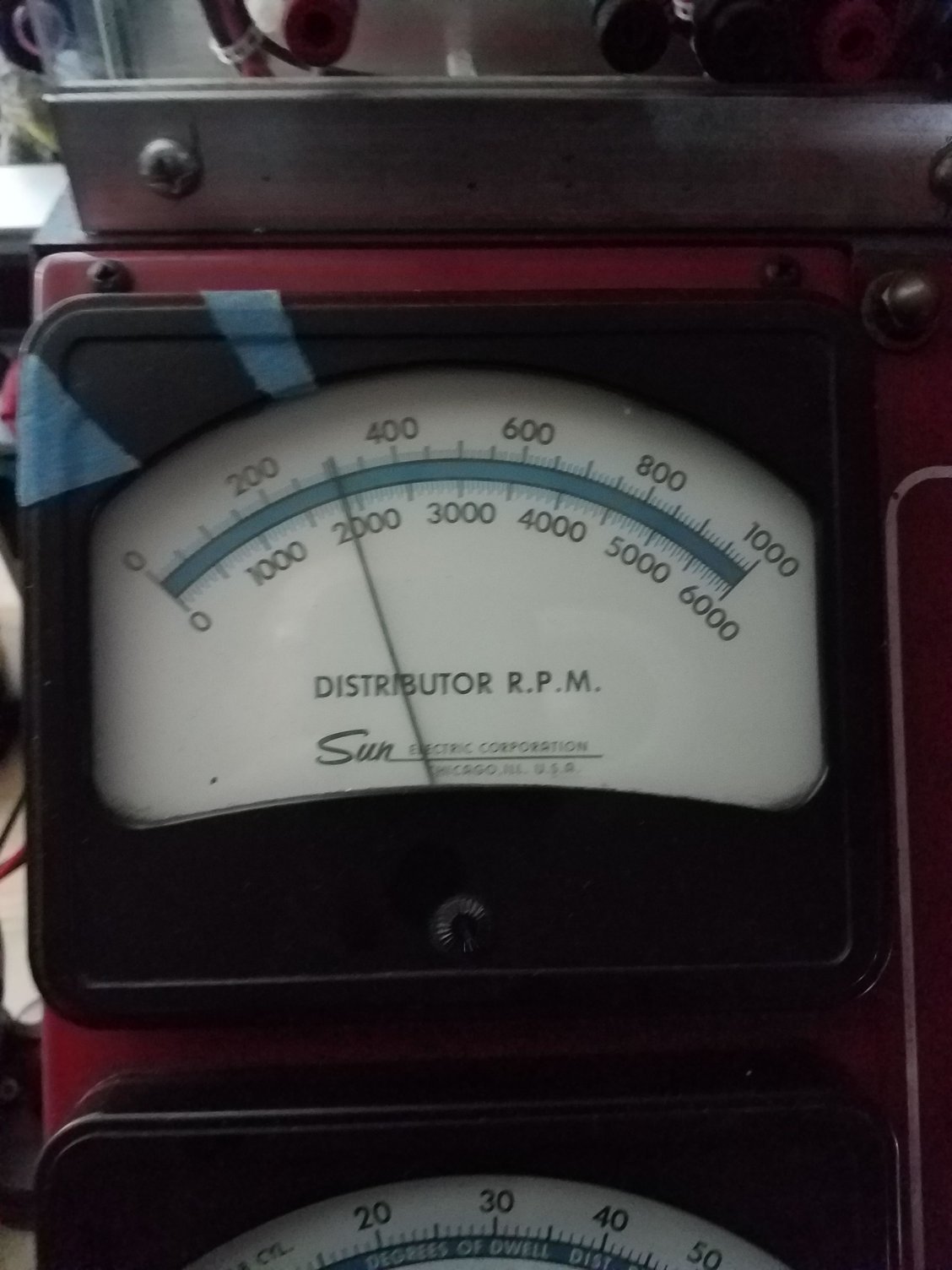

So one last spin at 300rpm. That would be firing at 600rpm.
I set my scale at 0*
Old Jul 27, 2020 | 04:14 PM
  #216
Big2Bird's Avatar
Big2Bird
Joined: Dec 2006
Posts: 8,837
Likes: 1,028

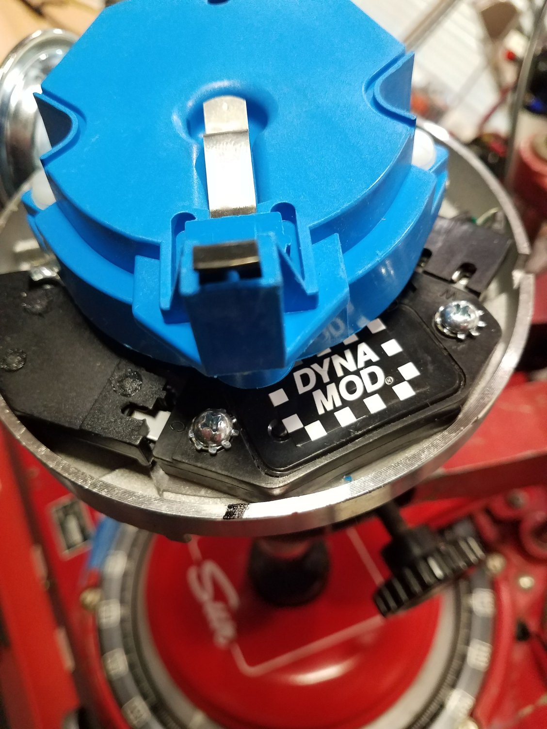

So I mark the rotor position on the housing at idle
right at firing. Verify the rotor is pointing at #1 , and if I drop it in on the mark, I will be within 2* or so, and it should fire right up.
One of the.perks of having a Sun Machine.
I used to dry time points with a meter. I could get dam close.

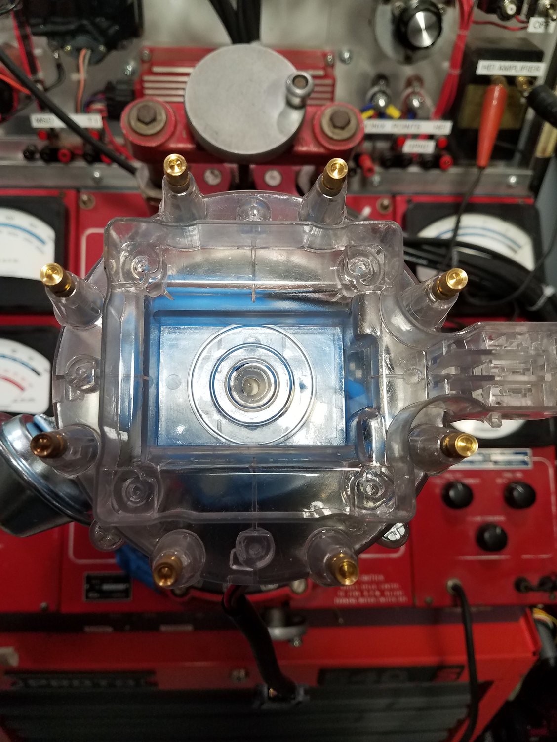

I like these gaskets. They last forever and are cheap.
A bead of assembly lube, and in we go. I already oiled up the shaft before testing on the machine.

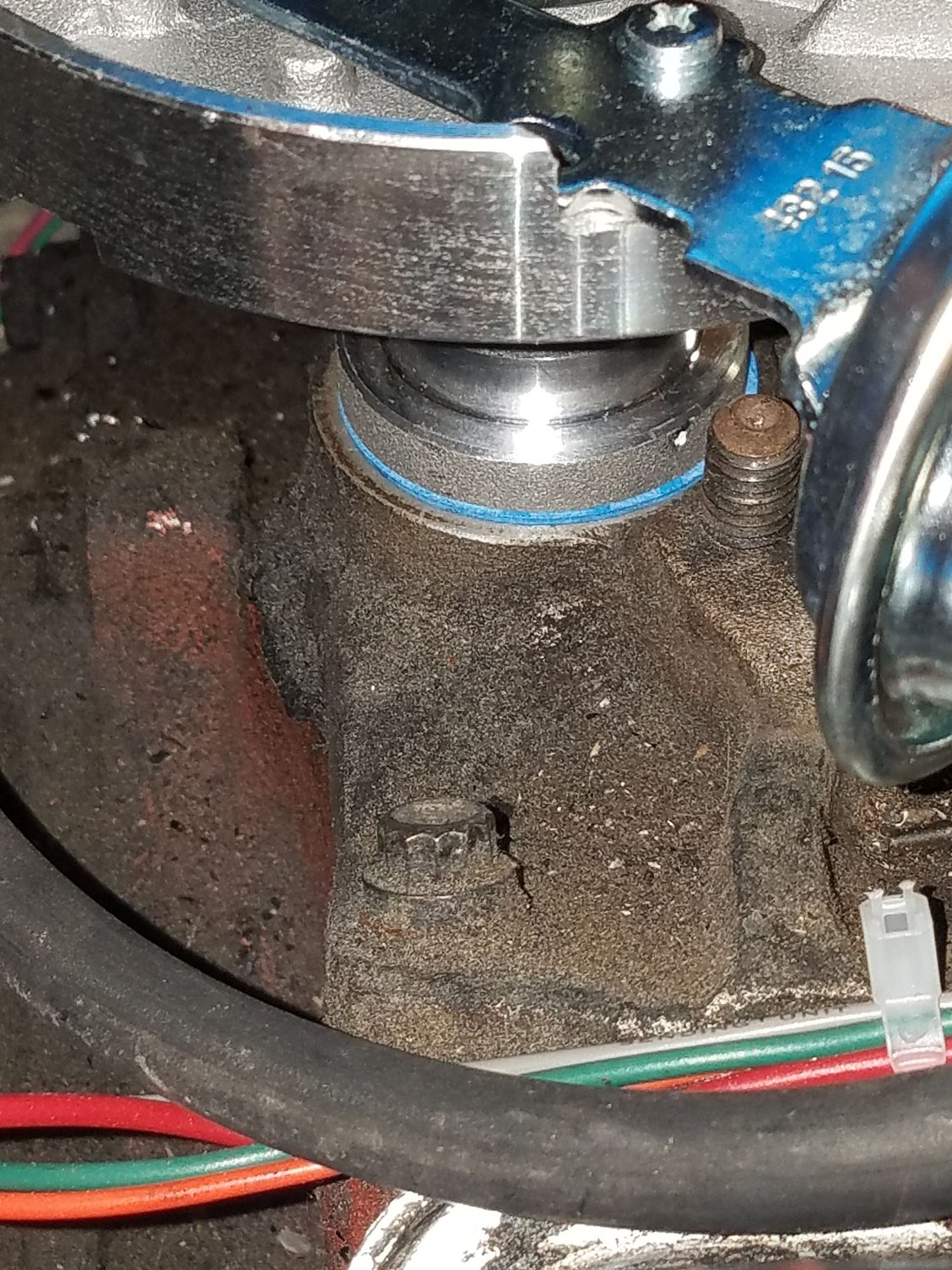

Okay, so you hold it where you want it to be, back up the rotor counter clock about 30* As it drops in, it will turn.
If it does not drop all the way in, pull it up and turn the oil pump a tad, and retry.
Some guys can walk them, but I tire of that.
Once in, verify its ALL the way down.
wiggle the shaft up and down a tad.
It cannot bind.
If you have any space after aligning the oil pump shaft extension, use one of these.
Sometimes, the heads or manifold is machined so much it will be too tight. I have never needed more than one, and they are rarely needed at all.

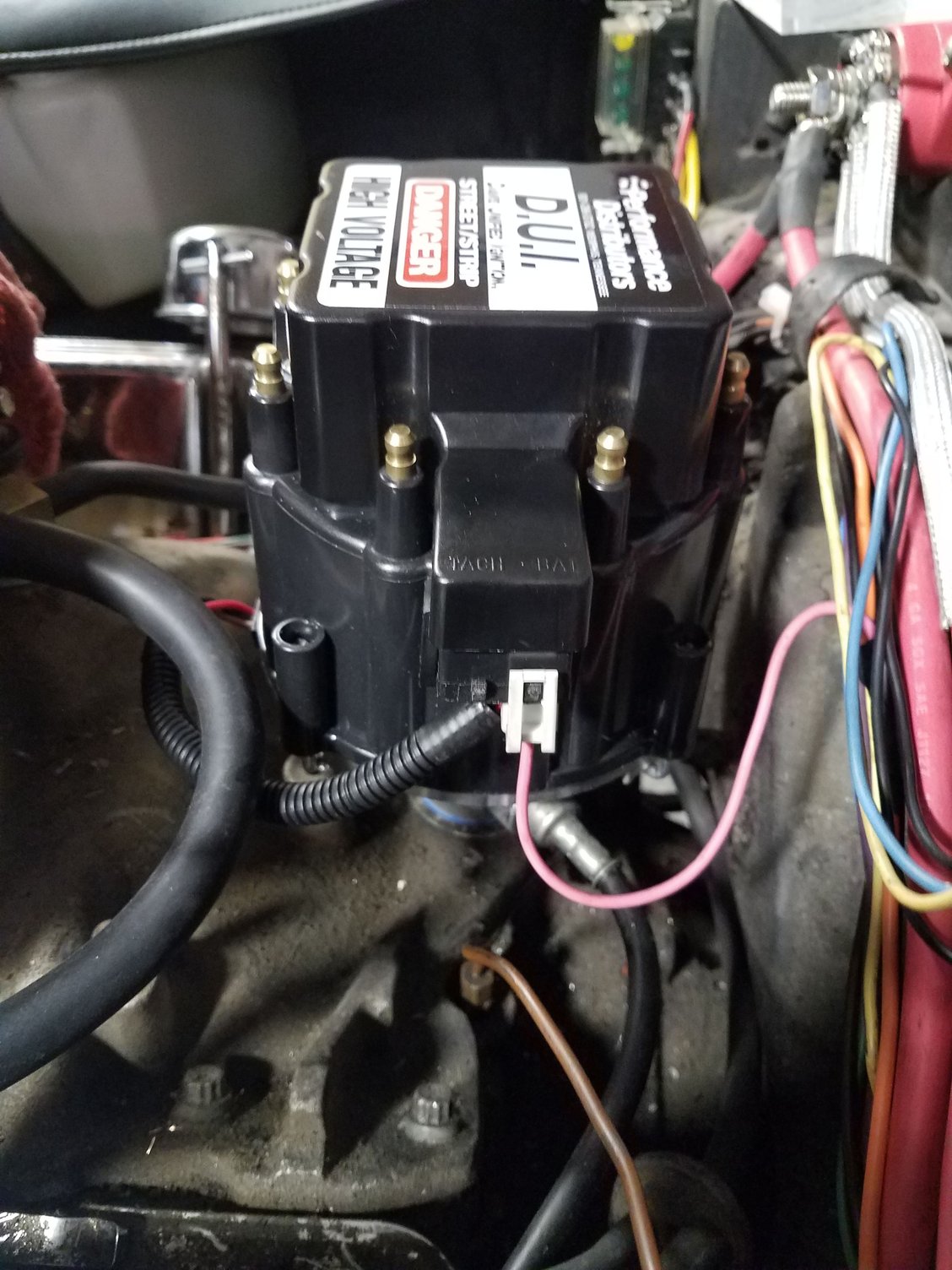

Tach cable hooked up. Make sure it is ALL the way on, and a light snug with pliers. A loose cable with farck the gears up.
Plug it in, and done. No doubt it wil fire right up.
