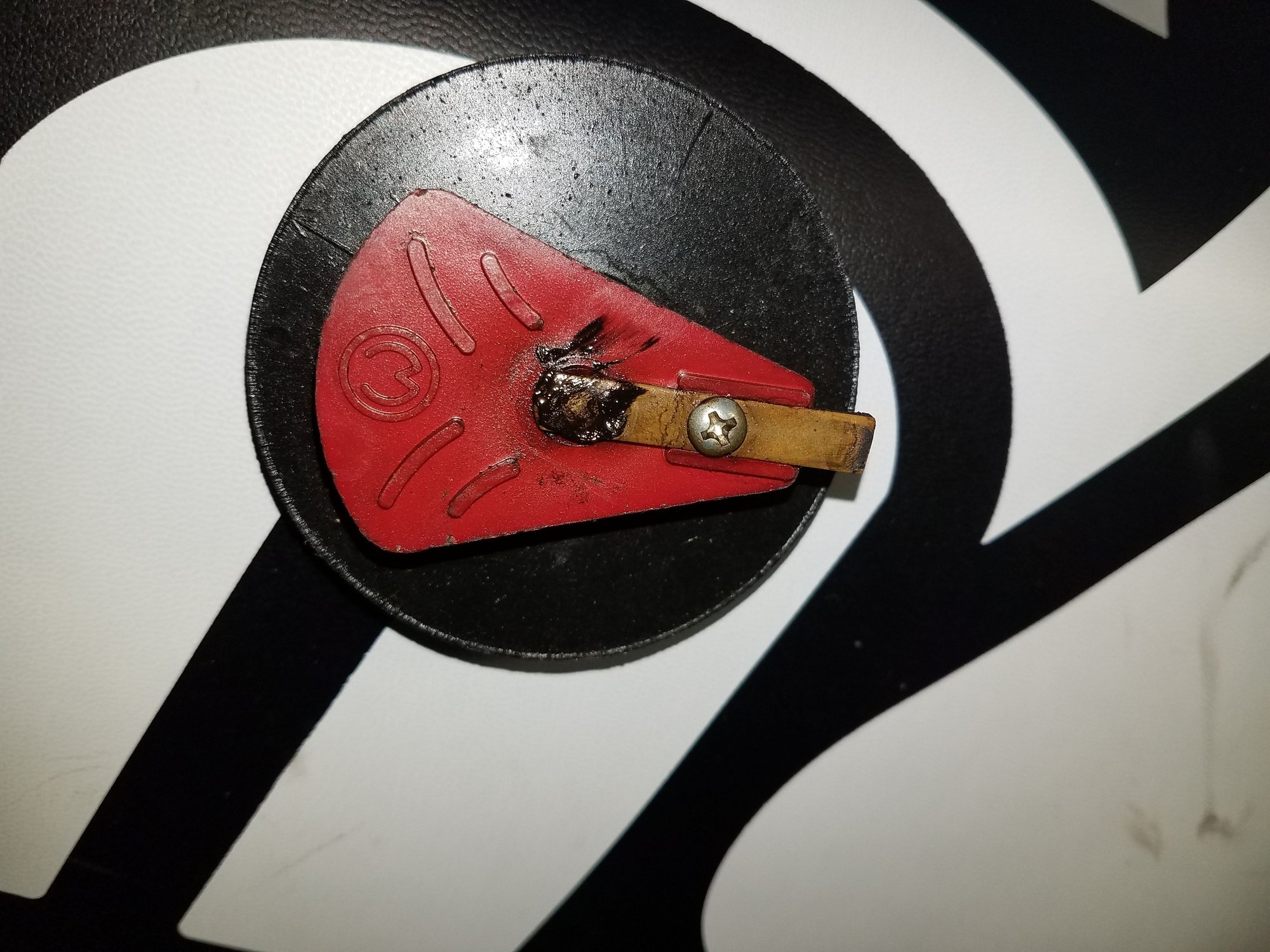

I am fairly certain his high speed miss is from the oil soaked carbon brush that is melting into goo.
At least the curve was dead on. 17* at idle, and linear to 36* at 2800 rpm.

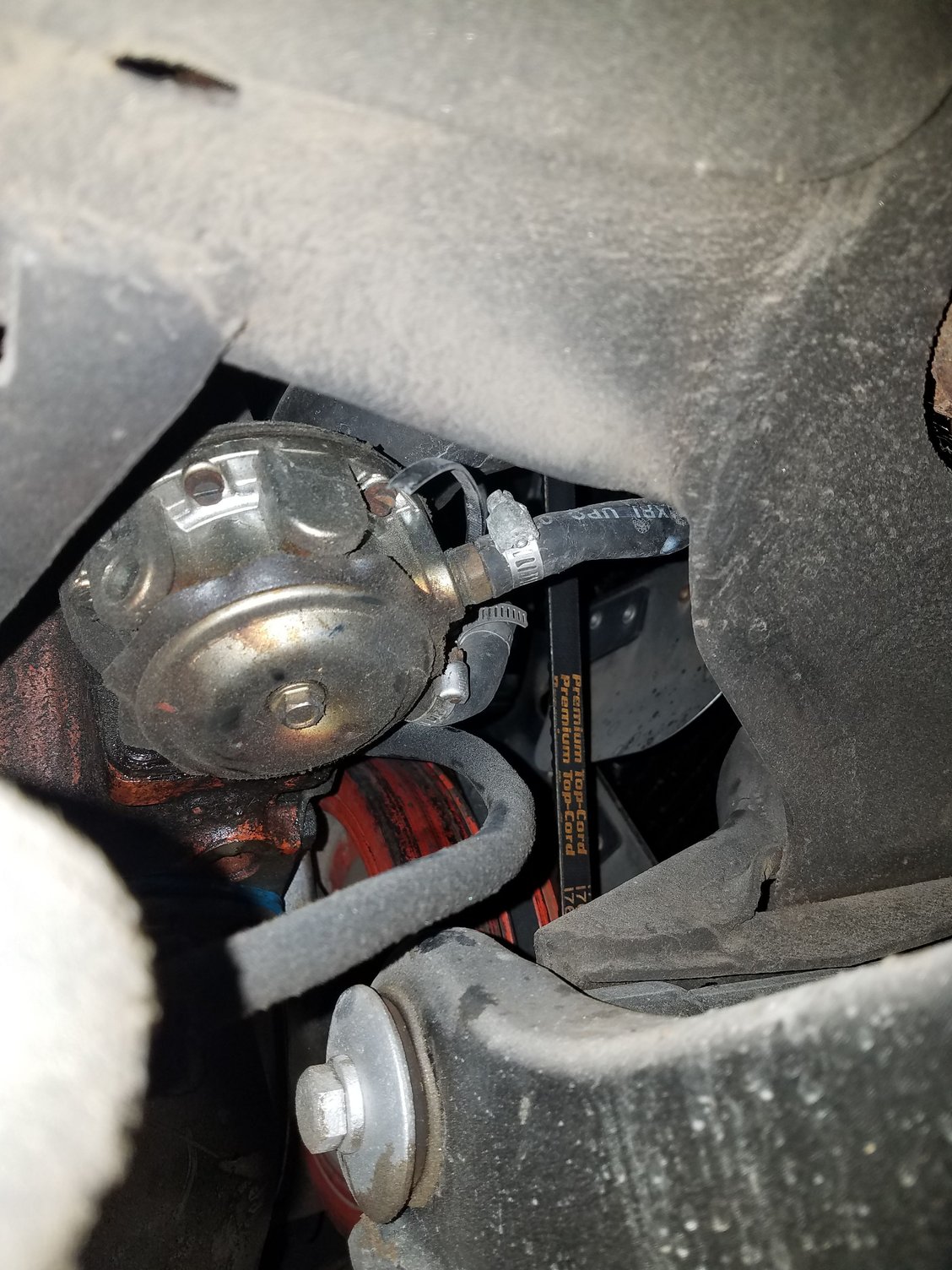

But, for street use, a vacuum advance will be added.
I also found all the header bolts loose, so there is the ticking on pass side.

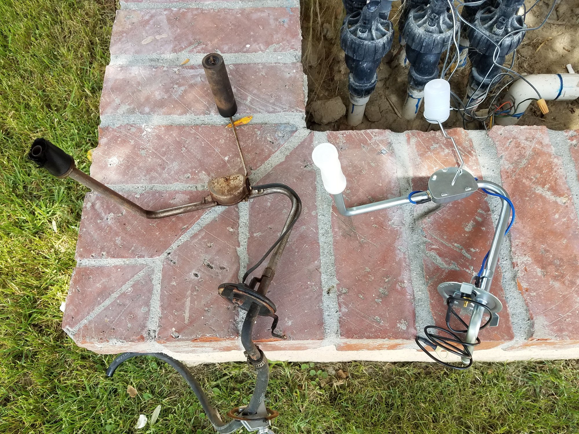

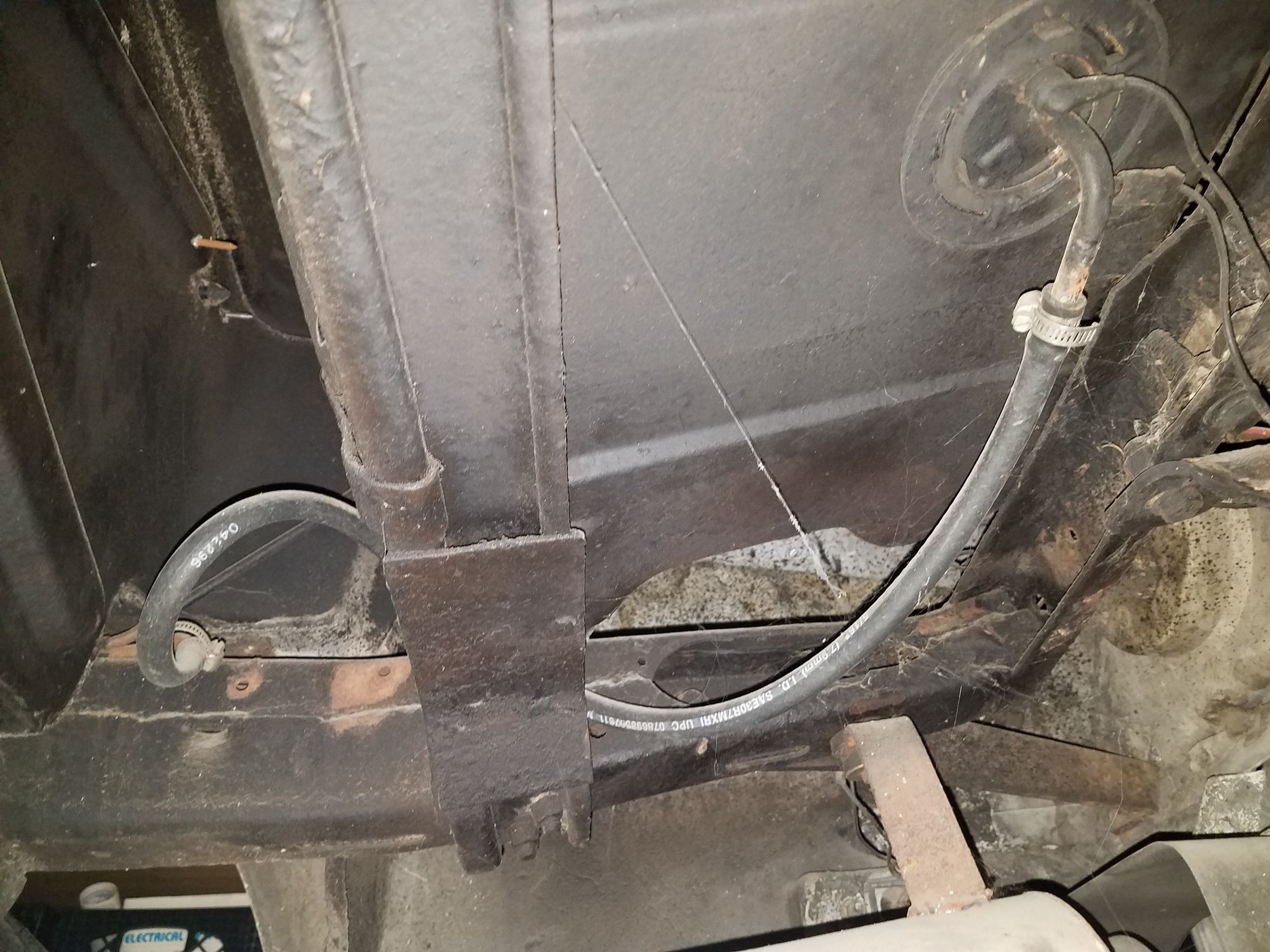

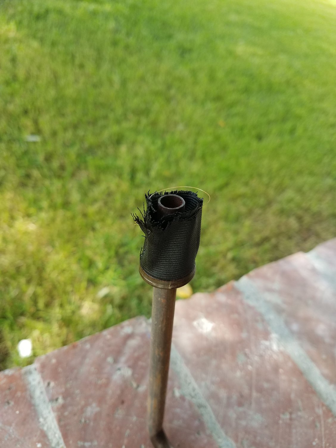

My favorite, the fuel system.
The filter sock has been cut off. The tank line is crazy.
There is an inline filter before the pump.
The pump is an old Holley? HP unit.
The steel line between the pump and carb can rub on the belt.(it flops around).
The pump return is disconnected.
I ordered a new sending unit, stock fuel pump, and will hard pipe the rest with an Earls inline filter.
Did I mention the "S" hose is pinched?
Yes. Just stock hose bent over.
Bubba DID do the fuel system.

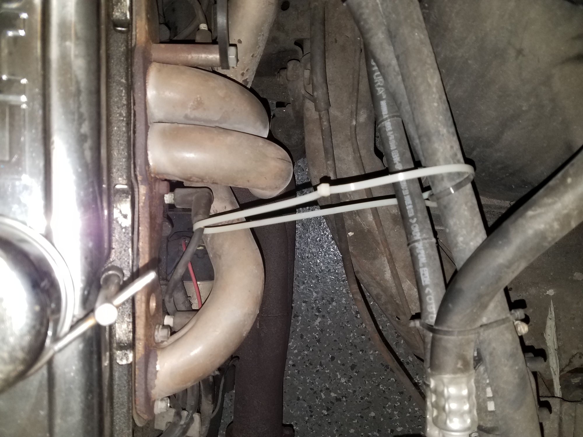

Like this plug wire alignment unit?
At least it’s isn’t attached to the header.

Like these melted on? I think they replaced this.

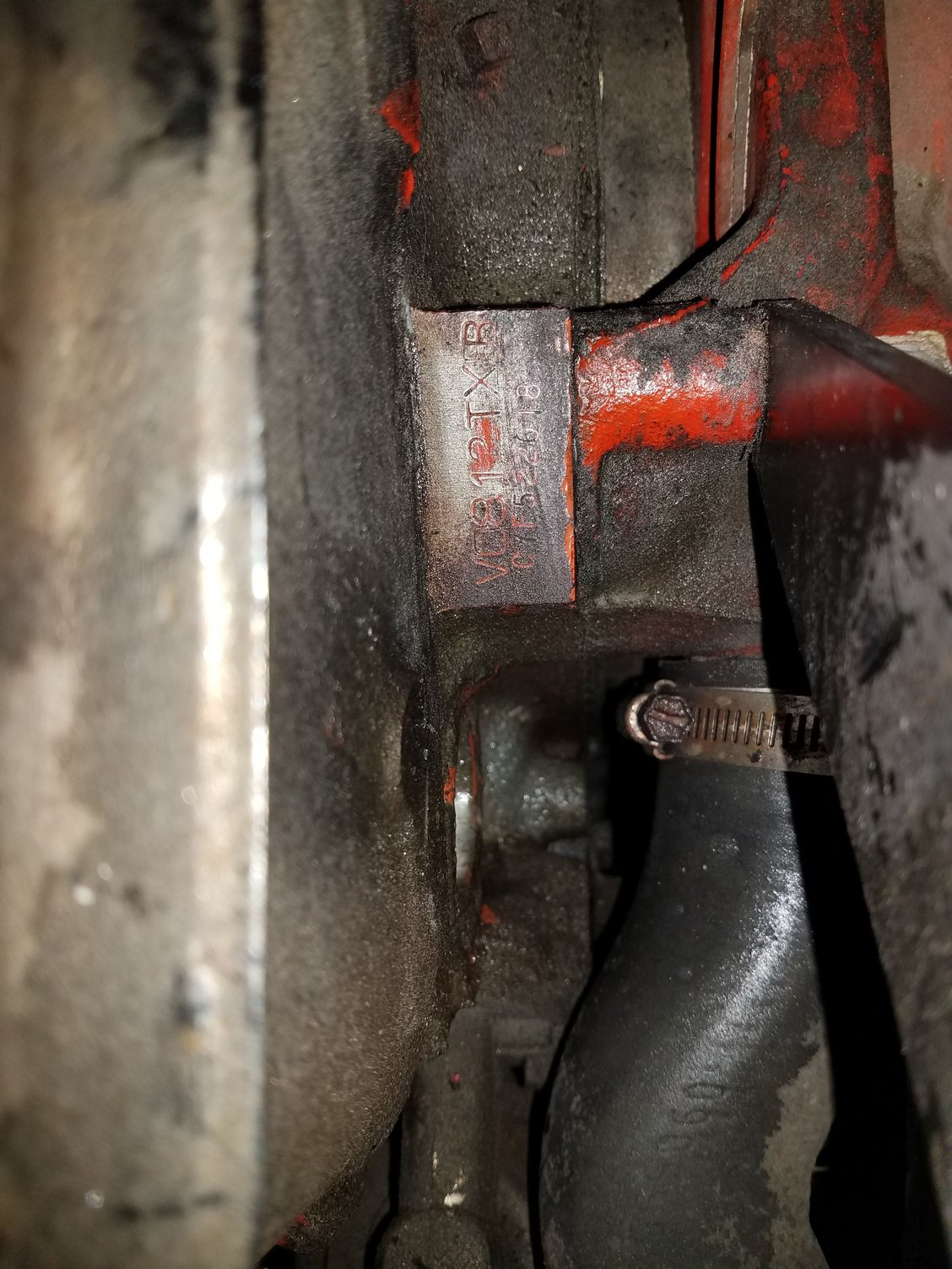

CXB 75 LS 9. C20 to C3500. 165 hp. but could be 4 bolt, forged crank and pistons.
Thank you very much. So, the story is correct. Just wrong year.
