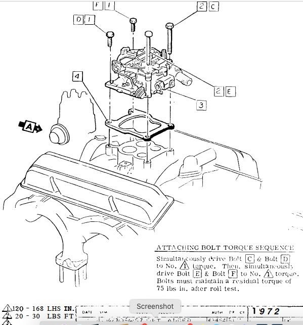

2. When bolting the carb to the intake, the 71 AIM specifies a crisscross sequence in 2 stages. The first at 24 - 48 inch pounds and the second at 20 - 30 foot pounds. Seems high to me.
Is this torque value correct?

The '72 AIM shows this: (no clue what the "roll test" is)

I torque mine in three stages - 6ft lbs, 9 ft lbs and finally 12 ft lbs in criss cross fashion. No leaks, no warping.

1969 AIM is 10-15 ft lbs. I think its not so much about the standard range for a Grade 5 5/16th bolt (22 ft lbs), but rather the soft metal of the carb air horn, body and throttle plate that is the concern. Too much torque may damage the soft metal of the carb. But to your point, it is possible for the bolts to heat cycle and come loose, but I have yet to have that happen.

Unless you want to do damage to the carb, tighten the hold down bolts only as tight as you can get them with a nut driver. 15 ft-lbs is WAY too much, and it will damage your carb. 22 ft/lbs will probably break the casting, and it will actually crush the float bowl over time. And use a flat washer under the bolt heads so you don't chew up and destroy the carb casting. GM got away with running the torque as high as 15 because these carbs were designed and intended to only last for 10-15 years. If the carb is destroyed in 15 years, who cares..? Throw it away. And throw away the car, too. Who wants a 15 year old Vette..?
For perspective, I did a demonstration during one of my Tuning for Beer Tours about how much torque is needed on the carb hold-down bolts to seal up the carb. I loosened all 4 carb bolts so they were only engaged into the manifold on a few threads - all the bolts were doing was holding the carb in position on the manifold - they were not clamping the carb down at all. When the engine started with the loose carb, engine vacuum pulled the carb down tightly onto the manifold, and it ran flawlessly. That's how much torque you need on those bolts.... (No, I'm not advocating running the car with the bolts loose. Just snug them down good with a 1/4" drive nut driver and you're good.) More Q-Jets end up in my trash can as a result of the owner over-torquing the forward hold-down bolts than any other cause.
