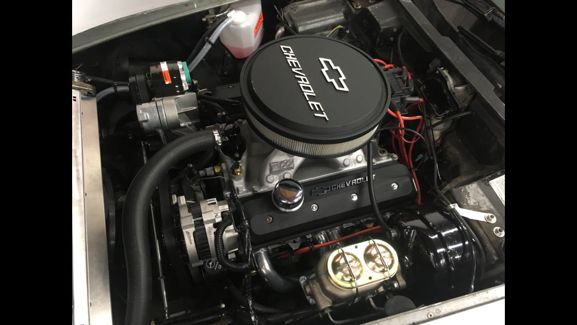

2 years ago I bought a new carbed ZZ6 “turnkey” from Scoggin-Dickey for my completely original 75 L48 4-speed. It was part of a complete makeover that included a 5-speed, headers, dual exh, coilovers, etc., etc.
I spent a lot of time fussing with all the final details. It would not have taken an experienced C3 guy as long as it took me. In the end though it was all worth it. What a magnificent motor.
Many will say that the same performance can be had for a lot less dough. I can’t argue with that. In my case I wanted something I could bolt in and it would work well from the start. Comparing my new 405hp ZZ6 to the original 43 year-old 165hp L48 isn’t fair but good gawd what a difference. From the first turn of the key it has run perfectly.
Speaking to your questions:
1- I can’t imagine not using the serpentine belt system. I did run into a clearance issue on the passenger side A-arm. I had to re-orient/modify the bracket for the fixed idler pulley. After that it worked perfectly. Whatever water pump they say you’re supposed to run is of course the one you should use.
Another consideration is spreader bar clearance if you choose to use one. Most will not clear the front of the engine with the serpentine belt system in place. I had to modify the brackets on my Speed Direct bar in order for it to clear. After I did that no issues.
2- The short answer is yes. There are hood clearance issues. I used an L88 style hood from It’s Fiberglass on eBay. Even then I had to use an air filter cleaner element that is 1/2 inch shorter than the element that came with my kit.
I had considered changing the intake manifold to a shorter one. In the end I wanted the engine to run like the designers intended so I changed the hood. The car looks a little boy racer but I’m glad I went this route.
3- I don’t know if you can use the stock exhaust manifolds. I can say with a set of headers and a decent exhaust this thing barks! When you want it to it will make an absolutely ferocious noise. At idle and putt-putting around the neighborhood your neighbors won’t entirely hate you.
4- Yes that transmission will bolt right up. For only $7500 my engine came with a flex plate already bolted to it. I had to buy my own darn flywheel LOL.
I say do it you won’t be disappointed.

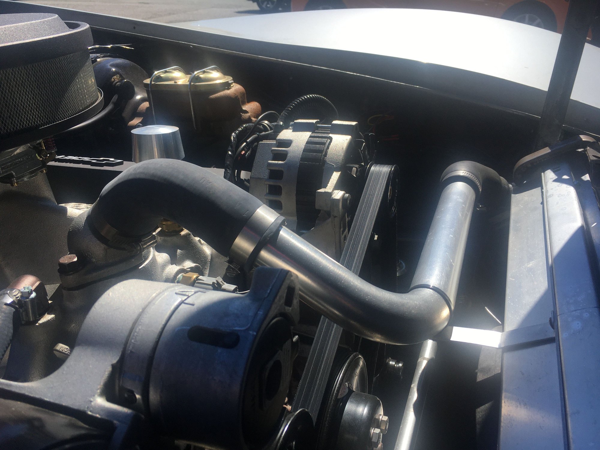

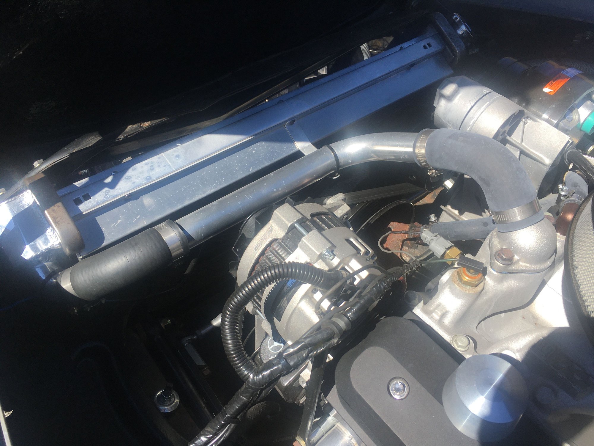

For a t-stat housing/upper hose version 1.0 I got one of those billet aluminum swivel housing gizmos from Summit with a slight (15 degree I believe) upward angle. Everyone told me it would leak. They were right!
At that time I just tried all the upper hoses from the car parts store until I found one that fit. For the brief time I had that set-up I hated how “floppy” that long hose was as well as how close it got to the serp belt. Then the housing started leaking and I started over.
For version 2.0 I went with a good old cast iron housing... I think from Mr. Gasket. A friend who has the dream job of being a caretaker/technician for a billionaire’s 50 car fleet made me an alloy section of pipe. That acts as the main upper hose section. He connected it with 2 rubber hose sections he had lying around. I’m very happy with the final result.

Nice job on 2.0! Is that a bracket from the rad holding one of the billet parts of the hose?
So the picture that you shared up in the thread was the “long floppy hose” that you changed out for the billet pieces?

Yessir my first picture is of the long hose that was floppy and too close to the serp belt.
And yah for the new pipe there is a small aluminum bracket coming off the radiator to stabilize things.

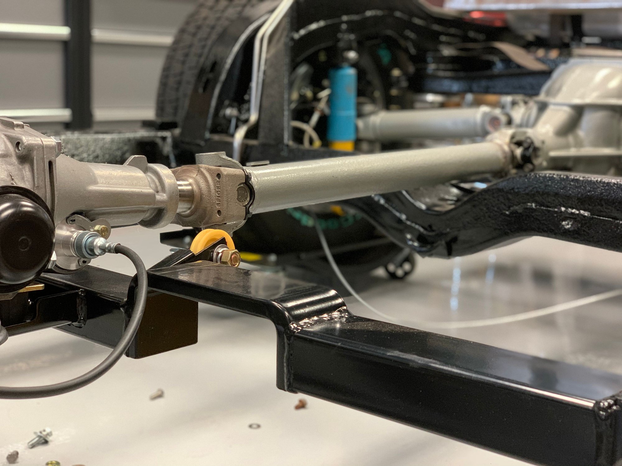

Regards to the 700R4, I used a G-Force cross member (my stock one had some damage). What did you use for cross member and how much shimming?

My car is a factory L-48 4-speed. 66k 1 owner miles and zero mods when I started. At the same time as when I swapped in the ZZ6 I installed a Tremec 5-speed kit from SST. I made no changes to the stock crossmember.
The first time I bolted everything together the ex pipes sat slightly low where they passed through the crossmember. I spaced the SST trans mount “up” with a couple extra thick grade 8 fender washers that have a huge outside diameter. That centered the ex pipes while leaving the driveline angle still close to 0.

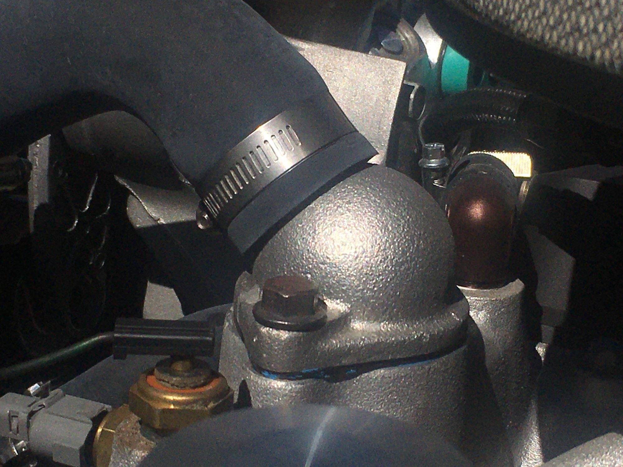

Those Oring T stat housings are a crap shoot..pulled the oring out, filled it with silicone and used a gasket .Then it warped
Summit still sells the aluminum GM housing they put on all their crate engines, they are about 10 bux
once they are gone they are gone. Highly recommend one.
