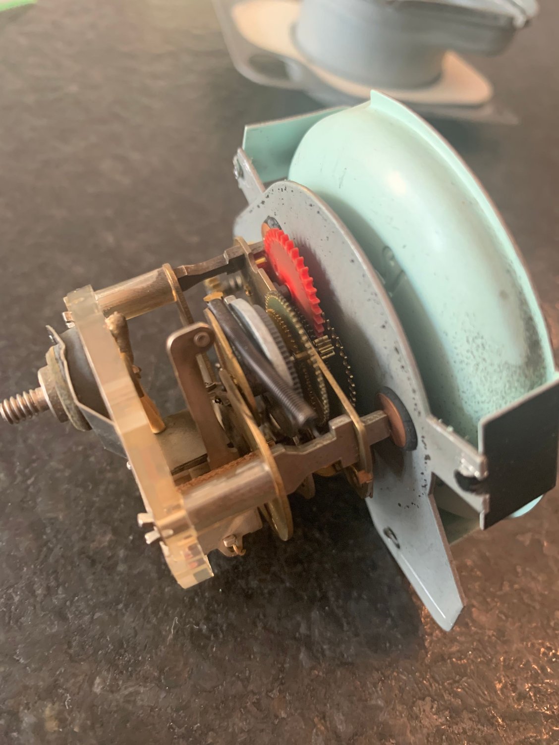

have read several threads about clock repair, but I seem to have found a unique one. Upon opening the case, the spring that drives the mechanism was disconnected. Any chance someone could give me a reference pic or link to tell where the unattached end should go? I think I have an idea, but would love to fix it once and done.

If you are speaking of the long coiled spring that is stretched when the solenoid fires, you just need to determine WHY it became disconnected and restore it. If the end-loop on one end failed and broke off, you might be able to take the next 1 or 2 coils and bend them 90* to form a new end connection, then reconnect it.
If you are speaking about the balance wheel spring, take it to a jeweler who does watch repair. They can assess the damage and possibly fix it. Otherwise, it's time for a new QUARTZ movement.

It is indeed the long coiled spring you mentioned first. My pic shows it as I found it disconnected. The loose end appeared to originally have a loop that became stretched out and likely pulled free. I’m able to use some surgical instruments and bend a makeshift loop back into the end, but I’m not sure where to attach it now.
