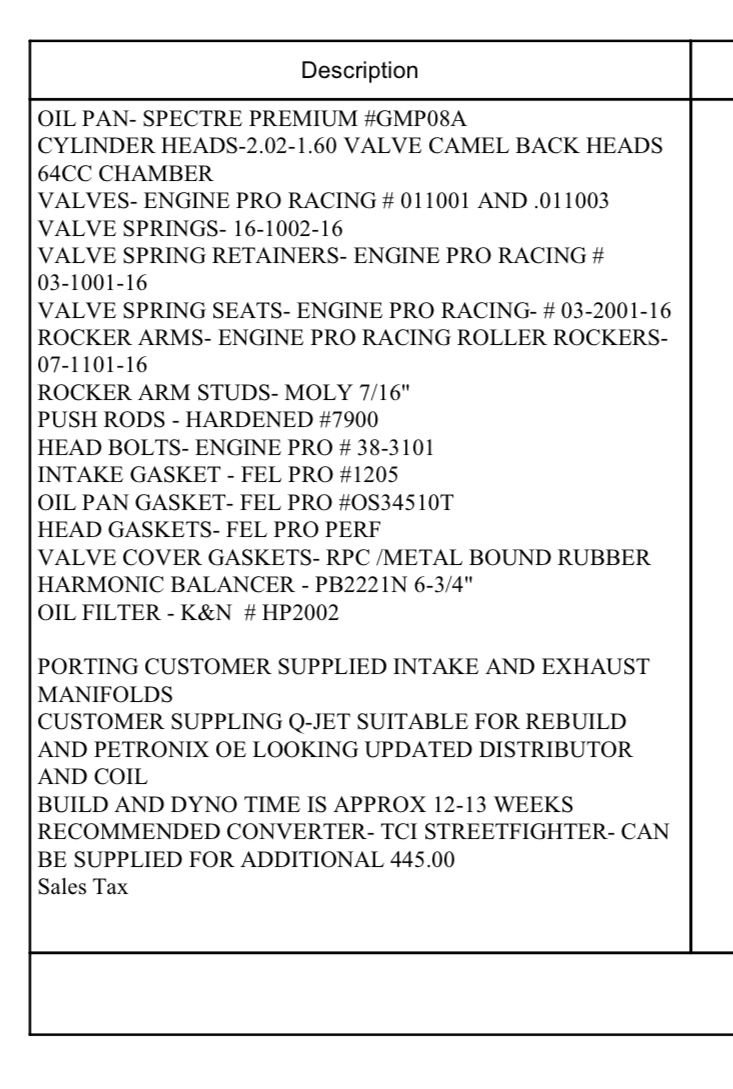

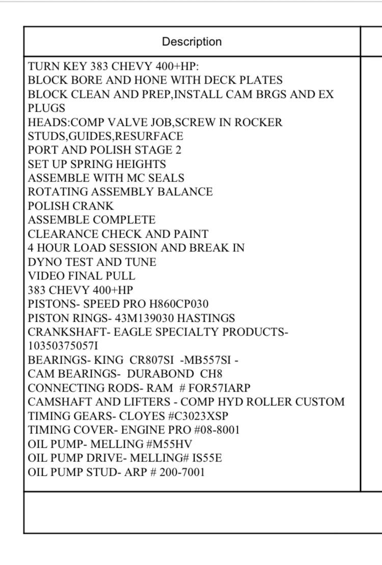

Hello friends, i received a quote from a company that is potentially going to be building an engine for me. I am seeking input from the more experienced on here as i have never done an engine swap before. please tell me if i would be getting ripped off or not if i went through with this build.

It looks to me the price is good especially for turn key.
The 383 I am building from a bare block will come in around $4K with a flat tappet cam and I do all the work. Roller cam would add to my cost so you are getting a good deal.

Delete the MSD Street Fire, and use GM 93440806 instead. It will run MUCH better.

Thanks for the advice however I already have, in my current set up, installed a digital 6A and plan to reuse it, so I'm sure that it wouldn't matter much if I changed distributors.

Seems very reasonable to me. My recent 454 rebuild (new pistons, cam, lifters, valves, springs, bronze guides, assembly, machining, break-in and dyno) cost about the same as your quote and way more parts are included in your list.

Looks good and has some decent parts.

The ignition box has nothing to do with the timing curve. Street fire distributor does not lend itself well to be curved...the GM Distributor is spot on.
It looks like a solid build...there are a couple of things I would spec different but the biggest one being the M55HV oil pump. I wouldn't let them build it or give a deposit unless it was spec'd with a standard volume pump.
Also....if you have a box....I would want the corresponding MSD distributor spec'd as well......it is much smaller and plugs right in to your box. Either 8362 or 85551, I can't remember......

delete & fleabay the 6 box; wholly unnecessary (during 4 hrs dyno / run-in, shop is tuning new brawler carb & dist right?)
also substitute a Standard pump for that HV pump. Suggest M155 w/ larger tube and have shop set up bearing clearances accordingly.
also substitute the GM HEI for that streetfire
Those are old-fashioned Thick-wide rings & pistons. I'd choose more modern thin metric ringpack design rings & pistons. I'd also choose 6" rods (w/ appropriate pistons) instead of 5.7".
That cast eagle crank's OK but it's higher $ than most cast because it will internal balance w/ 5.7" rods-pistons. But if you go to 6" rods-pistons, most any crank will internal balance.

You probably couldn't do it yourself for more than that.

Doesnt sound bad esp dynoed and ready to run with accessories. Not crazy about engine pro or Proform but probably fine.
A steel crank is fine unless youre twisting it to the moon they can take some abuse.

Actually looks like a good deal with some solid parts. Should run great.
Installation and dyno run is included in that price! Even better. That's worth 600-800 each.

I’m doing a 383, but want a stock look. Planning on taking my cast iron 4bbl intake, ram horns, and Q-Jet in for port matching/dyno tune. They’re going to use a set of camelbacks with 2.02/1.60 valves at my request. Requested a cam that’s good from off idle to 5500. My quote has a Comp hydraulic roller cam on it, but no specs, only “custom grind”. They’re also recommending a pretty loose converter (3000 stall), which seems iffy for a 4000lb car with a 3.31 gear. I’d like to see around 400hp, but I really want the car to have good street manners. Anything will be an improvement over the stock 283, but that converter recommendation is causing me some hesitation.
