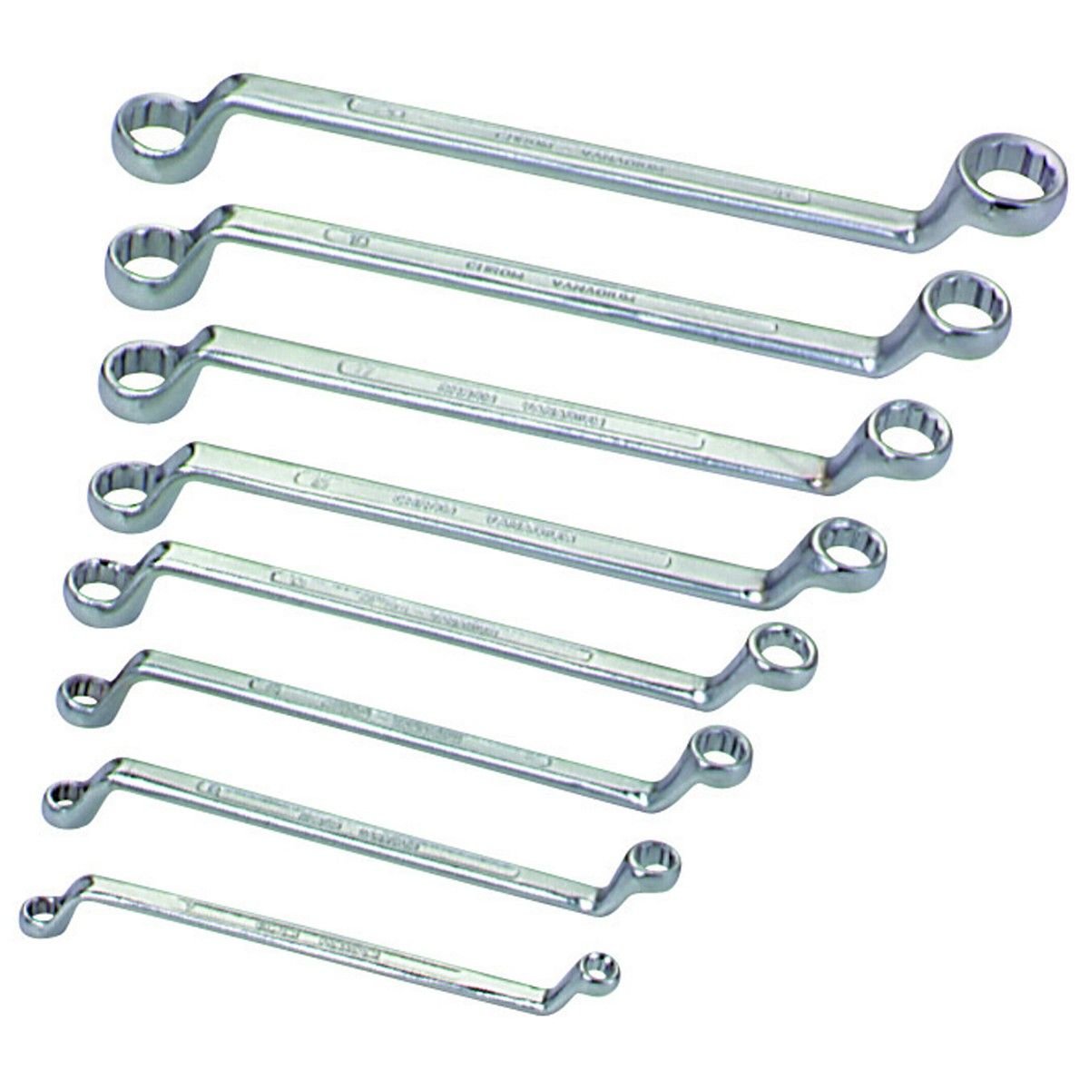

I found a 75 degree drop boxed end wrench will fit almost all of them but they need to be the sharp drop style
I cut a cheapo 1/2" socket and weld it to a strip of metal for a handle
That got into the ones back by the dog-leg kick ups
