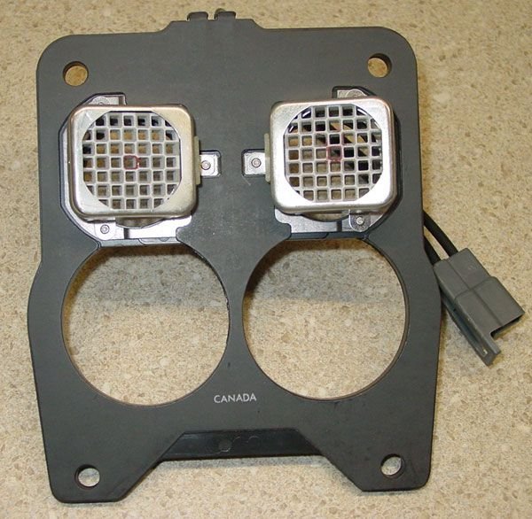

How about this gem?.....that came on 81' Caprice 305's? The relay for them would stick and melt the grid......dropping **** right into the engine. 20 minutes with a 1980 spec gasket would pickup a butt load of response at low speeds......all S-10 2.8l V6's had them as well as CCC 3.8l V6 G-Bodies......fun times. Not exactly sure why anyone services these....but you can still get new ones!
Jebby
