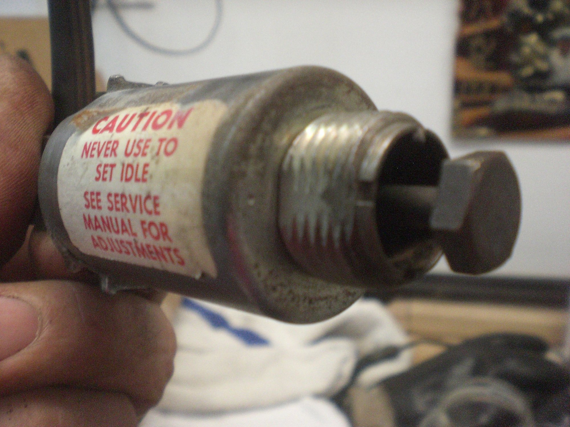

2) The idle solenoid had what appeared to be dirt/grease/debris around the plunger shaft. It cleaned out easily, but now I'm not sure it wasn't the remains of some sort of foam like filter or packing. Are those solenoids supposed to have something surrounding the plunger shaft?
On this idle solenoid, is there something missing in the cylinder the threads go around that should surround the plunger shaft? There are two little tabs that are bent down into the vacant area that appear to maybe be designed to retain some sort of packing or filtering material...

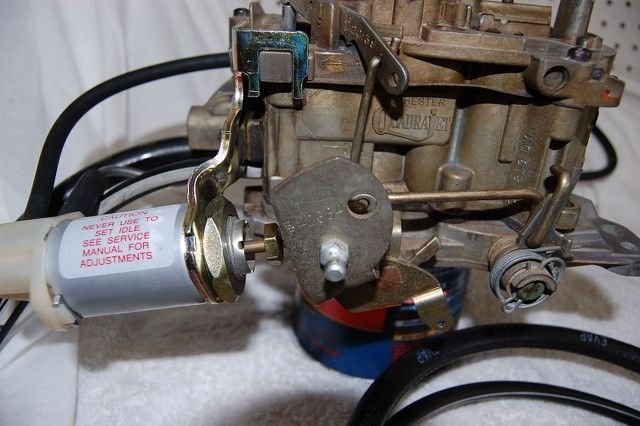

For #2, here's a pic from Alan71 showing nothing in the end of the solenoid
M
SEE POST #4 BELOW THERE SHOULD BE A FOAM FILTER

The CEC solenoid I have for my 71 does have a foam piece around the plunger.

It would be better to have no foam rather than deteriorated foam that might hinder the operation. The foam was to keep grease, etc. from gunking up the shaft and hindering the operation.
I'd probably replace it with some scrap foam I have laying around being careful not to retard the operation of the plunger.

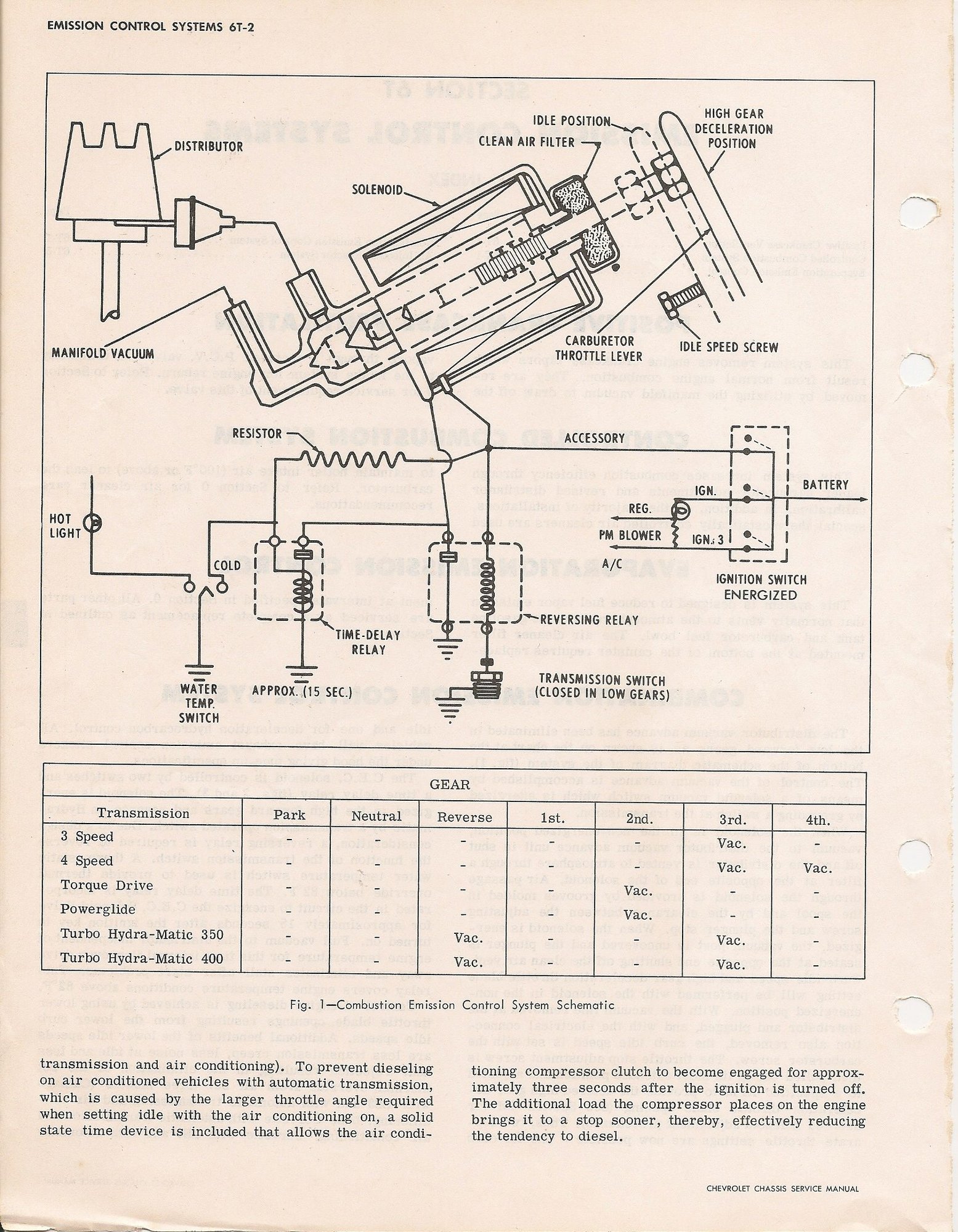

Doesn't show on the picture, the other calls it the clean air filter in that end
M
M

OK that sure clears things up in the other direction. I appreciate all your help. I'll have a try at tracking down that air filter but if I can't find one, I'll come up with some sort of replacement!
