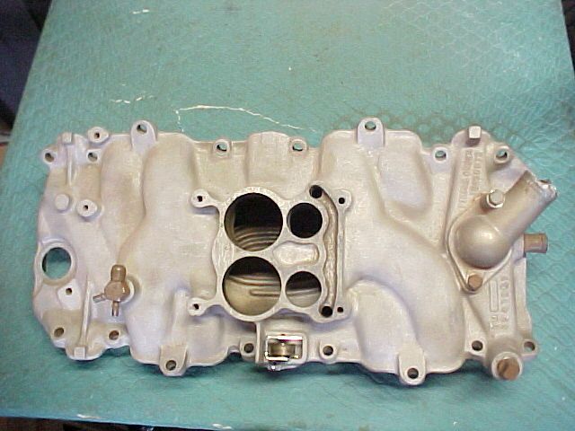

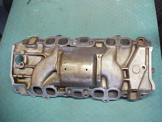

You might want to check that casting number - I don't show that being a real number. Is it possible that it's actually a 3955287..? This is the closest number for an oval-port cast iron manifold casting number for a big block, and it's the number for a '70-'71 402 (LS3).
Before looking for an intake, you probably want to check and verify if you have rectangular port heads or oval port heads - if the intake has been swapped out, maybe the heads have, too. This will limit what you need to search for when looking for a factory aluminum intake. If you have the stock oval-port L36 heads, the intake manifold you need is a 3947801, and it looks like this:
The 3947801 is the only aluminum Q-Jet 427 manifold used by the factory. Other big block Q-Jet manifolds were cast iron, and other aluminum manifolds were square-bore Holley designs. You can expect to pay around $800 - $1000 for a nice 3947801.
