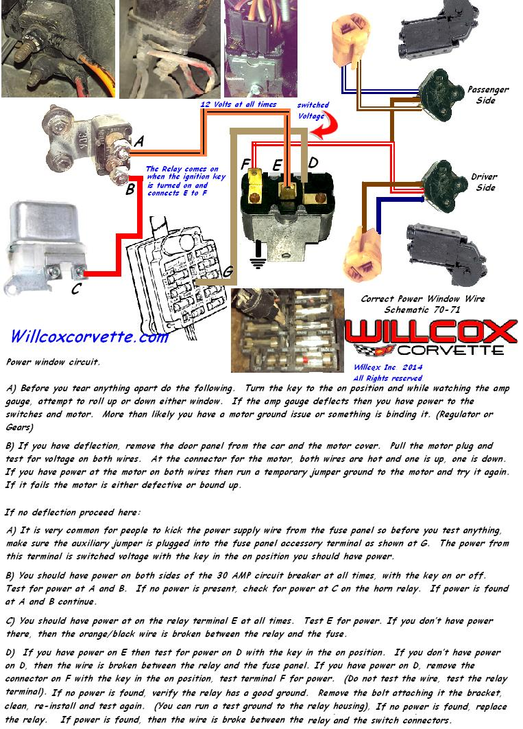

Here’s what you need to troubleshoot. Sounds like a voltage issue. If I had to make a blind guess, I’d say relay, but run down this list.
[img]blob:https://www.corvetteforum.com/3798ac45-f7cb-42a2-9ec2-03f004802993[/img]
