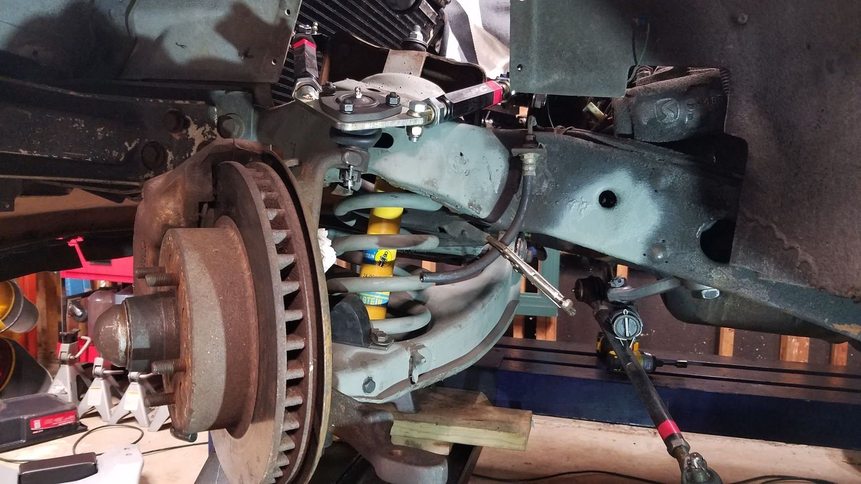

These arms (SPC Adjustables) allow you to add both camber and caster, since you can increase the length of the front leg of the triangle.

Originally Posted by Bikespace
I bet that's it exactly. Give them a call and find out.
These are the best choice for both camber / caster.
I have these same upper arms, I run - 3.6 degrees camber and 6 degrees caster (track days). This was not possible with any other upper arms.

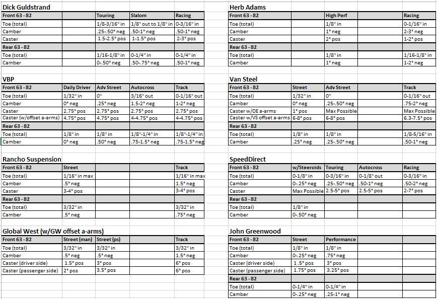

Global West only recommends 3 to 3.5 degrees castor. Here's a handy reference.
Old Sep 2, 2020 | 09:18 AM
Bikespace's Avatar
Bikespace
Joined: Mar 2017
Posts: 11,947
Likes: 4,506
Nice chart, thanks! I see recommendations as high as 7 degrees from some others, including Van Steel. It seems that the limitations of the stock-style arms may have limited some of the recommendations.
Great Chart! Thanks to all for the enlightenment. Much appreciated

Originally Posted by LINY Kevin
Off topic, but did you have to use a limit strap with those A-Arms? Mine are scheduled to arrive today.
Originally Posted by cagotzmann
Don't have any limit straps. When the car is lifted and the suspension hangs I don't have any issues to limit the suspension travel.
The only problem I see is that the SPC arm hitting the chassis is what stops the suspension from extending all the way. Not a problem on a lift. Not a problem on the ground. But perhaps a problem if you catch air going over a speed bump, for example. The stock A-Arm has a rubber bumper, which is not part of this design.
I figure I'll add a bumper of cut garden hose around the arm the next time I think of it.
