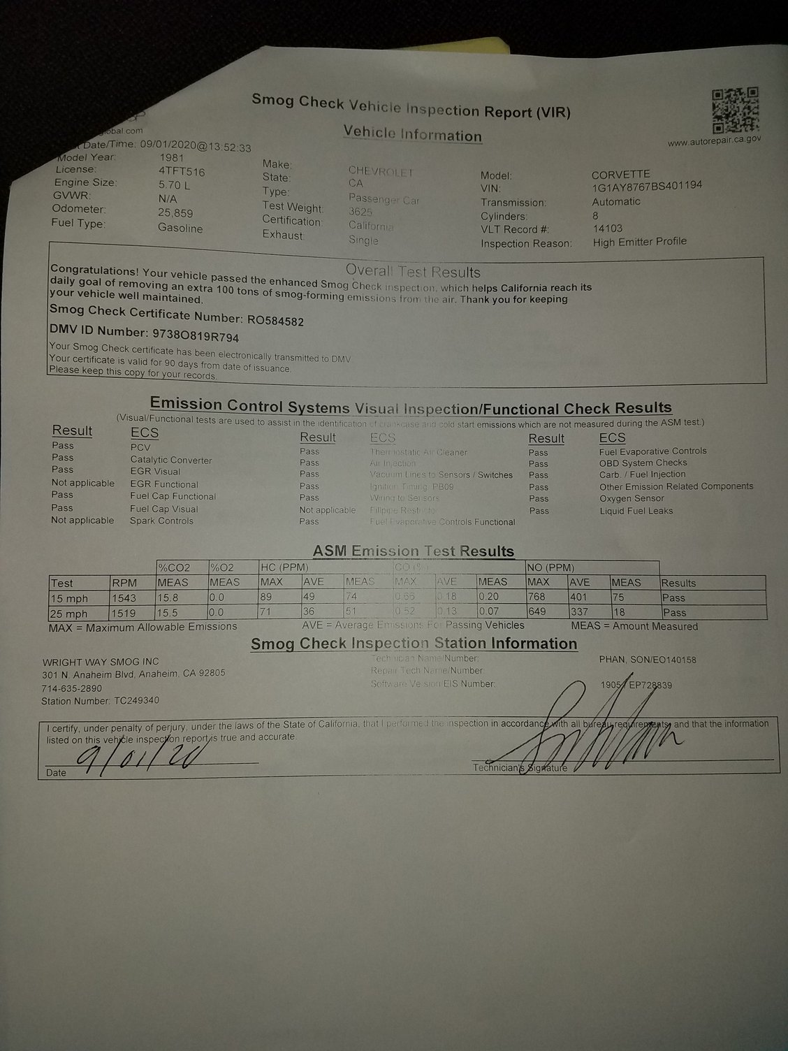

Speaking of smog, I am having it tested at this very moment.
Old Sep 1, 2020 | 05:20 PM
Big2Bird's Avatar
Big2Bird
Joined: Dec 2006
Posts: 8,837
Likes: 1,028
Passed.
