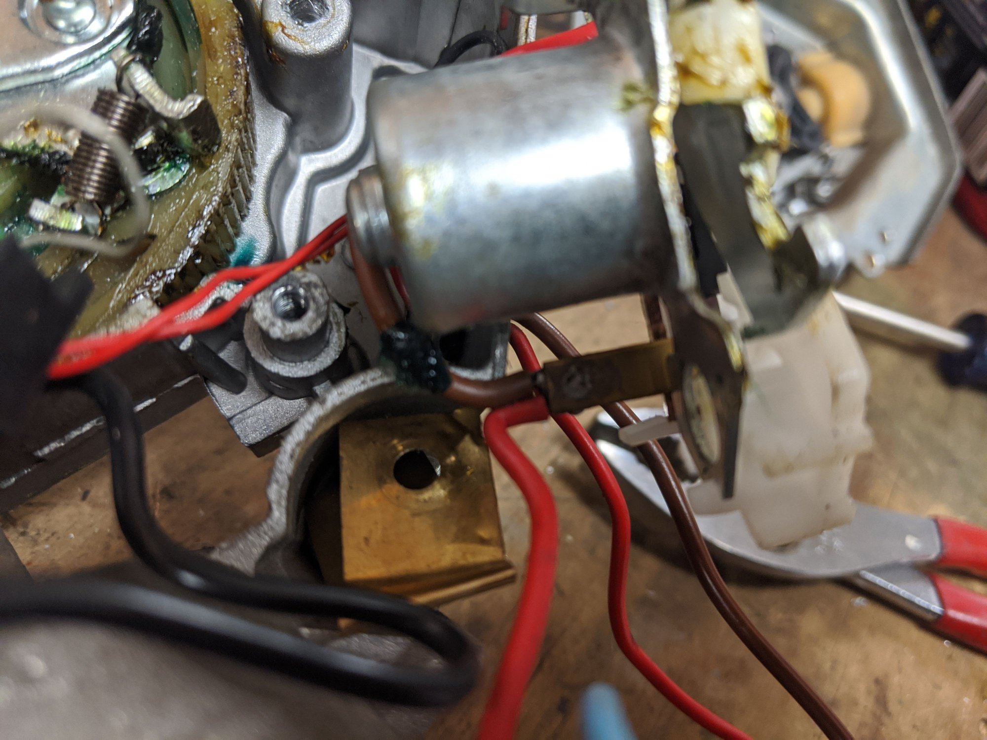

there might be a wire crossed inside....possibly.. The yellow wire always has power so it could be bleeding power to the brown or possibly the blue wire is giving the motor a signal to give the brown wirer power....

I realized I just bought a wiper motor off eBay. It's a lectric limited piece. But not sold by then So looks like you're right. Bench test it and try and find the breakdown and fix it myself without wrecking it...hahah

The plot thickens. This resistor should probably be completely attached or soldered to something shouldn't it? Any hints on where?

I fixed it! It seems like that resistor wire is just supposed to go to ground and was inadvertently in contact with most likely that brown wire. Put it all back together and it runs and parks I can button the thing up and move on with my life!
