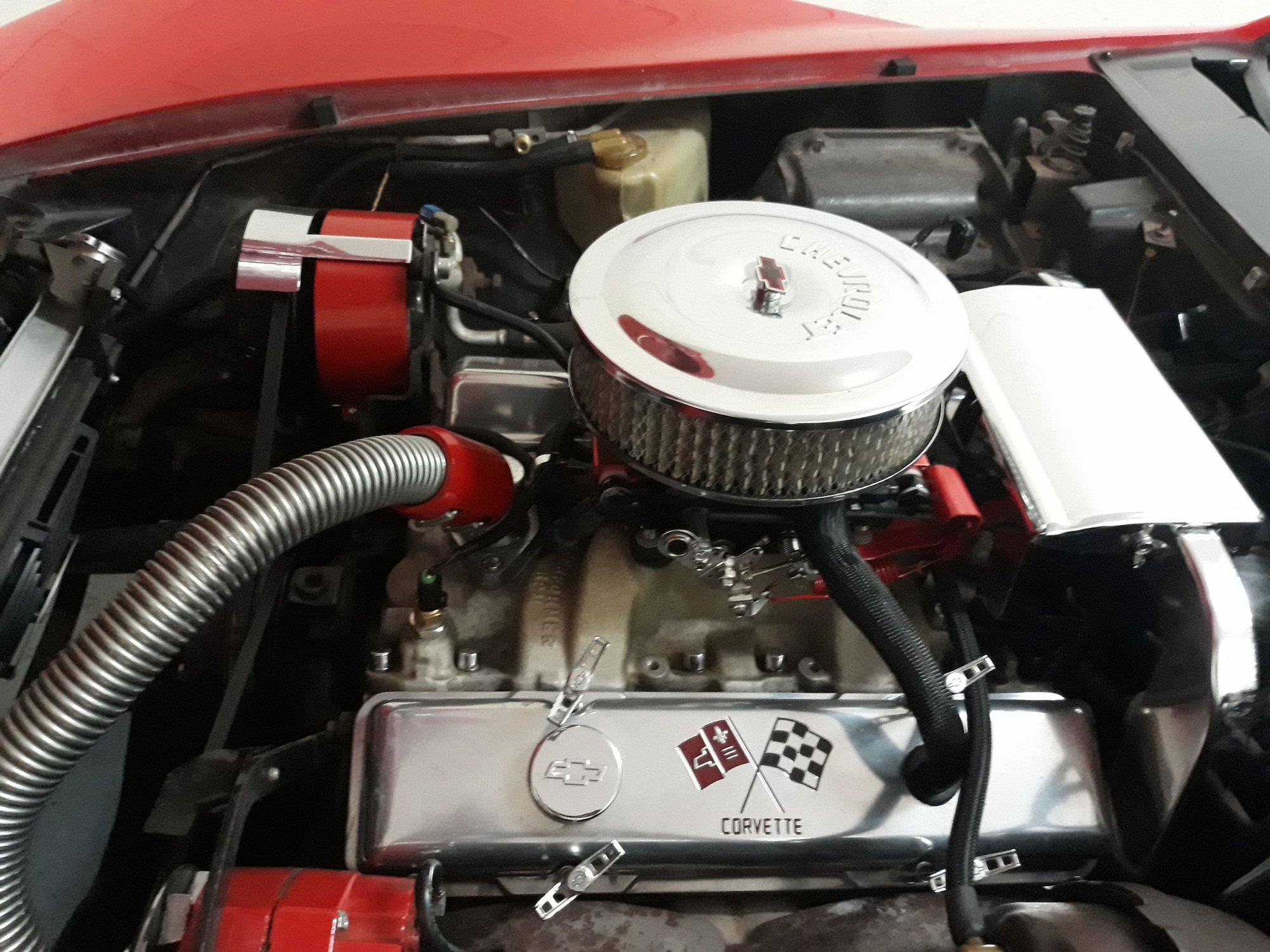

Note my upper rad hose. I've replaced the couplers a couple times over the years. This one has been on the car for well over 20 years.
