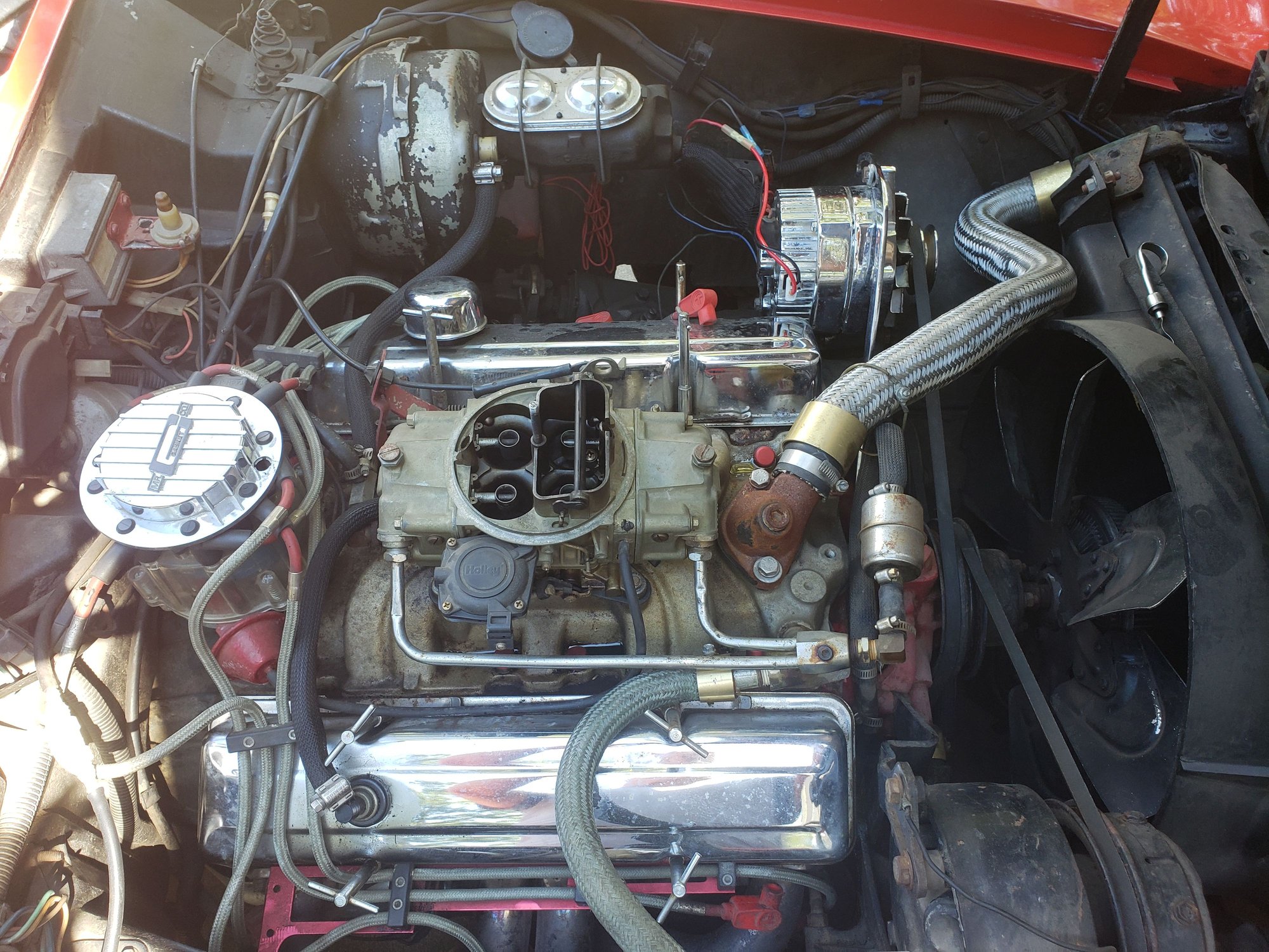

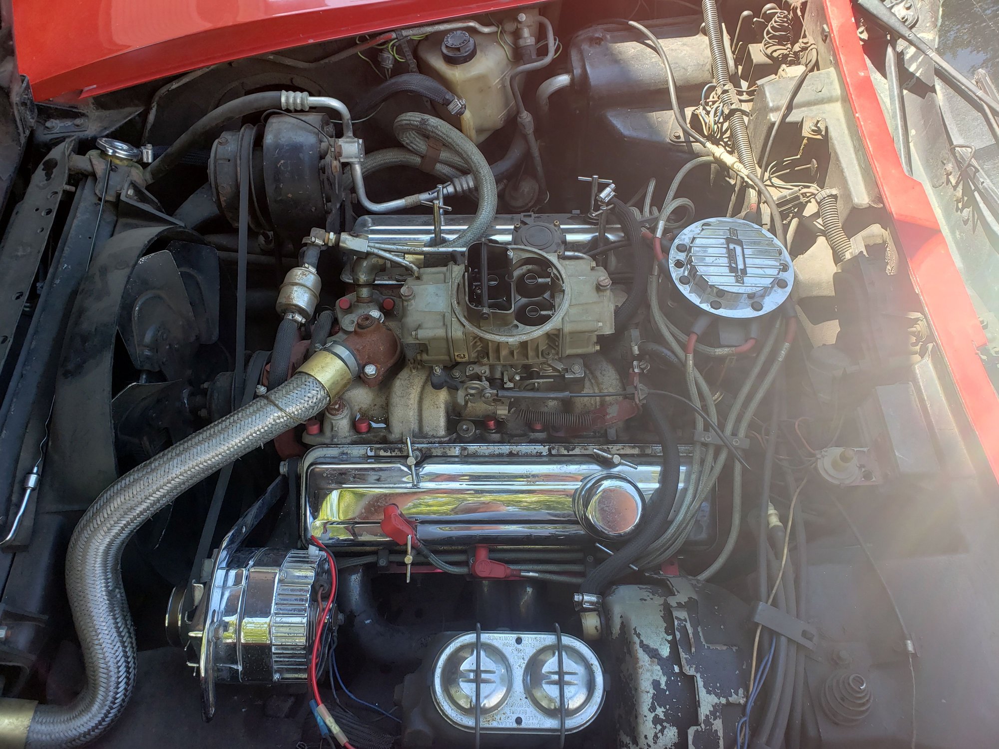

I had a bit of time this morning, and pulled the plugs, got a couple of pictures too. I think I found part of the problem, the plugs on the passenger side front 2 cylinders I spun out with nothing more than my fingers and a socket. The rest look like hell with gaps from .034 to .042. And I'm replacing the fuel line this evening when I reinstall new plugs.
Carburetor photos

Since you are making some changes, move the vacuum line connected to the distributor advance from the ported source on the front metering block to the capped port on the base plate on the front.

The black sooting inside the carb is evidence of some serious timing problems with the engine (running badly retarded). You need to fix the timing - not the carb.(Although I can guarantee that the carb needs work, too, based on the poor setup of the ignition system).
