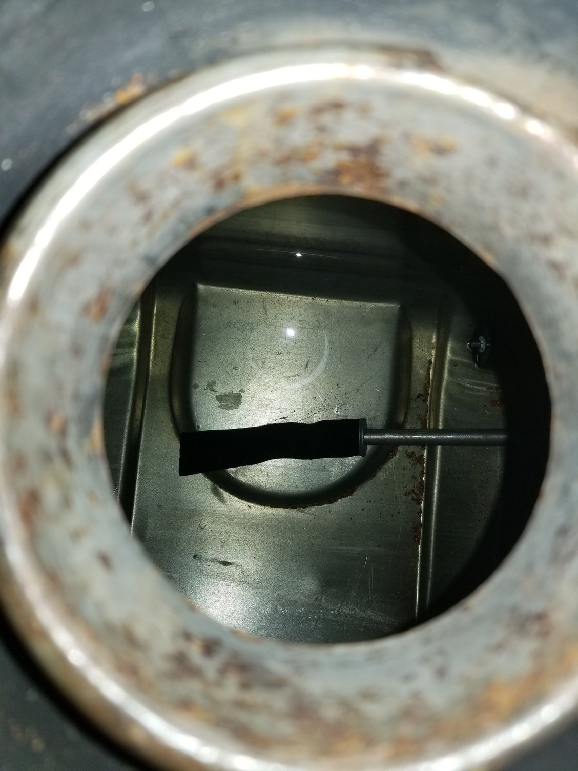

fuel pump is new, fuel regualtor set at 4.5psi, two filters, one after the tank unit and one before the carb. Both are clear and free. Tank was siphoned out. Take a look at rhis sending unti sock. Should it be black? It did have water in the tank before due.to water dripping directly onto the gas cap whe in the sea box. When i first got it i put the line in the bucket and it looked ok. New pump havent done that. Should i video this for you guys?
I think you intended to attach a photo of the sending unit sock, but forgot to. It sounds like there was an issue with water in the fuel, so if that wasn't completely flushed out, and new fuel put in the tank, then that could still be a problem. Did you try pouring a slow, steady stream of fuel into the carb while cranking to see if that helps?
photo attached now. I will give that a whirl and report back!
It's hard to say about the condition of the sock from that picture. As far as I can tell, it's OK. As long as it isn't restricting flow, it's OK.
