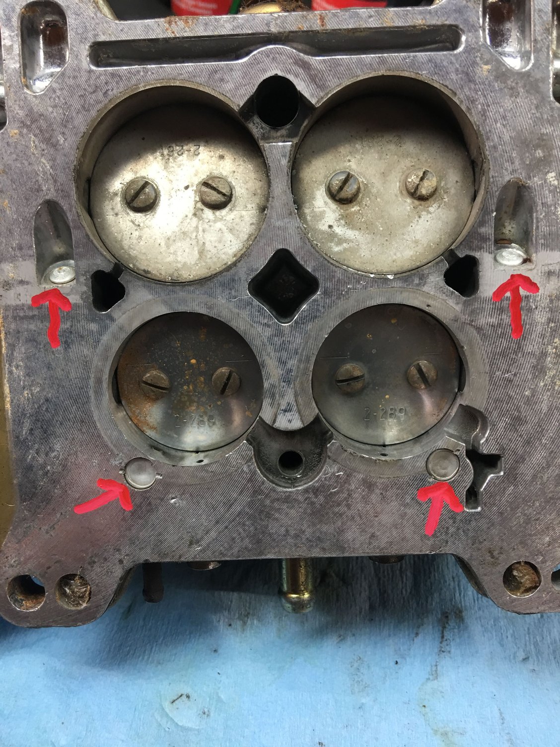

ok i will def check that. Once the engine is shut down on a carbed car does the residual pressure bleed off pretty fast? I have a pinch valve regulator by the car so i know any pressure im seeing is just the pinch valve holding it but i was curious. As of right now shes firing up fine after the timing and choke fixes. Ill wait until tomorrow to see what a cold start is like. As of right now its doing way better than it ever has thanks to you guys. These plugs you speak of...what they be on a carter afb as well? I have one off the car so i figure i can snap a photo of it and you can show me what youre talking about. I DO feel like its flooding but then it acts likes its lean. But this may have all been related to a poorly adjusted and functioning choke.
Yeah it actually is totally flooded, but after starting initially there is nothing in the carb to keep it running until the bowls fill back up.

ok i was about to post a photo of mine as i saw those plugs. So anyway today i started it cold. Filmed it. Im gunna be so annoyed if i dug too deep into this and it was just too much timing and a messed up choke. It lit right off.
